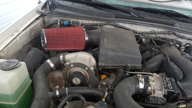

    I prefer hot air as well. I also enjoy filtering my filleted air.

    Thank you. Very much. The knowledge gained has also complemented the elevation in my trouble shooting prowess. Of course, all I do at work all day is troubleshooting as well. Listening to the electromechanical harmony of my machines, to determine what the actual source of the problem is. I honest trouble shoot every day. Crazy when I think about it. Fulfilling though.
    The throw out bearing was the most time consuming aspect of this swap. The recently removed TOB was a static location, but adjustable height, TOB. It required precise placement prior to stabbing the transmission. That was fine. The problem is that the pedal was extremely stiff, and after a period of miles without pedal depression, with would become even harder to depress. Never made sense and was irritating. None of us could figure that out, nor why after sitting over night it would be extremely soft, before starting that process again. Then there was the fact that the shifting was very notchy. As if the clutch weren't completely disengaged. That is whyI was ready to try the updated GM TOB, but knew that a lot of measurements would need to be taken.
    Did you just pull your hose off to one-up my thermal efficiency of air induction? :p

    I am running 35s and have no fender liner so i kept collapsing air filters when it was drawing in snow while driving.

    Makes sense. When mine was rear mounted, and the snorkel was between the bed and the fender, it would collect so much dirt that it would also collapse, over time. Once that happened, by by boost. Ugh.

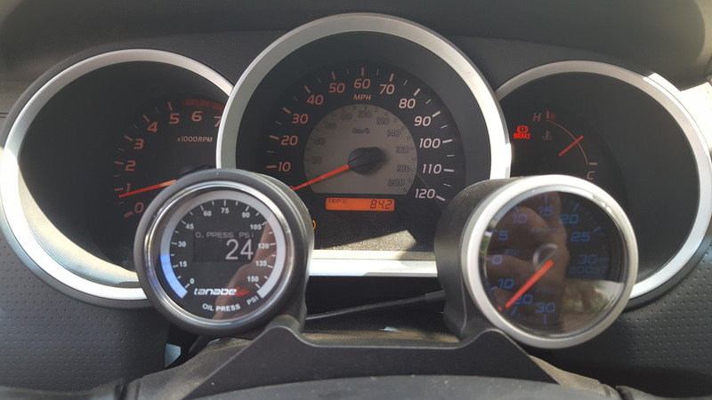

    When it idles down to the 700's, it ever so slightly rocks the truck side to side. A smile then follows. Being as hot as it is right now, the A/C is on, and it stays in the 800's and doesn't rock. Which all means that you are right. It idles low on startup and is quite mild. Has none of the associated rasp which is always had with DTLT's. None.
