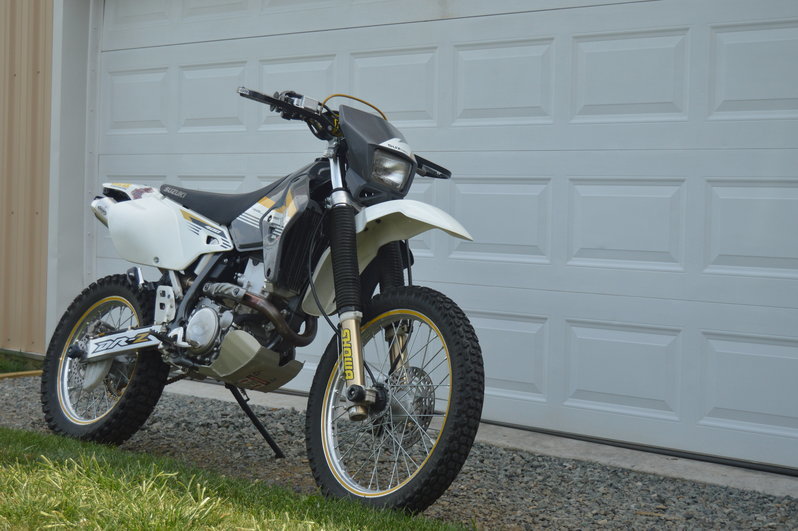

    Do you believe that wrapping them will make them corode faster when exposed to weather?
    I chose not to wrap the header on my motorcycle because i was afraid it would hold dirt and moisture to it and make it corode faster.
    Just my thoughts. But this machine is in dirt and mud on a regular basis, unlike my truck...
    Somedays, i think wrapping the header would look much cooler than that exhaust shield....especially since the brackets for it have broken due to vibration 3 different times in the last 2800 miles

    For mud, yes, if mild anything less than 304 ss. For mudding though, I wouldn't wrap them. Dirt clogging would then destroy the product (wrap) you paid for, come cleaning time.
    I don't go off road, and I don't have any exhaust components of mild steel.

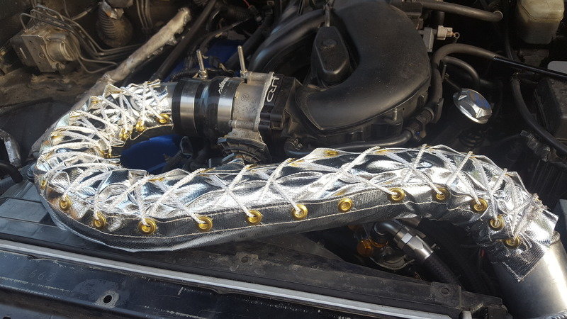

    I JUST finished taping up my intake with fiberglass heat reflective tape. Wish I got one of these instead, looks a lot easier. I don't know what my IAT's were but the last run of the intake pipes that pass next to the turbo were getting baked!
    Going to paint and wrap my downpipe as well.

    Mine was about a 10 minute install, including marking and cutting the hole for the MAF sensor.
    Smart choice with yours as well. It is all about keep the cold where cold belongs, and hot where hot belongs.
