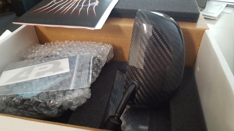

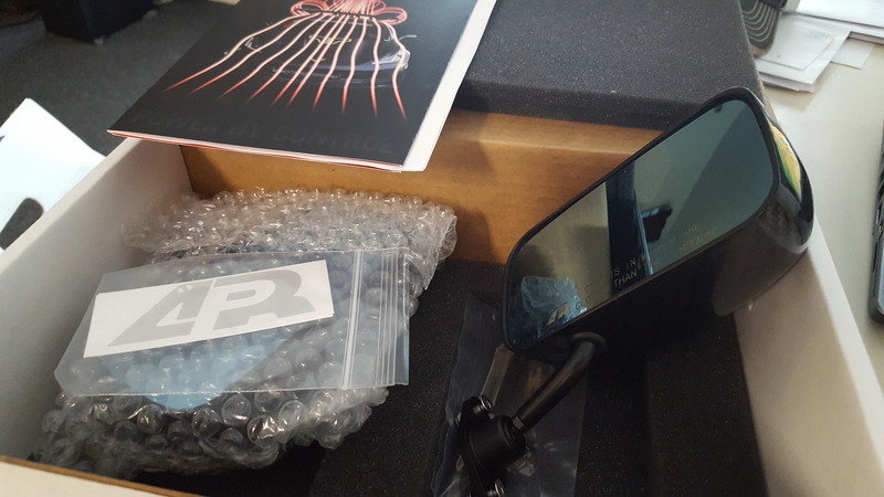

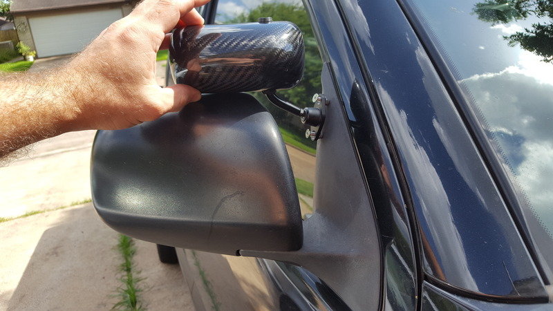

    The mirrors came in yesterday. Let me say, that these things are tiny. Even by hobbit standards. Lol. Not initially noticed until, until compared to the OEM mirrors...They are very nice pieces. Solid, and very light.

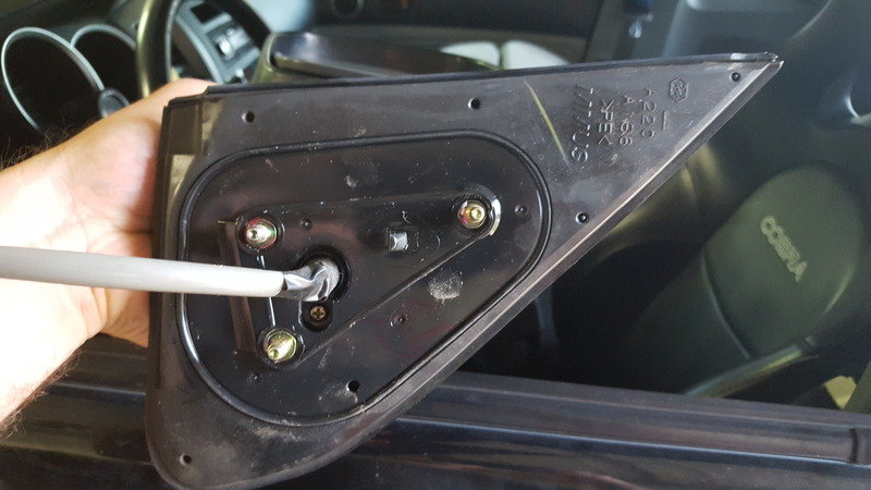

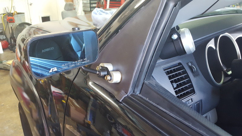

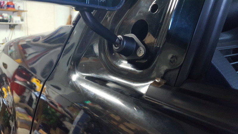

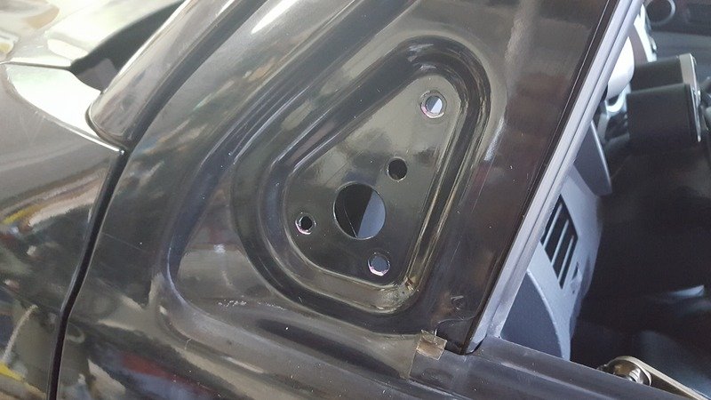

    This rubber piece, which is also a seal, will be re-used. I need to make a template on my sheet of aluminum, and then attache the APR mirror to that, with the rubber underneath.

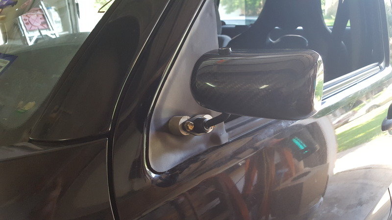

    Out of sheer luck, the mounting bracket's holes line up perfectly with two of the factory hole. A couple stand-offs, between the door and the plate, will properly space out the mirrors.
    Blind spot = gone!

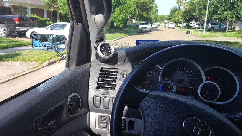

    This will get me by, through track day. Way better being spaced out an inch.
    This is relatively at my head's location.

    After the last two days of freeway driving with the windows down, I can confidently say that the utterly annoying wind pulsations, which reverberate relentlessly against your ear drums, has been drastically reduced. If not almost completely gone. What a relief after 10 years......

    Just changing the mirrors helped that?

    I have yet only swapped the driver side mirror, but yes. It has changed the air flow characteristics enough that I don't have to open the rear window.
