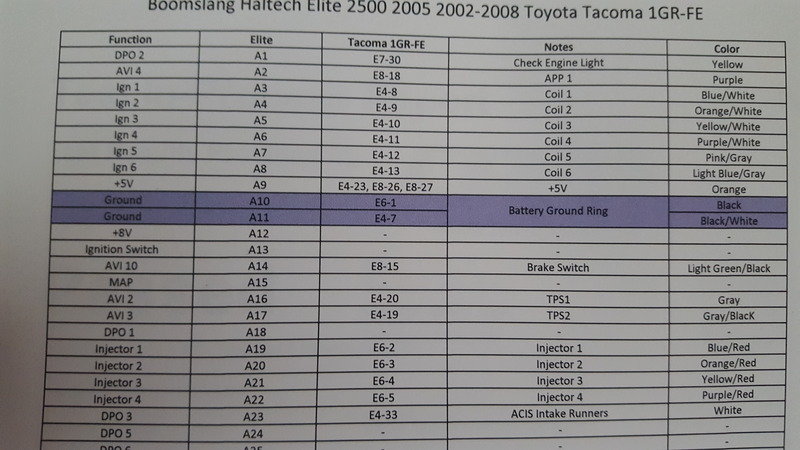

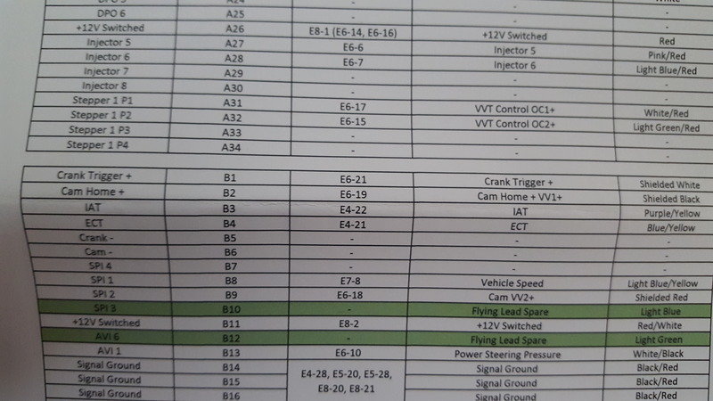

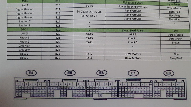

    How about posting a copy if that pin out sheet? :)

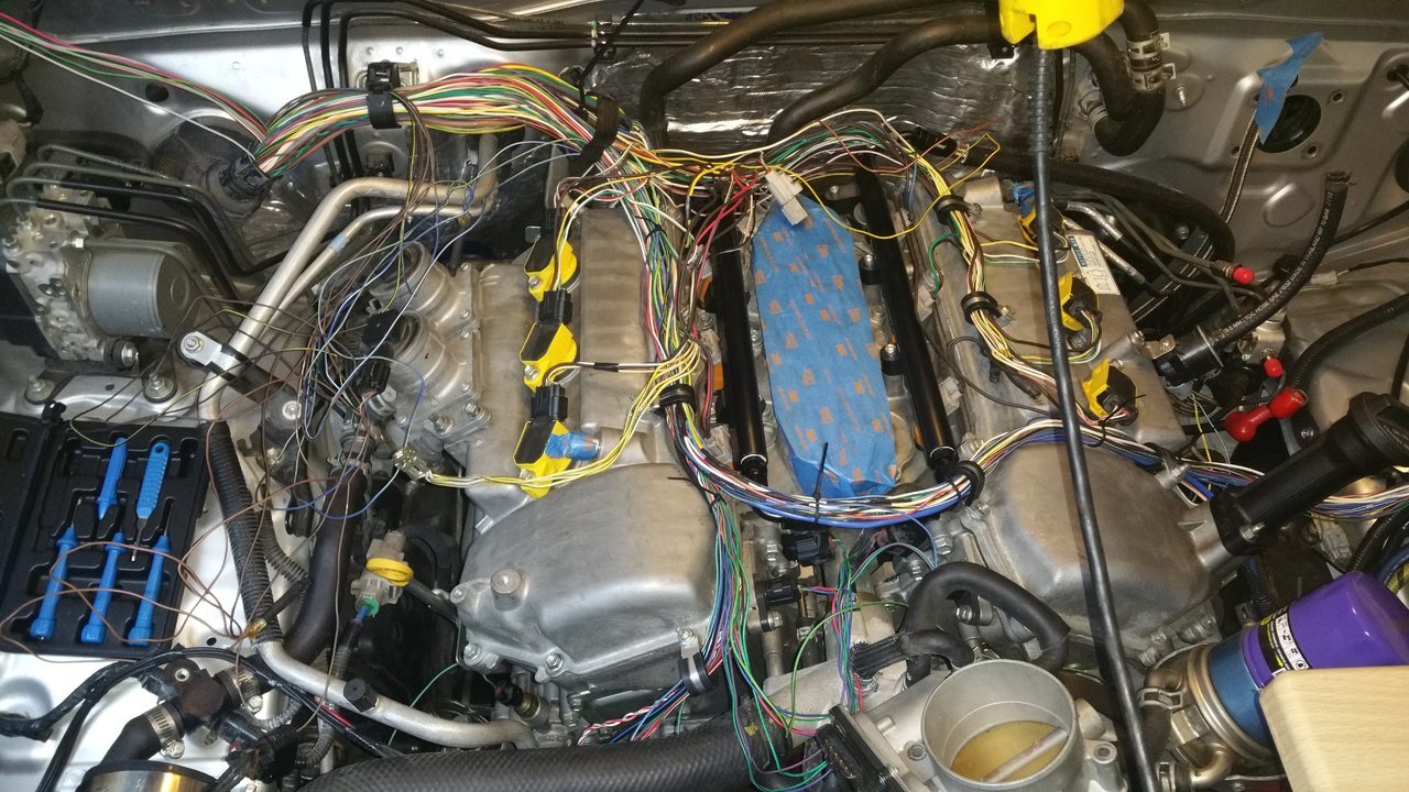

    Oh snap! What have you got going on there?!?!?!

    Re-routing the engine wiring harness to go around the supercharger, instead of under and behind. Mostly to make it possible to mount my FPR directly to the rail, but also to clean it up a bit and make a custom wiring harness for an Elite 2500. I've got a bunch of new connectors, terminals and wires of multiple gauges, just need to finish my original harness to use as a template of sorts. Thanks for the pin out, that will help a bunch.

    Sounds like you are effectively making a plug n play harness as well, yes?

    Hmm, I'll see what I can do about the light. That would drive me nuts. Good to know about the hubs, I'll contact one of the guys on here about some, can I re-use my ARP studs? Would suck to waste those. Not quite plug and play, I haven't tackled the ECU-side yet, might have to repin the connectors if I can't find them. But it will look very clean when I'm done, hoping to look ChaseBay-esque. There are so many other things I want to do while I'm in there, but have to stay focused or it'll never be back on the road.

    What a mess!
