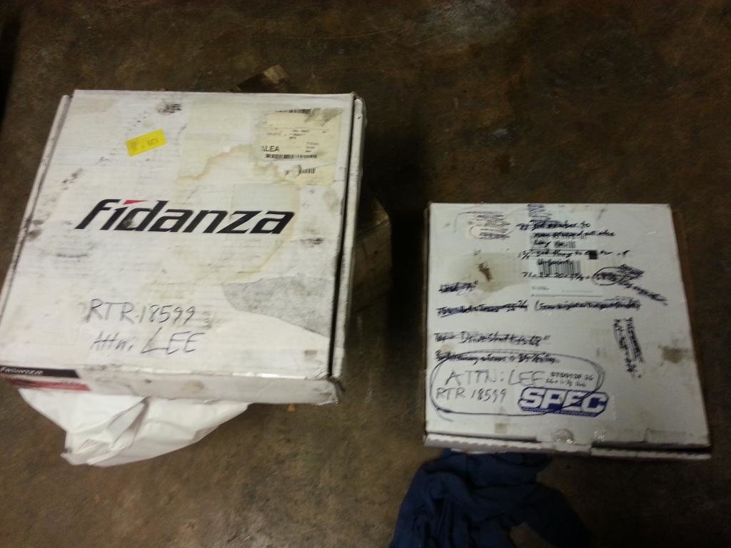

    Also, just a little update. Shipped out my SPEC clutch with pressure-plate, and flywheel out to McLeod Racing yesterday.
    Should be there by Thursday. Then they start the process of putting together a twin disk clutch kit for my truck. The RXT Twin Disk. Rated at 1000 hp. WOOT!!!!

    Being that my ultimate goal is 800 whp 800 + wtq, I need a clutch strong enough to hold that. The RXT twin disk gives me a factor rating over the numbers I am striving for. As well, they maintain a level of drive-ability much nicer than that of a high torque rated single disk clutch.
    Currently my SPEC Stage 3+ clutch is rated to 550 tq. But to get a high rating from SPEC, they don't offer a twin disk for our trucks, they would have to add in what they call super clamp springs and a sintered iron disk. That would make pedal effort extremely hard, and the clutch extremely grabby. Not good at all for a daily driven vehicle.
    The additional surface area, due to two disks, increases the torque capacity. Thus keeping pedal effort much easier for the amount of torque capacity capable. Double win.
    As a side note, Gadget at URD is also bringing to market a twin disk clutch setup for the Tacoma. Rated for 800 and 1000 as well. Not sure when his will be released, but it shouldn't to much longer. He has been testing them for quite a while now.

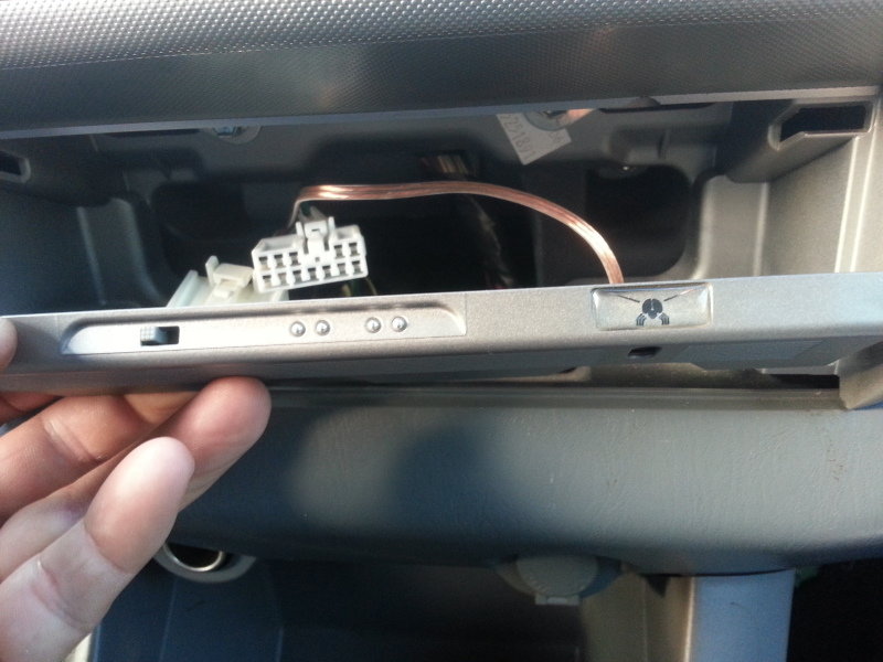

    Torspd Custom Turbo kit [] Borg Warner 9180EFR Turbo [] Haltech Elite 2500 [] TiAL Q BOV [] TiAL V44 Wastegate @ 15psi [] CP Pistons [] CP Carrillo Rods [] ARP Head studs [] ARP Main Studs [] ARP Header - Head Studs [] Ported Heads w/ 1mm oversized valves intake/exhaust [] Brian Crower Forged Stroker Crank [] Darton M.I.D. Sleeved Block [] Kelford Camshafts [] Torspd 160* T-stat mod [] APR Large Fuel Rail [] Walbro 460 LPH E85 Fuel Pump [] FueLab FPR [] APR T56 Conversion Kit [] KP RACING Built T56 [] McLeod Racing Custom Twin Disk Clutch [] One Piece Aluminum Driveshaft [] MGW Shifter [] Custom lowering kit [] Ohlins Front Coilovers [] QA1rear shocks [] Custom Ron Davis Radiator [] Dual SPAL Electric Fans []
    Here is a teaser of something really cool which my friend made and added to his truck. :spy:
    He wanted to get that installed prior to going to MSR, this past weekend.
    Something for you Homer.
    Here is my Flyeyez LED stip which was installed last weeks. Lucario Runner won it at a meet of ours, but it doesn't work on his, so he gave to to me.
    Blends in very nicely, and has battery back-up. Sweet product.

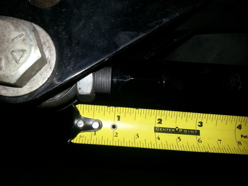

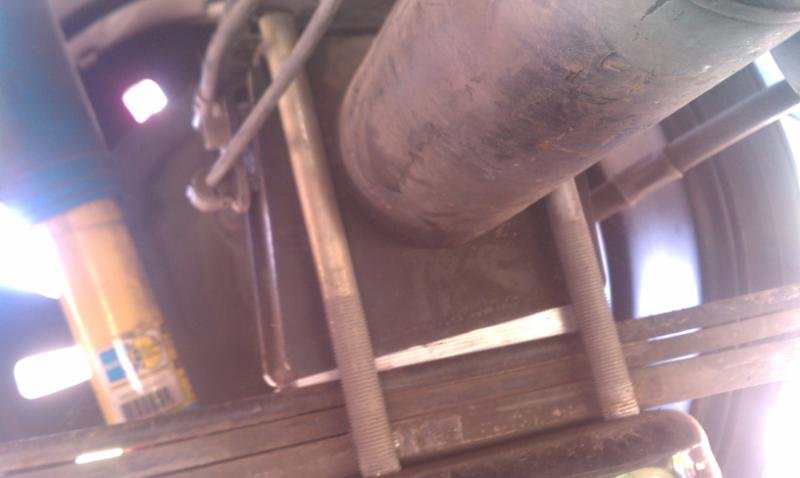

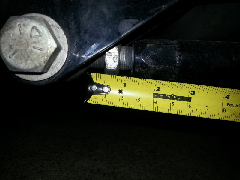

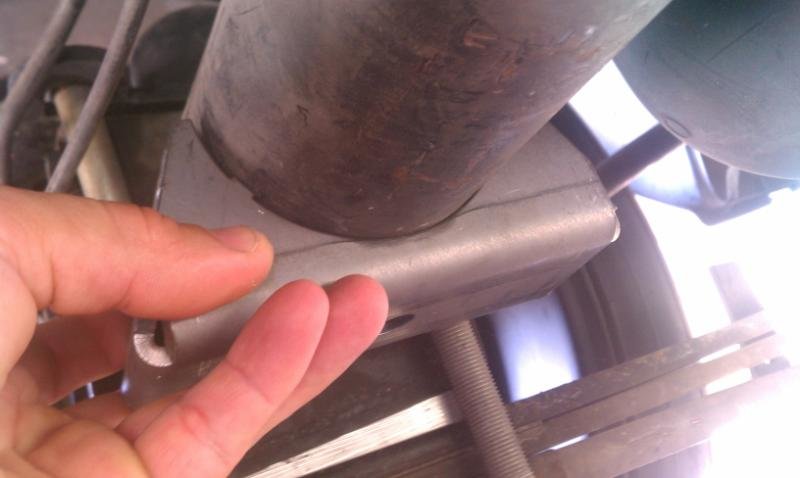

    With the new style drop that I have in the rear, added with the two hole pivot from Caltrac, my traction bars were just to short. The ends were only getting about a quarter inch of tread in them. So I had to upgrade from the 24" trac bar to the 25".
    Also, here is a refresher of how my rear setup used to be. With the square U-bolts.
    This
    To this
    That wasn't safe any longer, as the square U-bolts had nothing to hold onto really. So a friend of mine, Grumpy, ended up having a spare set of XR 3.25" round U-bolts. I will have to get some pictures of that tonight.
