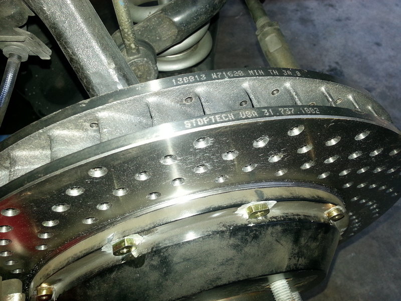

    I ordered my 6 piston kit from them, some years ago. Rotora 6 piston BBK. Was ~$2500. Now they have the StopTech ST60 BBK. They make the adapter for the Tacoma. If i could have purchased that kist instead of the Rotora one, I would have. Easier to upgrade and repair, large pad aftermarket, and just a better product.
    Started that change by swapping to StopTech rotors, adapted to Rotora hats. They last MUCH longer. Also I have not had one issue of expansion slots getting out of round like they did on the Rotora rotors. Just better material for the rotors. At $750 for a pair of rotors, they had better be a quality product. Again, just the rotors and not the hats.
    The same dimension rotors from Rotora are also within $100 more than the StopTech rotors.

    Mine might have been a rare case. Since I purchased mine, the company has made some improvements at their factor, so I heard. Only needed that to happen once though.
    Mine are 355mm x 32mm. Part number for reference, on the circumference of the rotor.
