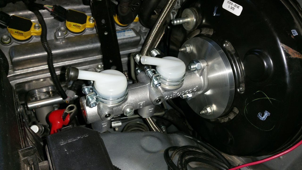

    I used this MC http://www.wilwood.com/MasterCylinders/MasterCylinderList.aspx?group=Tandem Remote Master Cylinder, and have this proportioning valve on the rear line http://www.wilwood.com/MasterCylinders/MasterCylinderProd.aspx?itemno=260-10922.
    The adapter was made out of 3/8" thick 5" round aluminum I bought on eBay. The holes to mount to the booster are 35* off the vertical center line (roughly 10 and 4 o'clock) and are 100mm apart center to center, the holes that the studs were pressed in are 1.125" from the center point of the aluminum along the vertical center line of the piece (this depends on your MC). I counter-sunk the stud holes so that the plate would sit flush. The big hole in the middle is snug, but I put silicone around the base of the MC to make sure it maintains vacuum, I also put a thin line of silicone on the plate between it and the booster.
    I replaced the push rod in the brake booster with M6x1.0 threaded rod cut down to size with an M6 acorn nut on the end.

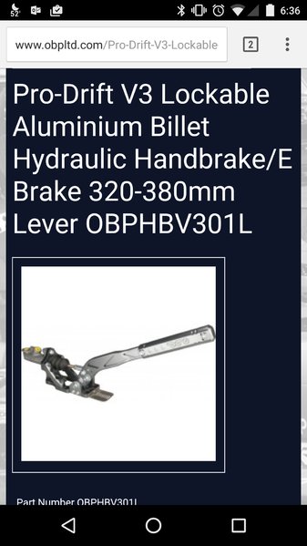

    Just been following this thread for years, didn't know if you guys had seen this company's products. They make some standalone brake, clutch, throttle pedals with master cylinders. Pretty cool stuff, check it out.
    http://www.obpltd.com/

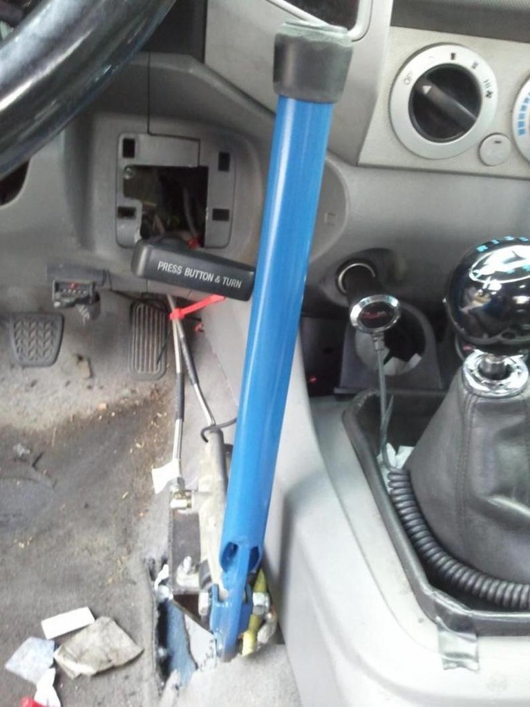

    Like this one??? Tacoma Drift E-brake.
