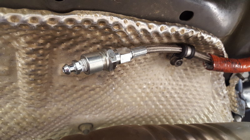

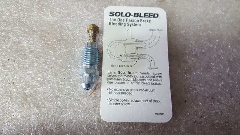

    Since I had to reinstall my clutch recently, due to one or both of the head gaskets going out, on the old faithful Subi, added in a clutch line "break point." I used to have to remove the whole clutch line and re-route it every time the transmission came out.
    All in the aims of making my life easier, and a quicker job with the trans. Along with that "break point," I added in the nifty little fitting to help make the bleeding job effortless. Man, I tell you, it was worth the $20 for the two Earl's Solo-Bleed fittings.
    For that line, the Solo bleeder has to be installed into that hard fitting. Otherwise the swivel hose end will allow air intrusion. My fitting is a -3AN, or 3/8" x 24. They have metric as well, if anyone wanted them for their clutch or brake line.
    You can modulate the pedal pressure nice and slowly to prevent all of the tiny bubbles from forming. Just loosen the fitting a little, and slowly press the pedal. Watch as all of the air comes out. Super easy.
