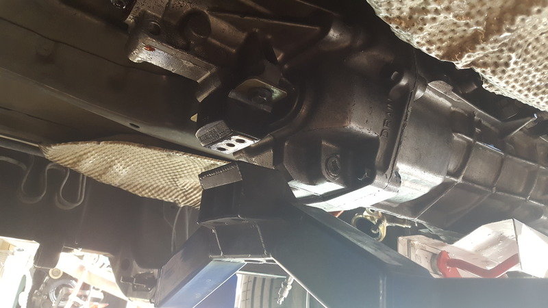

    @Bonzen , they are in. :thumbsup:
    From this,
    To this,
    BassAckwards, Crom, Bonzen and 2 others like this.

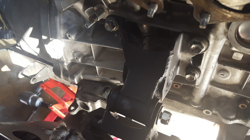

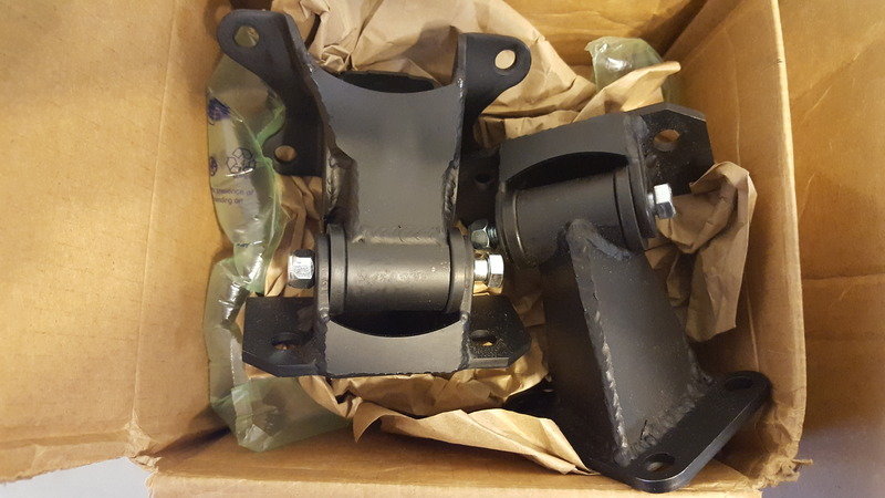

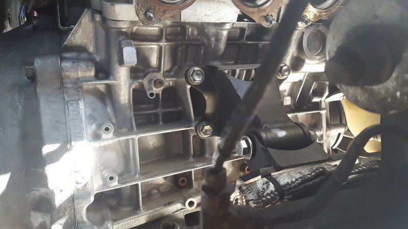

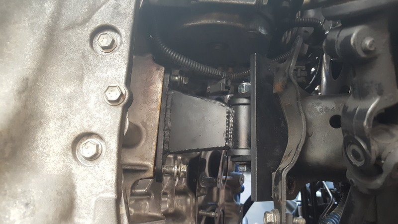

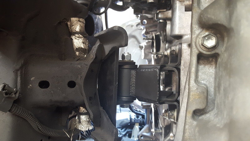

    @HomerTaco . What made it much easy for me, was removing the headers, y-pipe, and starter.
    Disconnected the transmission from the cross member. Un-bolted the frame to engine mount bolts, used a transmission jack to raise the engine and trans simultaneously. Then un-bolted the mount to block.

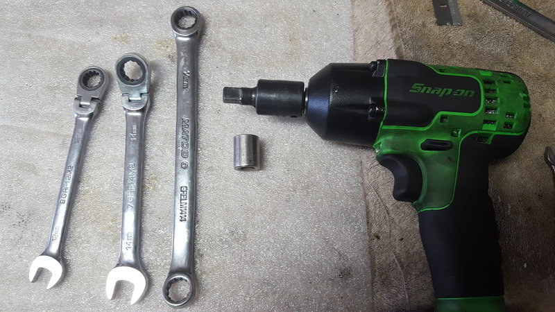

    The new mounts are more stream lined in design, and easier to fit tools between. Major plus. Here are the tools to make my life easy.
    Total swap was about 2 hours. Doesnt include re-installing the exhaust, since I had to pull the clutch. Which was an additional hour. Not to bad a job, with those parts remove. Ratchet wrenches are a must though. ***** One other note! I added shorter bolts, from the frame to mount. As the original would create a tool interference issue, with the through bolts.*****

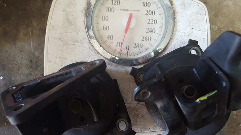

    As for weight, the new solid mounts were 8 pounds combined.
    Whereas the OEM are 12 pounds, as shown below.
