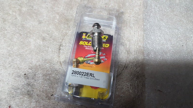

    Posted this picture in another thread. Just received these for my rear disk conversion calipers. After the one for my clutch line made me enjoy bleeding the clutch, due to the ease of the job, I couldn't pass them up for the calipers.

    I've got the lower tech version of those (speedbleeders) on my truck calipers. they are lifechanging!
    think they make it in an M12? :rofl:

    I actually was looking for you, after seeing your issue in your other build. No luck on Summit's site. :(
    I need to get two more pair for the front, since there are 4 up there. That will really help!

    2 bleed screws per caliper? That will certainly help. That's almost a 3 man job at that point without them

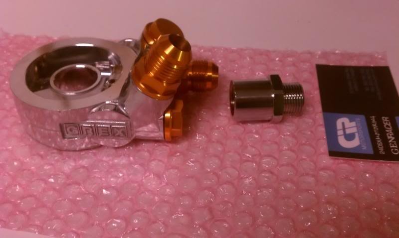

    Will be boosting via s/c in the next couple months, and prior to boosting I'd like the piece of mind to monitor my engine vitals. Looking for info. on how to get this done. Oil pressure, oil temp, coolant temp., fuel pressure. Already selected AEM wideband, and boost gauge. Any info. or direction is much appreciated.

    I wouldn't get a fuel pressure. You'll be able to know something is wrong based off of the wideband. I rocked oil pressure, oil temp, coolant temp on my old car.

    For the oil pressure and temp, if you aren't making an oil cooler kit, then there are sandwich plates available. Simply for sensors. Which would accomodate both oil needs.
    As for coolant, I use my scangauge. It is handier because of the multipe gauges. Displaying Ignition timing, Inlet Air Temps (IAT's), Throttle position, and whatever else, to diagnose or monitor.
    As far as fuel pressure, if you do the pump upgrade, the easiest gauge would be the fuel rail adapter and a mechanical gauge which goes into it. URD sells that adapter. It will be handy in the event that the fuel line splits for some odd reason.

    After reading through your build early on, I saw that you used a Greddy sandwich plate after your ground off some of the oil splash guard. Are those still around? Any recommendations on a plate? I'm assuming you can use the plate to also create lines for oil cooler?
    Later on, I saw that you used an existing hole under the oil filter area and placed and NPT to AN adapter. How'd that work out for you?
