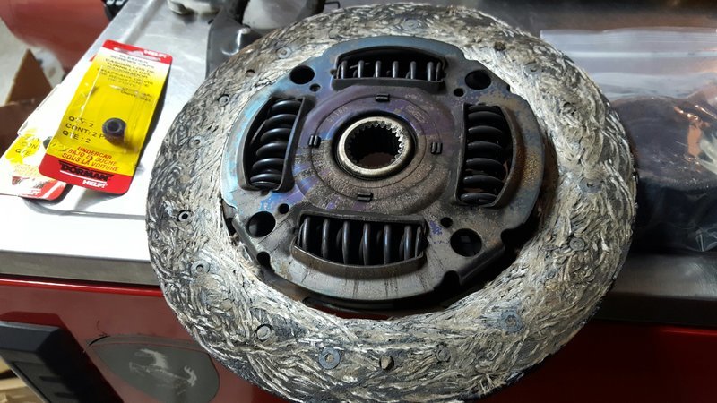

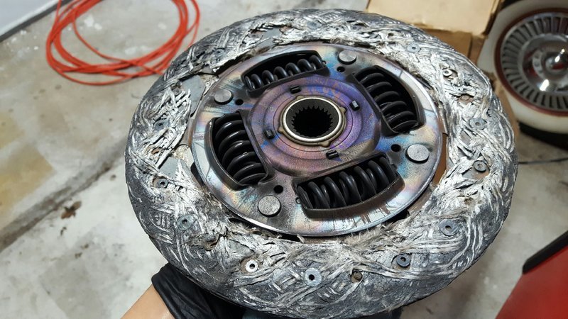

    Here is an Excedy OEM replacement cluch from a BRZ. Different vehicle, yes. Inspect how it handled abuse and which area failed. Even the discoloration of the hub from heat saturation. Still stayed together.
    At minimum, Excedy is the the most cost effective best upgrade over stock, for OEM equivalent replacement, for the 1GR. Take not of the full dampening springs.
    The OEM clutch has plastic bushings between the ends of the springs and the hub. If one of those break, it is catastrophic failure to follow.

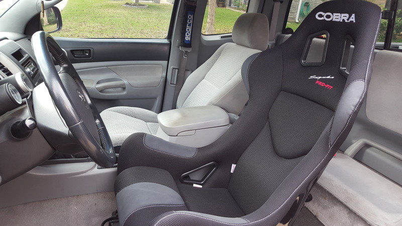

    Fail! Does not match the passenger seat.
    :D:D:D

    I thought you already had an aftermarket drivers seat? :confused:

    This one is the new passenger seat. Pending the arrival of a seat slider.

    Airbags and airbag light, did you somehow remove them or figure out a way to keep the light from going on? Looks so much more comfy!
