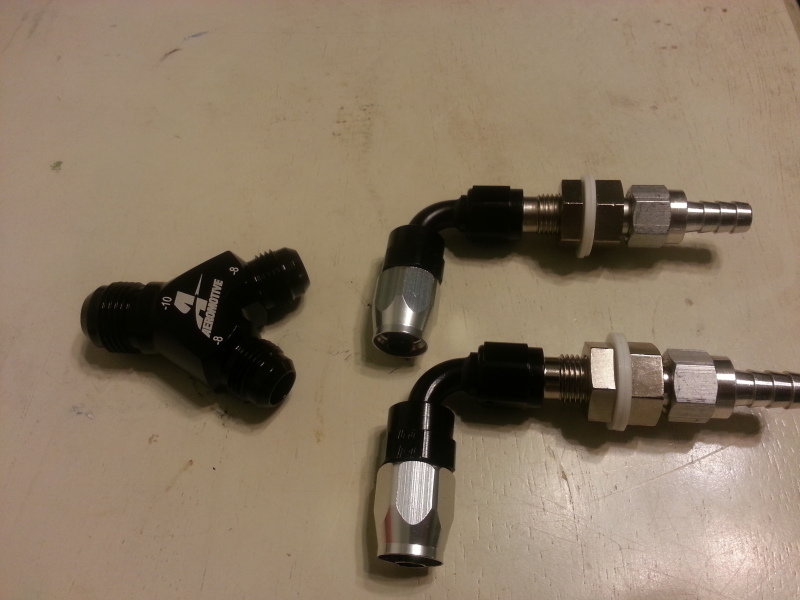

    A few more fittings that have recently come in. The two identical ones are to make the feed and return lines -6AN. As well as being able to have all AN fittings. Which makes adapting those to my other upgraded fuel line components.
    The Y fitting is to split the feed line to each side of the fuel rail. Prior to returning to the FPR, then back to the gas tank.

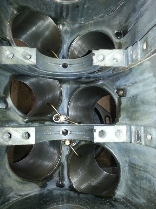

    And here is the latest from the spare engine. Installed the oil squirters.

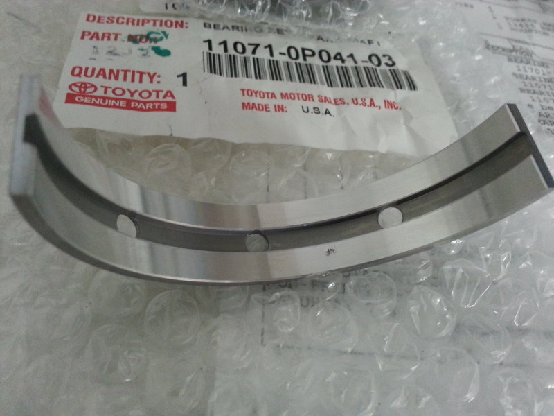

    Then went on to clean/ inspect bearings for the crank so that I could inspect the crank. Found this on the #3 journal bearing. :/
    Had a small gouge in it. Right out of the package.
    So I couldn't complete the crank install. Or the rest of the rotating assembly. Toyota ordered me a new one at no charge, thankfully.
    But once the rotating assembly is installed, I still won't be able to completely assemble the block, until the Cometic head gaskets and ARP studs arrive. Should be another week or so on those.
