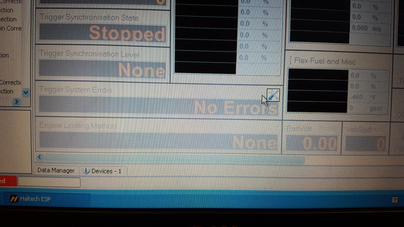

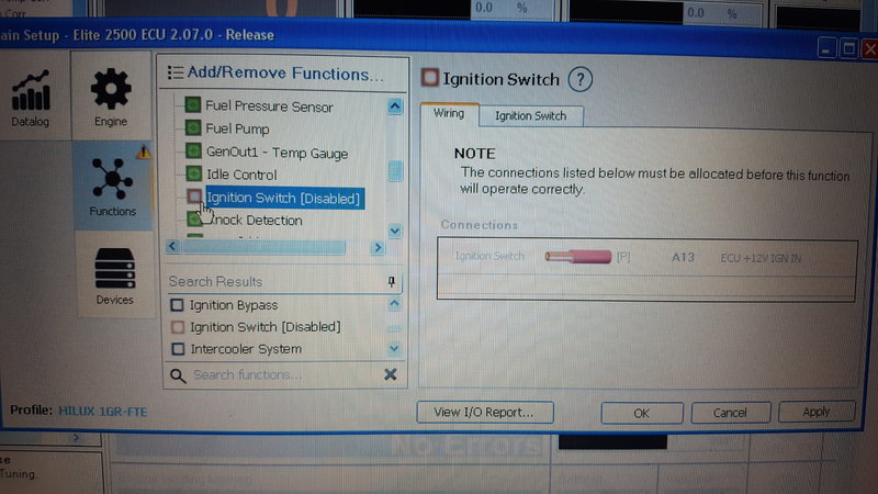

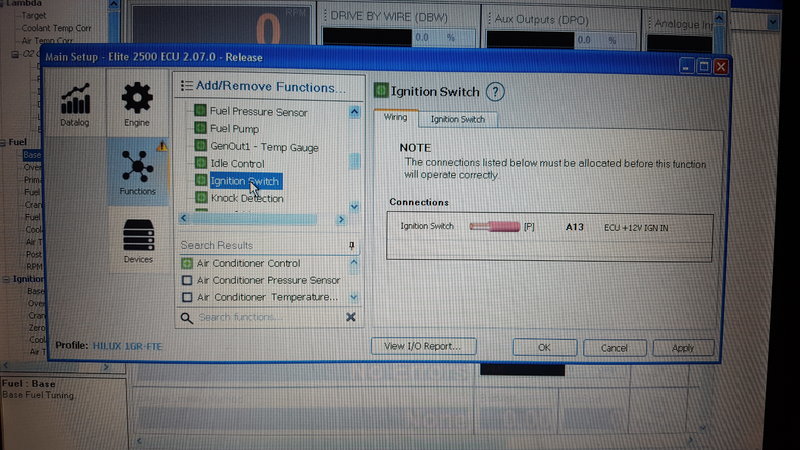

    I was about at wits end last night, trying to figure out why I could not get an ignition signal, while cranking, with the Elite 2500. I've been working with it for an hour here, an hour there, over the past month. Couldn't make any noticeable progress. Took the volt-ohm meter home yesterday to ring out the Boomslang harness.
    Everything ohm'd out properly. Scratched that off of the check list. I was about to package the unit up to have it sent it, then I decided to see what time it was in Australia.
    Being 1:45PM over there, I figured I'd reach out to our friends across the pond, in Australia. The engineer remote accessed my laptop, and was able to help me get the engine started.
    I owe a great deal of gratitude to Mitch from Haltech Headquarters. My map was nearly complete. He did a few tweaks, politely enlightened me to my naiveté interpreting what the ecu was trying to inform me of, and found a few functions which were pre-assigned and "ON", which I wasn't actually using. Thus prohibiting the truck from starting.
    Key on, he asked me to start the engine, and it fired up and purred. Ensue Manly tears of joy. Lol. It was very exciting. Thank you very much again, Mitch. :bowdown:

    Here is an example, from a similar file. Where the cursor is, in the box Trigger System Errors, Fuel & Ignition were occupying that space. So when I saw that continuously, I thought, "yup, I need those. Must be normal."
    After he noticed that, we pulled up the Main Settings page, and looked at the Ignition switch. My Boomslang harness is setup in parallel. Thus the OEM ecu controls the ignition. Not the Haltech. That switch comes preloaded as on, or was on. Either way, we turned it off. As well as other functions which were on, but I hadn't allocated wires to. Since the boomslang pinout had not had those allocated.
