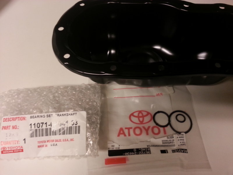

    Almost had the crank and rotating assembly installed on my spare block. As I had just received the new bearing from Toyota, since the last #3 main bearing had a nick in it.
    Well when I went to pull the crank from sitting in the block, to install the new #3 main bearing, the #4 main bearing stayed stuck to the journal of the crank due to the assembly lube. Then it let go as I was moving the crank out of the block. It fell on the ground and then it was damaged....So I had to order another #4 main bearing. :/

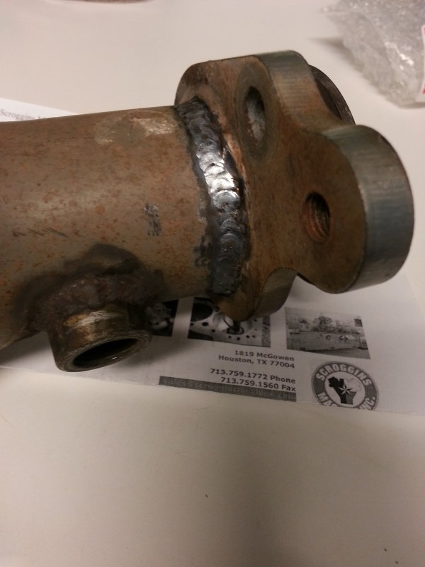

    Such as picking up my repaired Gen 1 header.
    This is actually the second time that I have had this one repaired. The weld is where the most recent crack was. Thank you SIK X. The first time it was repaired, it was because the #6 cylinder's primary was cracked all the way around. That would be the cylinder closest to the fire-wall on the driver side.

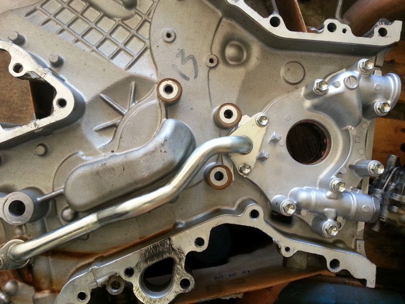

    This timing cover came with the first engine that I built. But it had the oil pump cover broken in transportation. So I just recently ordered a new cover to install, as well as cleaned off the old silicone around the edges. So that it may be ready for final assembly.
    This timing cover is clearly not as nasty as the one that came with this spare engine. That made it the obvious choice to install.
    Along with that, a new lower oil pan. The other one was far to filthy with caked on oil as well, and timing metal shavings from the spun bearing. That was just best to throw away.

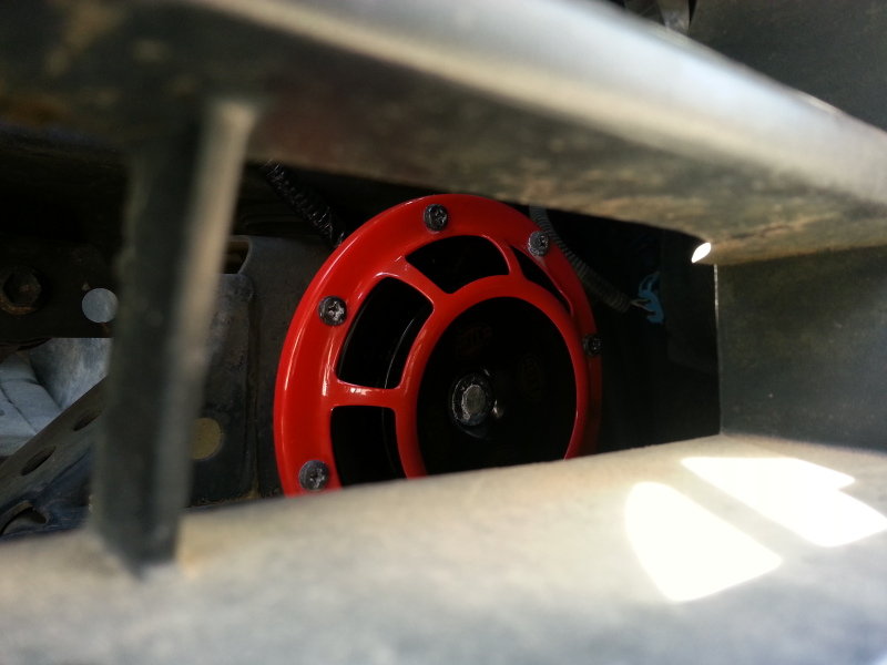

    And lastly, my new Hella Horns. Installed and wired up. WOOT. Had them since Christmas and just finally got around to wiring them up.

    How do the hellas sound? I bought my Tacoma with some already installed, and while they are kind of loud, they sound like they belong on a mini van or economy car or something...

    They sound pretty good to me. Different than the factory ones. But it has been so long that I have heard the factory ones, I really don't remember how those sound. Lol
    For these however, it was more of an aesthetic balance. Ever since I installed the intercooler, the factory ones were in two different locations and were really out of place. I just didn't like that. So now, I have these Hellas installed on either side of the aluminum bumper. Pretty much out of sight if looking for them. But they are symmetrical with a tad more kick.
