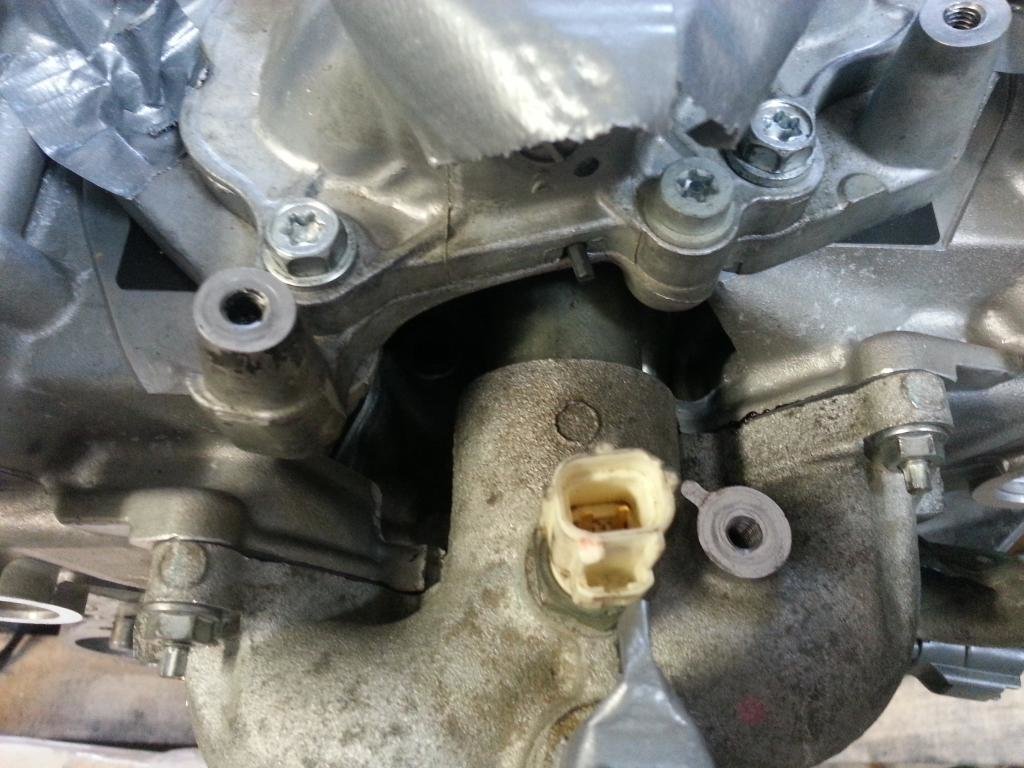

    First the confusing. Not sure why, but the OEM coolant temp sensor does not scale properly with temperature increases, while wired in parallel to be used for the Haltech. "In parallel" since the jumper harness, uses an input for the sensor, off of the factory wiring. Might be cause a resistance change, since in parallel, but I don't know for certain.
    Since I already had a GM 3/8" NPT fitting installed in the rear crossover, underneath the OEM sensor's location, I plugged in the wire harness for it, and tapped it into the input which was originally for the OEM coolant sensor - Haltech. Loaded the pre-saved sensor map, in the Haltech files, and "a monkey's your uncle." Lol. Worked perfectly, and the OEM sensor reads as well, since not being used.

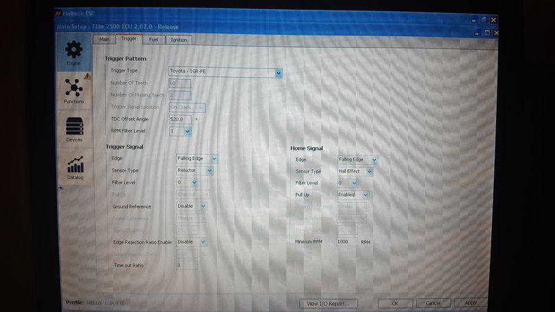

    @Lucario Runner with laptop at the ready, we verified the TDC Offset angle. Originally after the remote tuning session, it was set to 515 degrees. To zero it out, it needed to be adjusted to 525 degrees, for my engine.
    Once that was done, and the wideband sensors installed, it was off to idle and low speed cruising fuel adjustments. My God do we enjoy the intuitive and simple layout of the program. So easy to navigate, and modify. It drives very smooth. Smoother than on the OEM. Unbelievable.

    Here is the OEM coolant sensor, in the crossover. Unfortunately I have no picture of the GM sensor, on its underside.
