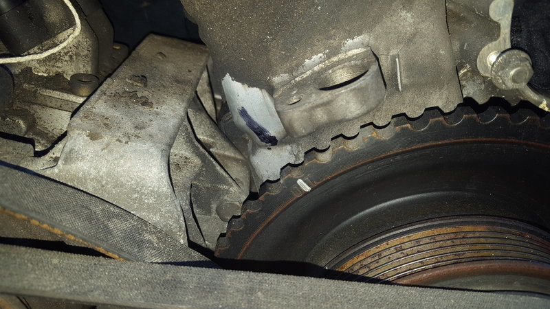

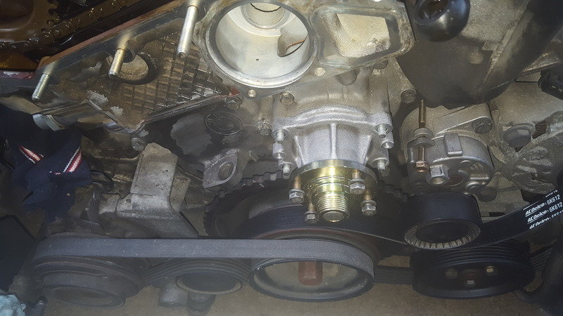

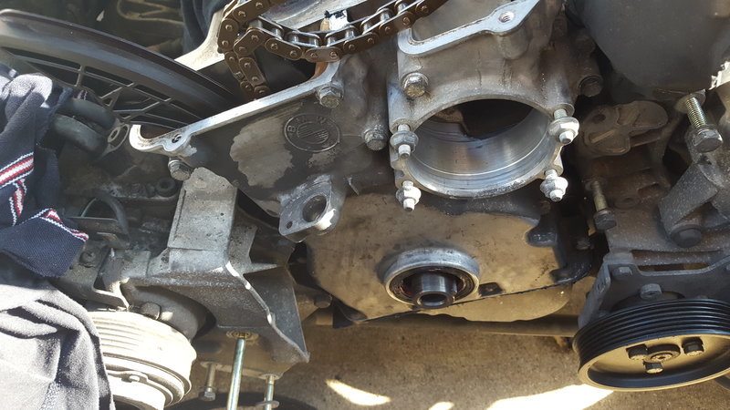

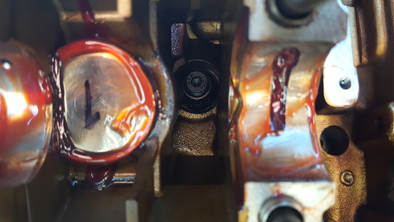

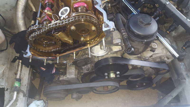

    Marked the crank pulley, prior to removal of the timing cover. Needed to replace some gaskets, and get to the oil pump nut.

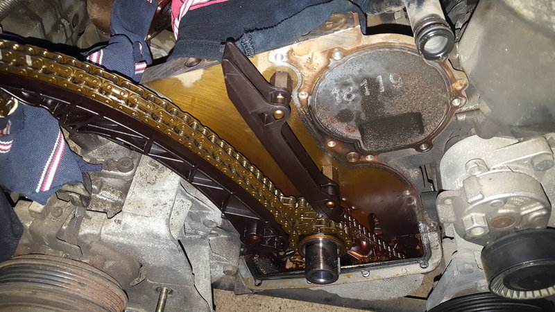

    You can see the smaller chain which goes into the oil pan. The nut for that gear, is notorious for backing off. Manufacturers make a nut with a hole through it, and a wire tie.
    Well....I am in no mood to remove the oil pan. Screw that. Backed the nut off as much as safely possible. Used long picks, and pressed this Loctite into the thread. Ran it on and off, added more, then locked it down. @Lucario Runner knows how strong this stuff is. As well as being 650ºF rated.

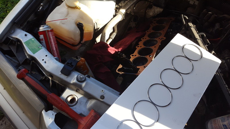

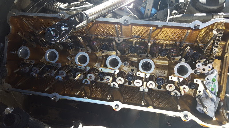

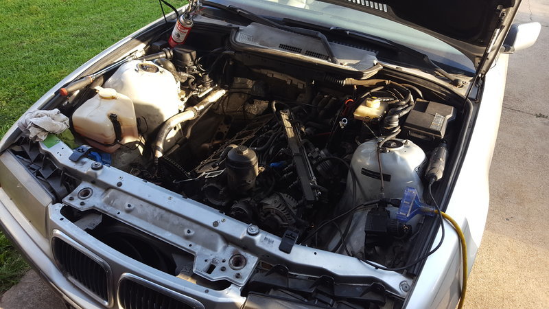

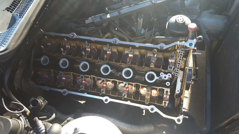

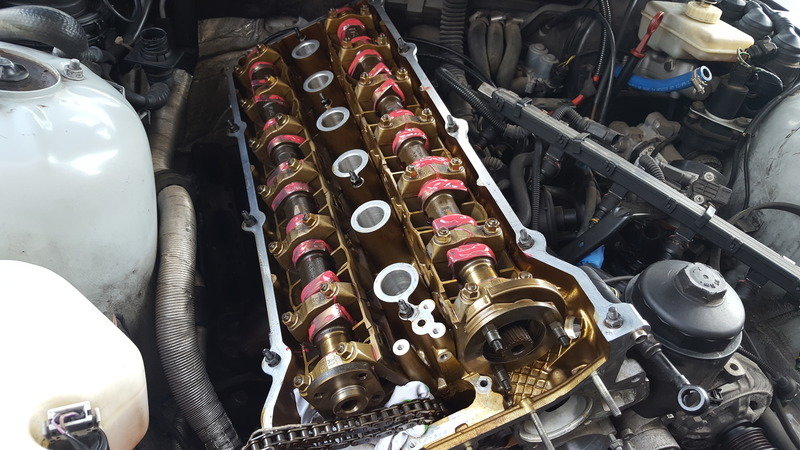

    Last few pics until the new valve spring retainers arrive tomorrow.
    Going to be Maaaaaaaaaaaaaaaad!!!!20170328_172553.jpg 20170328_172706.jpg 20170328_182848.jpg 20170328_181344.jpg

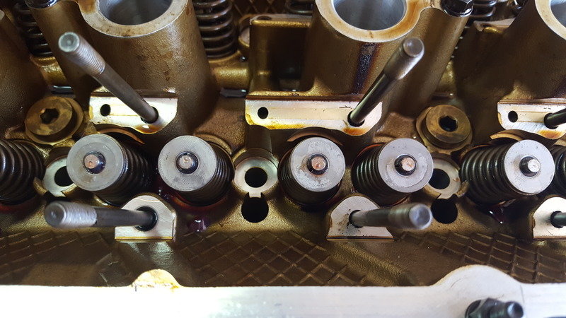

    The old cracked retainers.
    New ones assembled to the head.

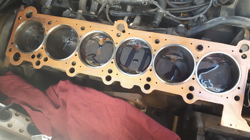

    Now this was quite interesting. The JE ProSeal head gasket.
    Ran some thick oil into the cyliders, and wiped it around the walls. Dabbed it out afterwards.
    Head being torqued down, with ARP head studs.

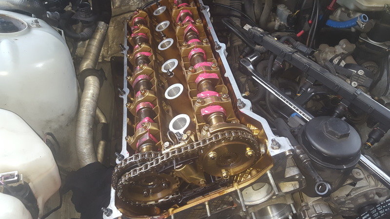

    Cam trays installed, with a nifty trick to prevent the hydraulic lifters from falling out. Used a long piece of painters tape across the bottom. Then slid it out when everything was close. Voila!
    And we wait for tomorrow to wrench some more on this M52. Nearly complete. :woot:

    Bimmer is a few short components shy of being done. Starting to feel like Torspd is synonymous with head gaskets..... lol.

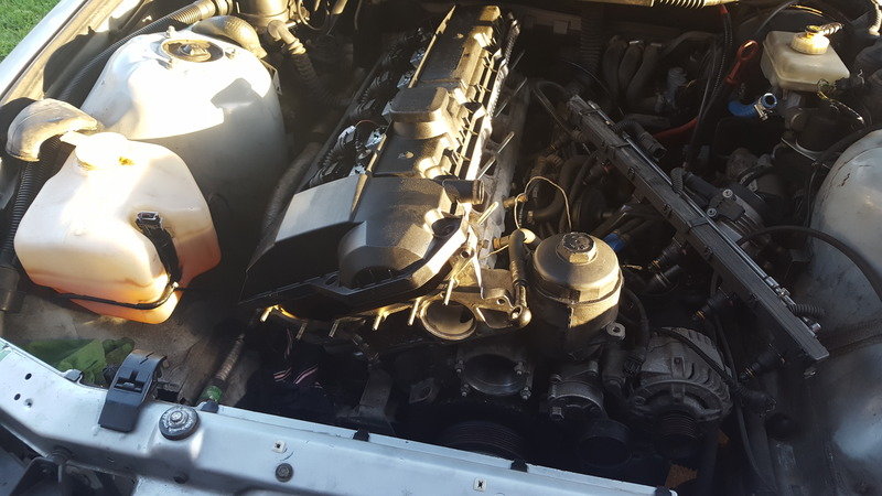

    On that note, didn't take any time to snag any more pictures. Was in the home stretch last night. Took about 6.5 hours to finish up. Took forever to burp the coolant system. Not a fan at all of how that system is setup.
    Cranked it for a while to prime the fresh oil, before re-inserting the fuel pump fuse.
    It had an 1/8 a tank of old gas in it. About two years old. I added a gallon of fresh fuel, with a bottle of VP Racing fuel system cleaner & Redline Oil S1 fuel system cleaner to the tank. Just to get it to idle, and get me to the gas station.
    Idled well, with no CEL's, but was a bit noisy. Most likely a combination of the injectors and the hydraulic lifters. The lifters take a while to fill with oil. Especially considering how much assembly lube I I had installed on them. During this time is when I was burping the system.
    Slowly limped it to the gas station and wow! It sounded like a diesel, and good lord it blew smoke like a chain smoker. Had circled around to get a wiff of the white smoke, and it was a funny smell. Maybe a rat crawled into the pipe in front of the cat???? Lol. By the time I made it to the gas station, it was only a little hooka smoke. Filled it up with 93, and it started running much better.
    It was a rewarding night.

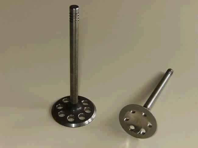

    Bruh,. Why havent you put in a set of these weight reduction valves yet? Thought you were on top of all the new tech. Time to scrap Goldilocks and start new with these
