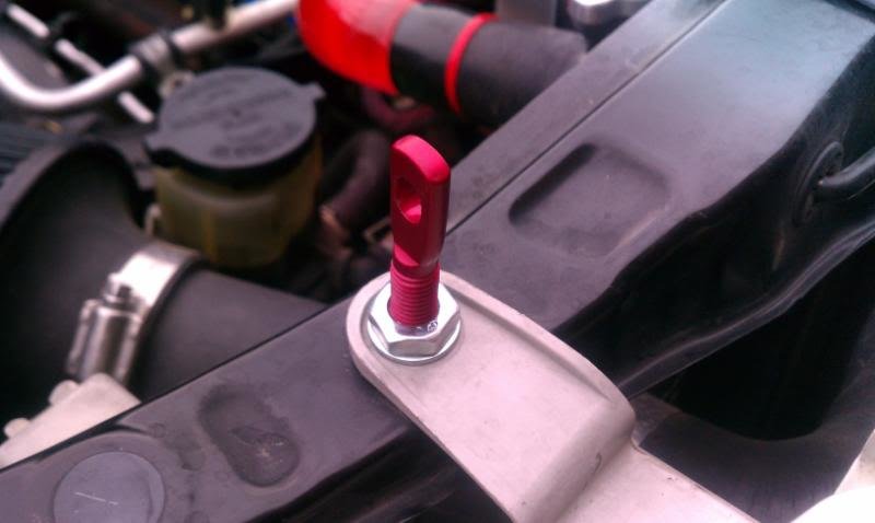

    Hey man, I figured I'd move the conversation to your thread. Did the hardware that you used thread right into the headlight mount?

    In this picture, if I remember correctly, there is a screw that threads into a plastic clip on the sub frame.
    I removed the both, then learned that by sheer luck, the threads of the red latch, perfectly fit into the square hole where the plastic clip used to be. So then I was able to spin it down until I had the proper height adjusted.

    Awesome. Thanks for all your help man!
