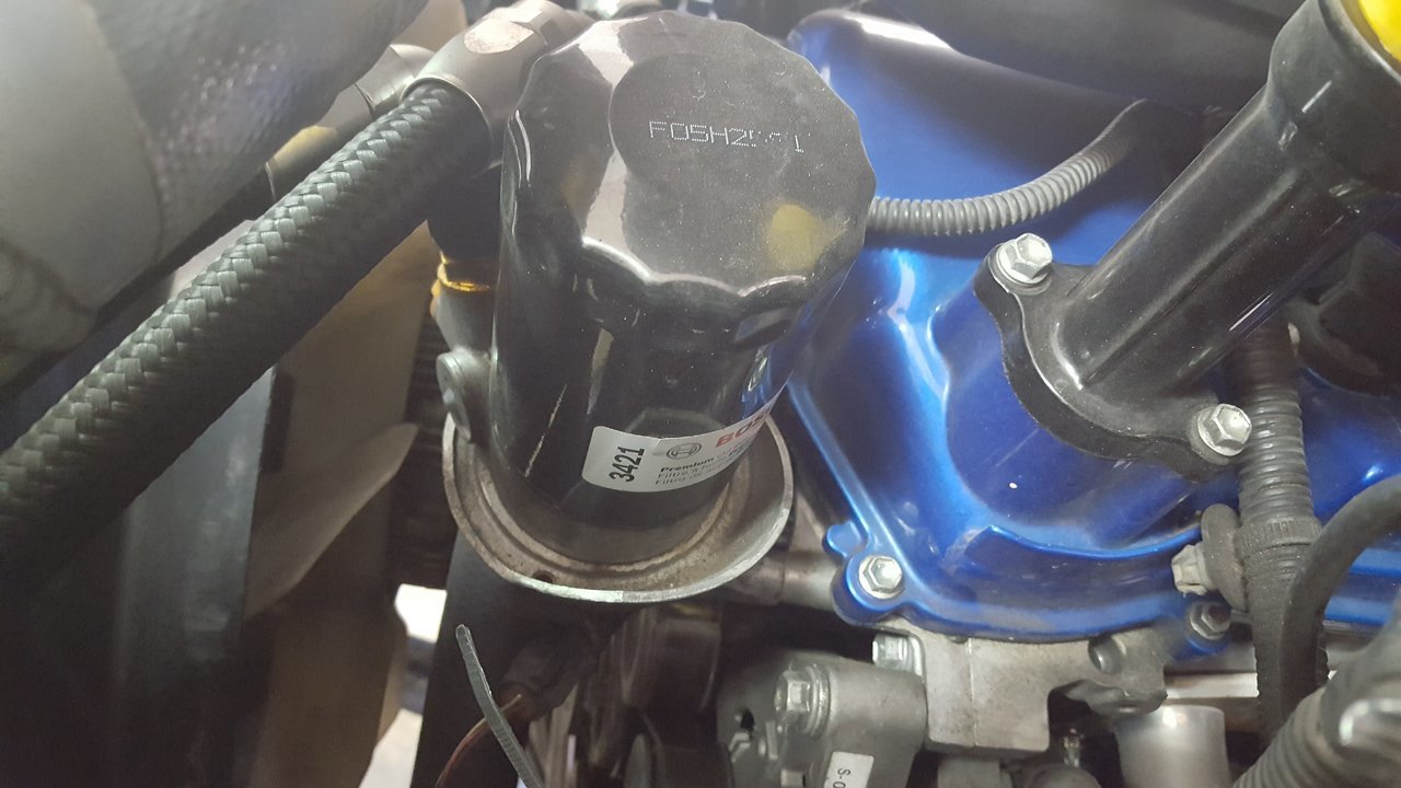

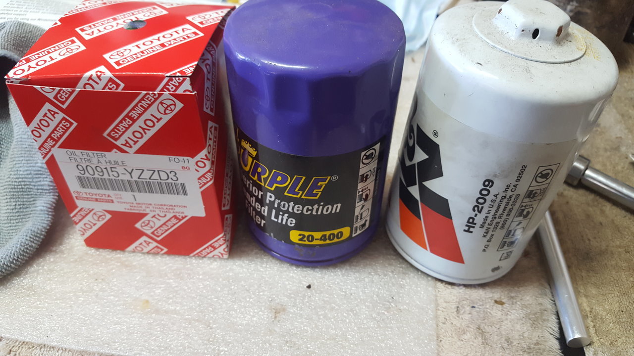

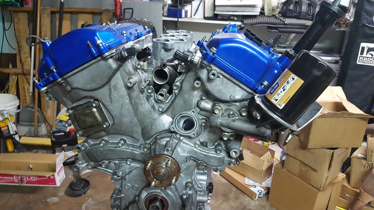

    @Radarninja here are some other filters as well.
    This one from the other thread:
    It is an M1-209. Larger. More media surface area, and a little more oil capacity, to help keep oil temps down. Here is the more crisp picture.
    As well as these:
    Soul Surfer, TacoLeeSD and Radarninja like this.
