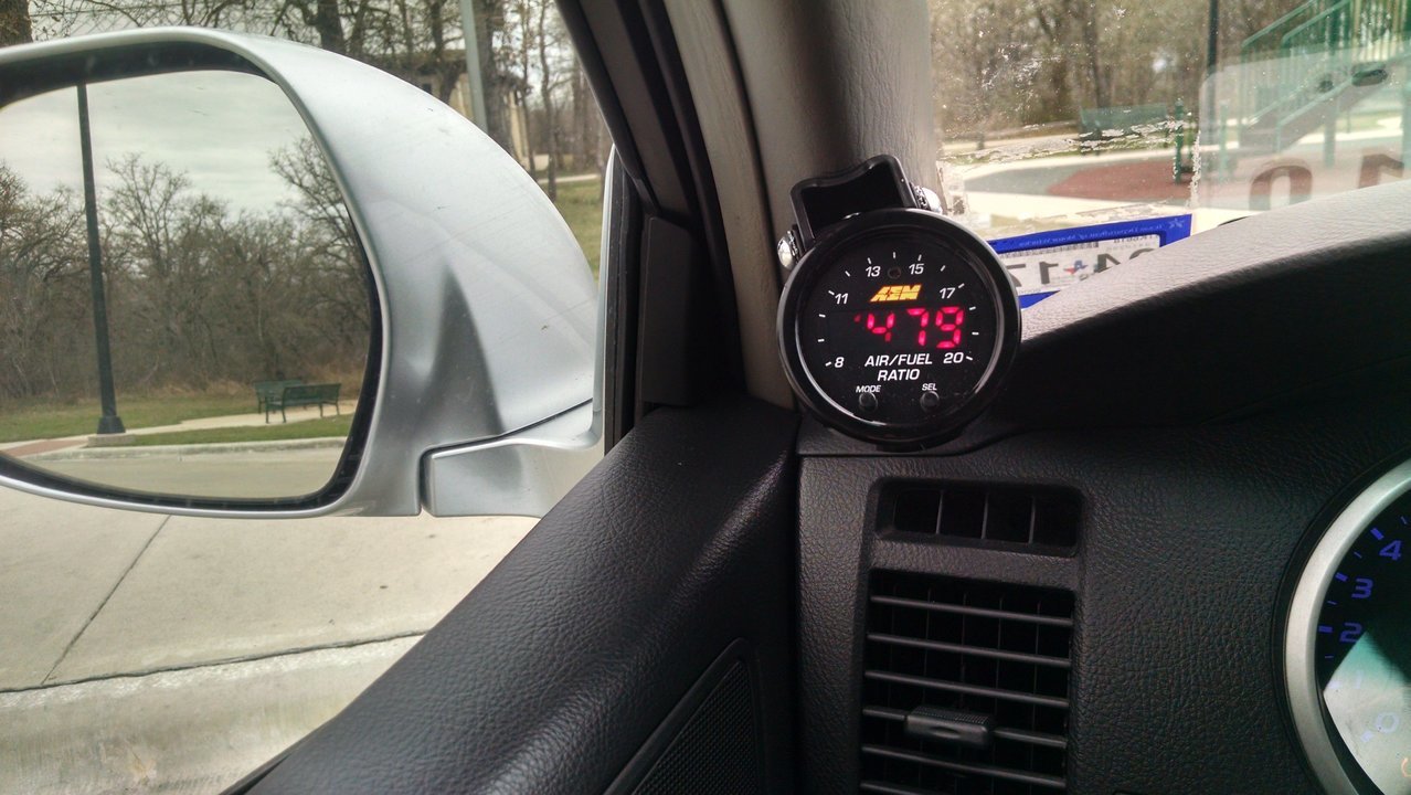

    You folks have a PN for the specific AEM gauge? :)

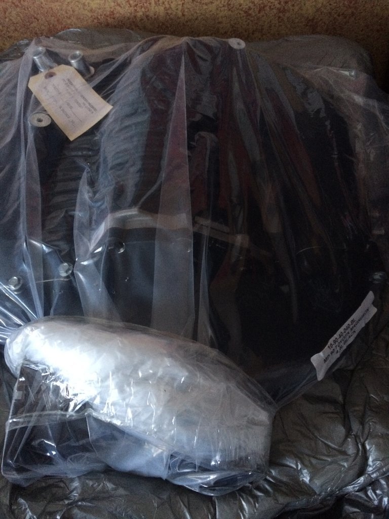

    Thankyou folks. Stockpiling of S/C and accessories continue. So sad, continues to sit in my room as a paperweight on my desk :(IMG_2369.jpg

    Can confirm aem is good. Really nice thing about it is the displayed range. IMG_20161230_125426283_HDR.jpg

    Samsies! Except I went with the AEM Uego, but unfortunately it only goes down to 10, and had I known what I know now, I'd have got one that went down further as it used to pin out under work, so I never really knew what my AFR was, just stupid rich.
    Speed hut custom -20 to +15 boost gauge since I won't be turboing anytime soon or going for that much boost, and everything on the market had to high of a boost scale, I actually wanted to see the needle move with my cute little 7 boost

    same exact boat here. AEM Uego and AEM Boost. AFR doesnt read low enough either.
