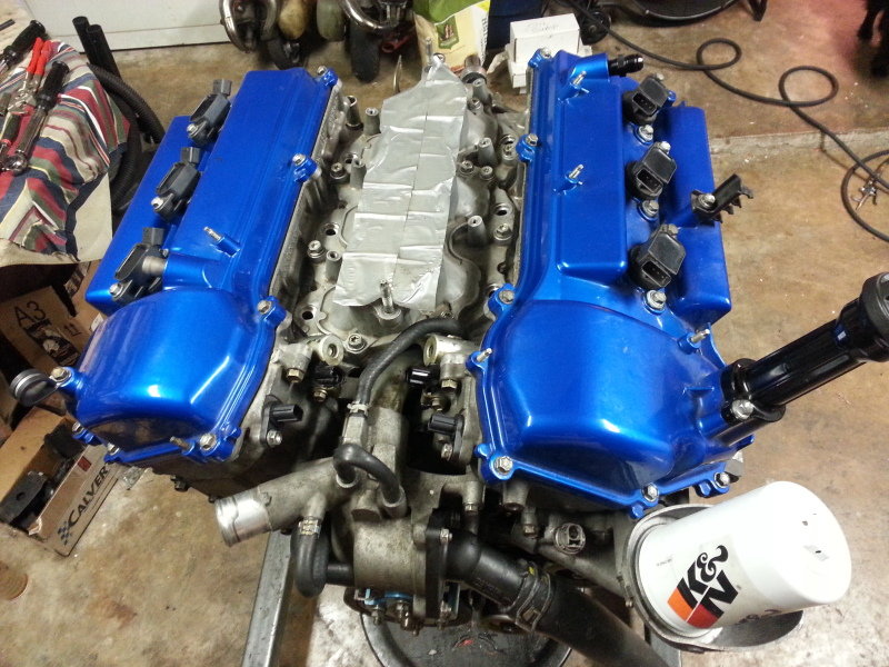

    And the build up continues. :D

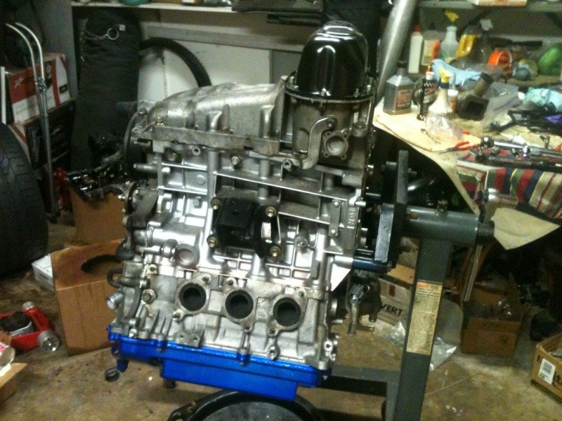

    Timing setup with assembly lube abound.
    Bank two cam gears lined up.
    Bank one lined up.
    ***Yellow links line up with the protrusions, and orange lines up with the recess.
    Water pump installed with a new gasket.

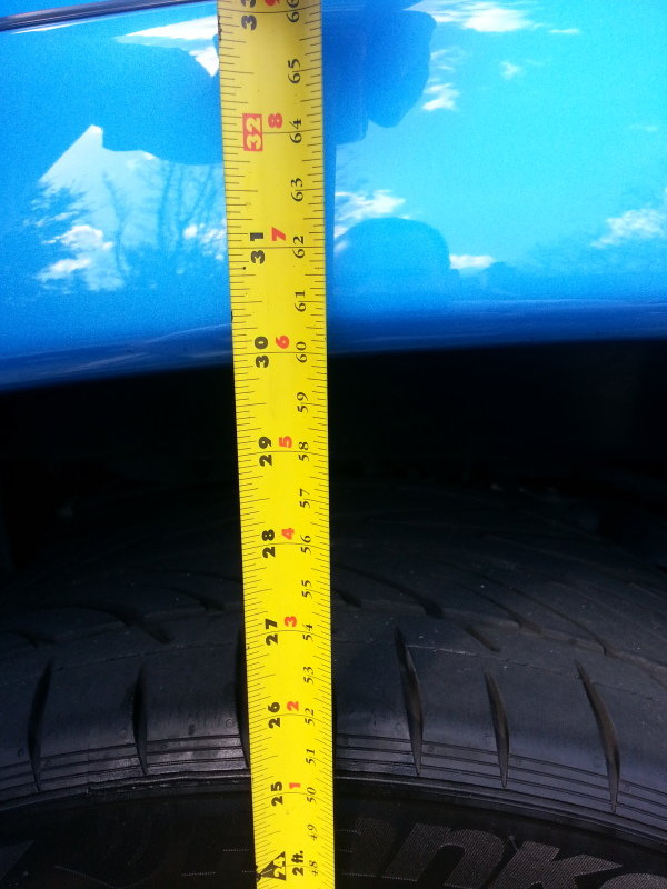

    This was a fun little experiment. My friend Grumpy was over, after Cars & Coffee. Decided to measure approximate ride height differences. His expression was priceless. :eek:
    Mine, through center of the wheel off of the ground.
    30.5"
    His
    Just under 30"
    I have 20" wheels, and with tires am 28" and change in over all diameter.
    His XR is dropped with the XII Performance drop. He has 18" wheels. If I had the same size wheels and tires as his truck, mine would be lower. Hehe.

    Wow... That almost seems weird to me. My measurement is almost 41".

    Crazy isn't it?!
    If I had know that this would have worked long ago, I could have saved a chunk of money too!
    Being that I now have a reference of how tall my ride height is, I am more confident about taking it to the road coarse. Giggity!

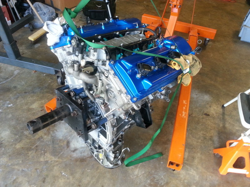

    Not finished yet, but all it needs are the lower plenum and idler pulleys installed. Won't be long.

    So once that break-in oil arrives. I should have the engine in the bay and buttoned up. Fill it up with fluids, and wait on the clutch to come in.
    Getting very close to having the truck running. In at least N/A trim. Quite exciting.

    Annnnnnnnd. 100% ready to install.
    Just need to clean up the engine bay tomorrow. See how far I get. Maybe set it in as well?
