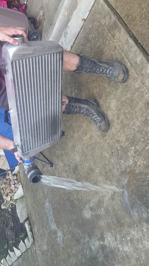

    Posted this in another thread.
    Here is a screen shot of my intercooler, from the video. The mist alone, slowly filled up the intercooler, until the engine starved for air. Sunday night, during the extremely heavy rain, making a trip to and from Cypress.
    One cylinder had a little water in it. Spark plugs all out. Added a little oil to each cylinder. Cranked until all of the water was out. Then changed the oil three times.

    What?!?! Wheres the video?!

    Tried posting it, but the site said that it was the wrong format.
    Happened on Sunday, but had to wait until Tuesday afternoon/eveing to start working on it. Been running like a champ since. :thumbsup:

    Wow! That's a lot of water. Glad to hear there was no damage and everything is running ok.

    It appears that no one informed you that an air-water intercooler, has water on the OUTSIDE of the cooling tubes. Silly tuner guy you. :D

    You mean that was wrong???
    The lady filming asked, "isn't that supposed to have water in it?" Explained that it wasn't a radiator.

    Guys come on, its obvious what it is. A water purifier.

    Note to self, Meth injectors go POST intercooler.
