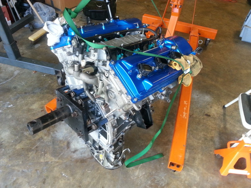

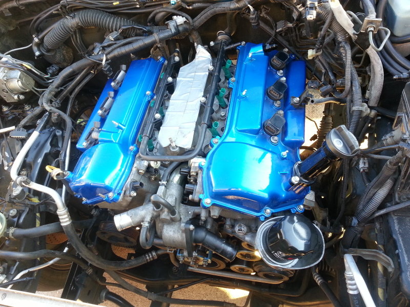

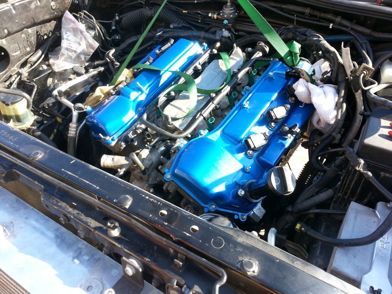

    That is where it stayed until today.
    Almost dropped in.
    And accessories bolted on.
    So depending on how busy i am this weekend, i might be able to button up the last few things, to get it ready for the clutch to arrive.

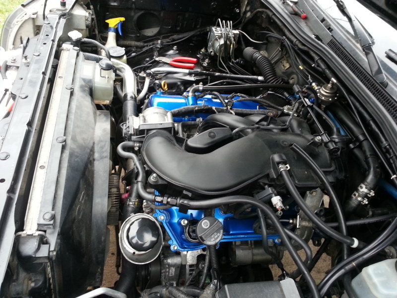

    And a more recent picture. Every thing is buttoned up, and ready to start. Minus coolant and a battery. Mine is toast. So I ordered a new one.
