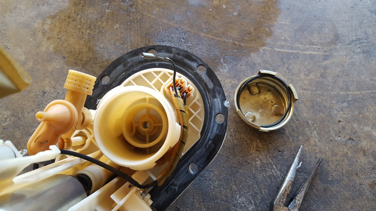

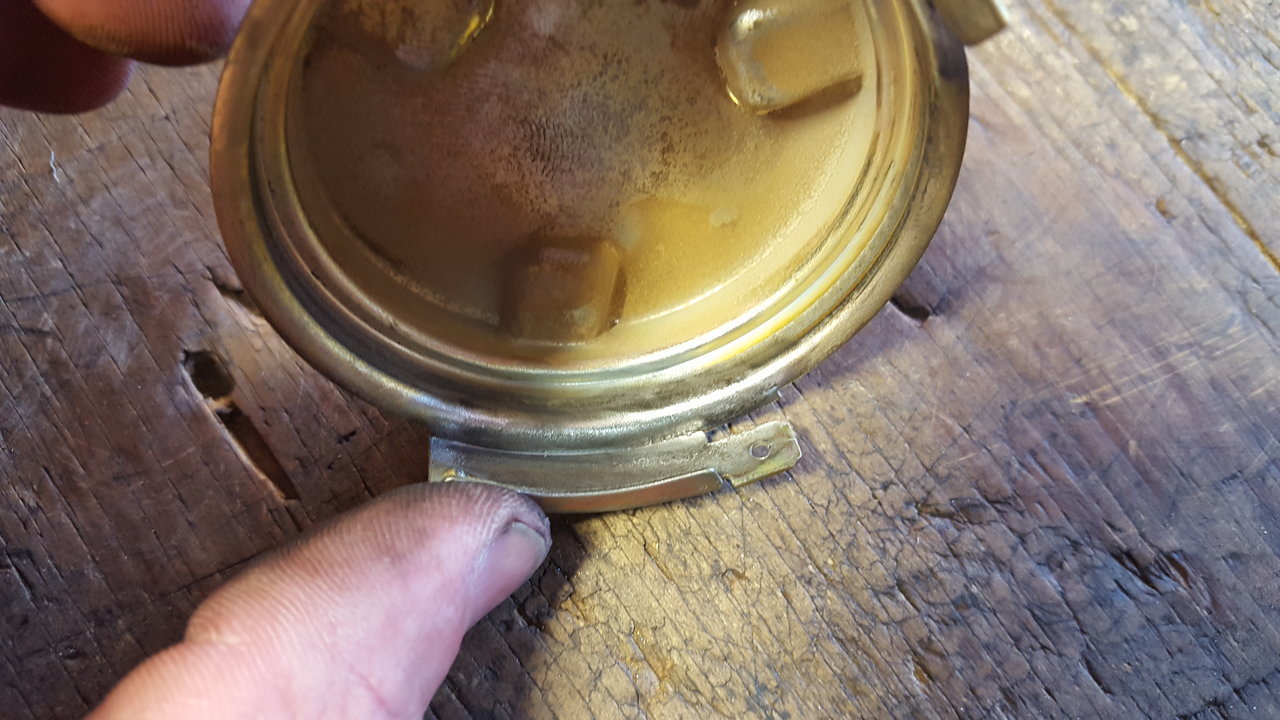

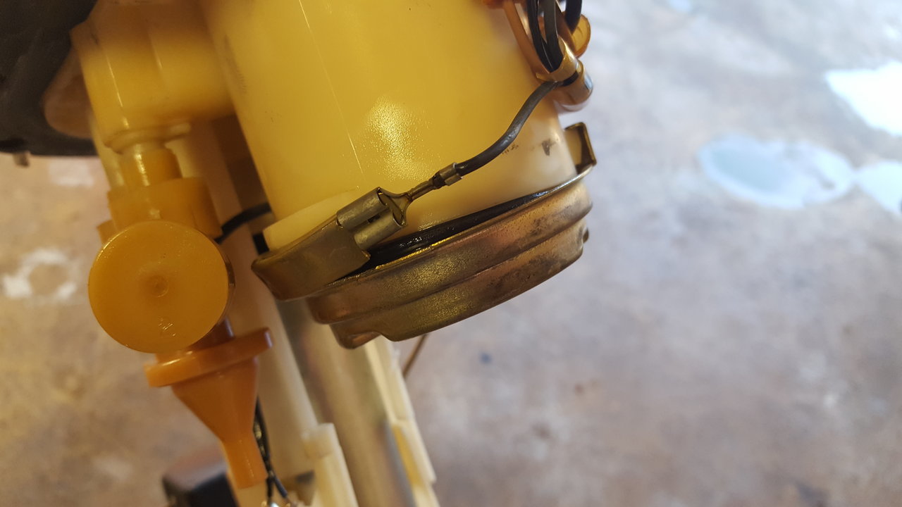

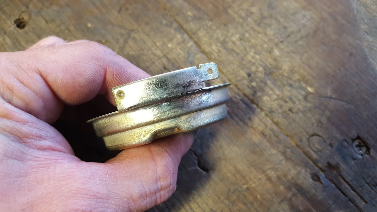

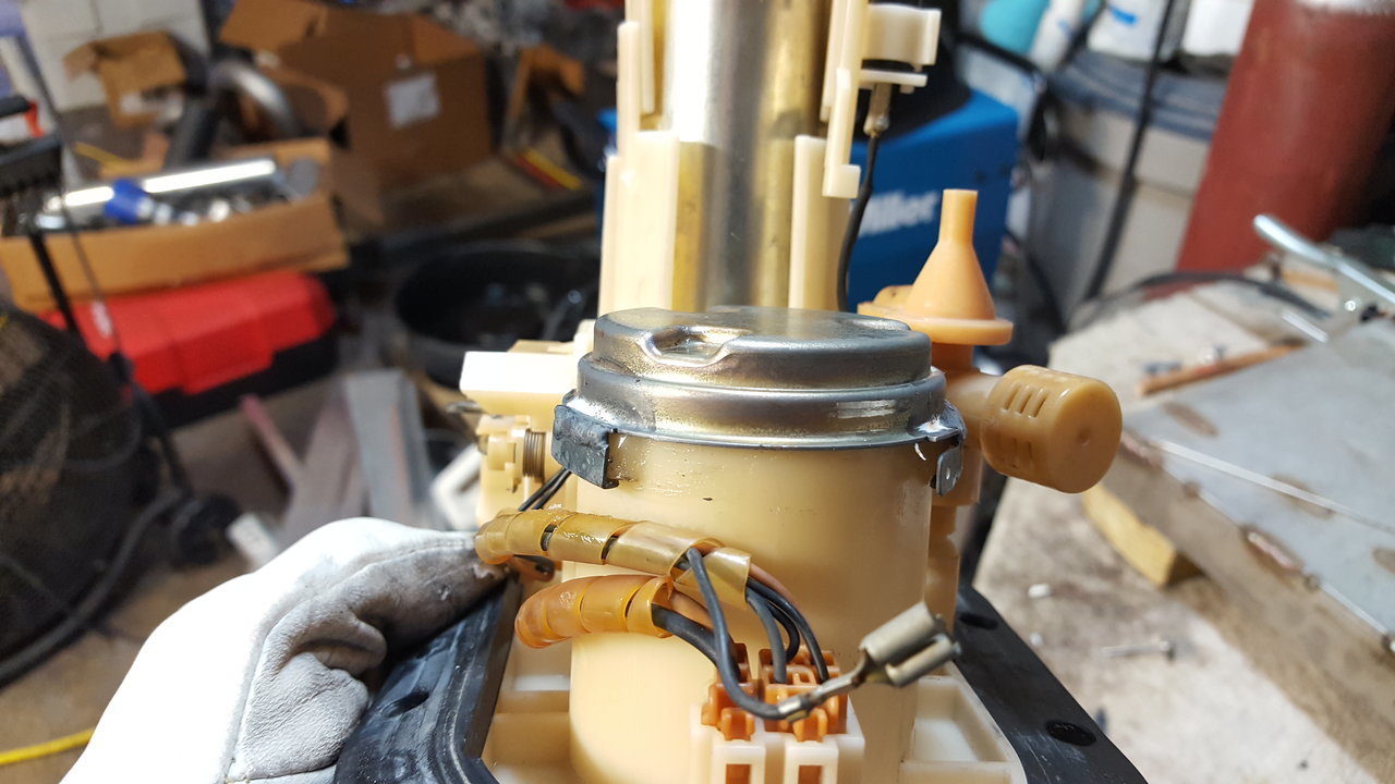

    My friend who had purchased my Subi called me up stating that the car wouldn't start. Did some testing and found no fuel pressure, but the pump was working.
    After a few minutes of research, I found that there was a common problem with the 2001 Subaru Outback era cars. The fuel pump bowl's cap would split, and allow an o-ring to bulge out.
    20171220_162959.jpg 20171220_163513.jpg 20171220_164838.jpg 20171220_164845.jpg

    How many miles on the car?

    Some low current DC, and I reinforced the cracks. Good as new. Welder is Doing Work.

    The Subi has around 300k

    Well you cant say the pump didnt try to last. Lol

    One could say that, if it weren't related to me.....but that used to be my car. I can't look at something without it being modified in some manner. :anonymous: That was a Walbro 255hp that I installed at about 190k miles.

    HAH so the aftermarket part failed in the same manner as the OEM?

    Negatory my good sir. It was still working like a champ. With the O-ring blown out of the bowl's cap, the pump was as effective and a donut exhaust. It just kept filling up the fuel tank. Path of least resistance.

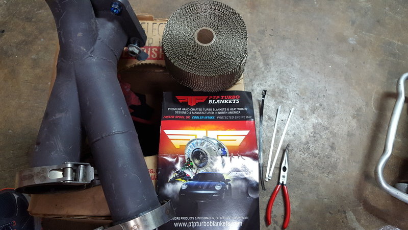

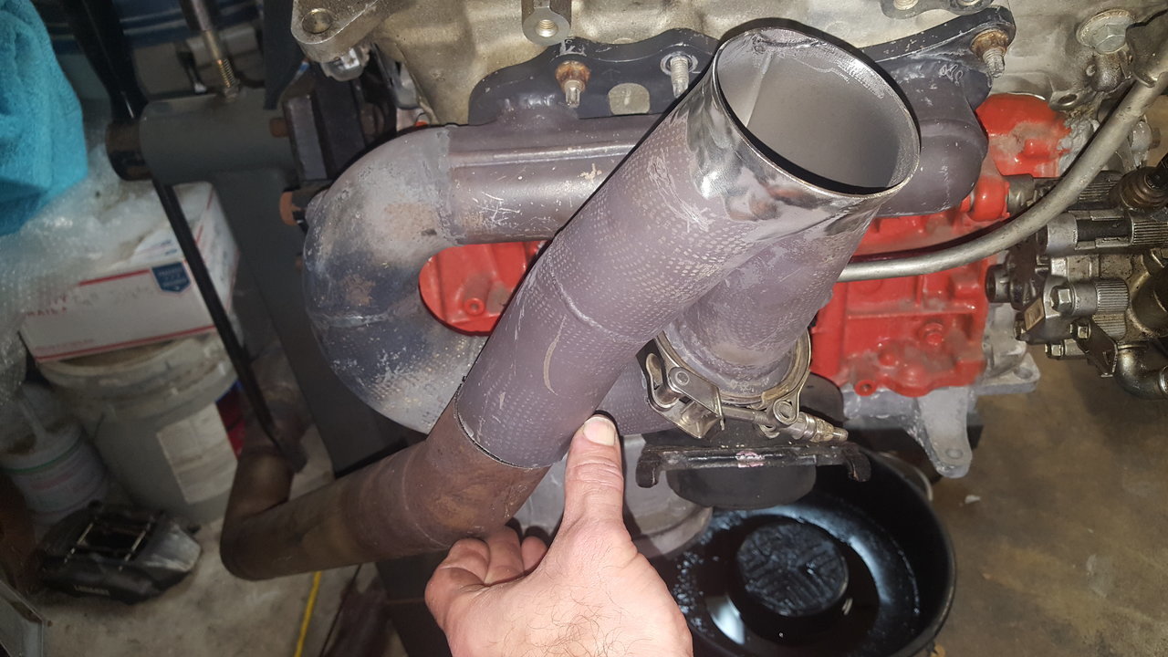

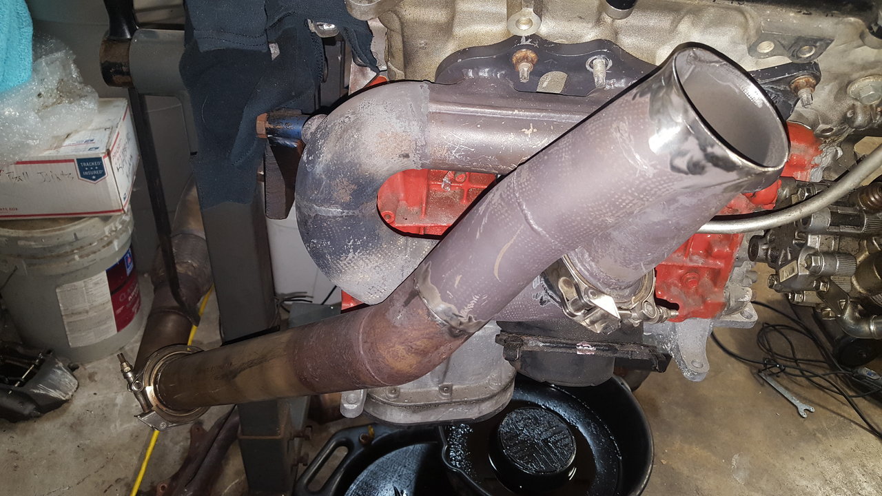

    I don't know how all of you are enjoying your Christmas Eve, but here is how I have spent a good portion of mine. Fab-ulous. Lol .
    The merge started out like this.
    I moved one of the flanges lower on the cross-over, to a more manageable and far less annoying location.

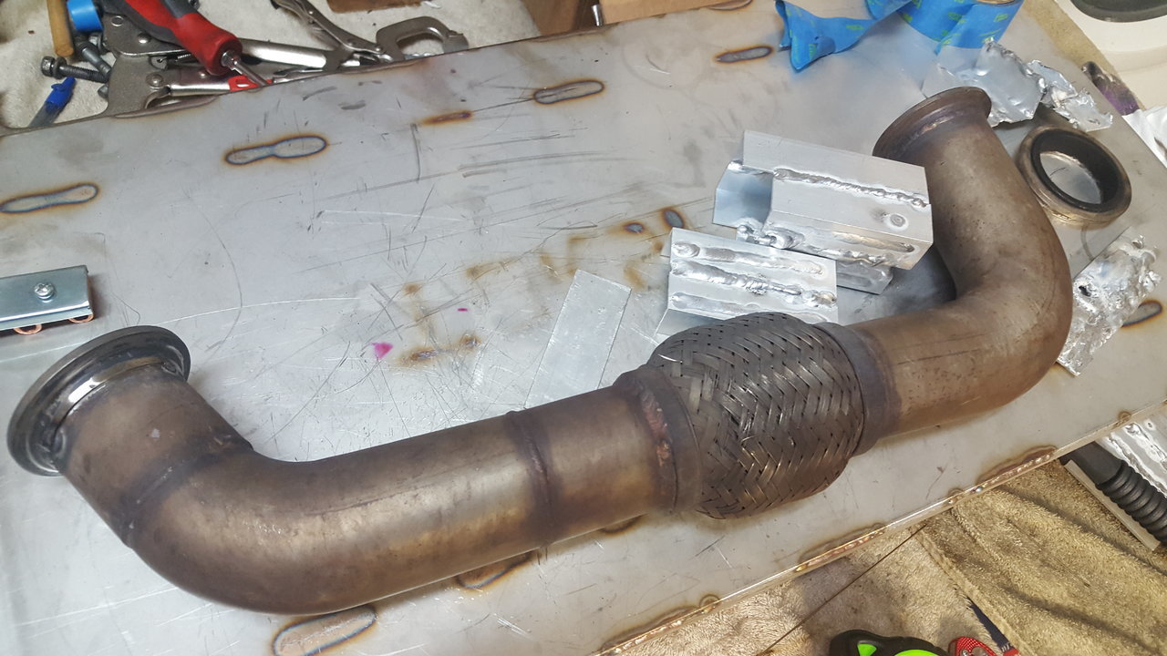

    Here is were the cross-over flange used to be. The merge collector now has the long leg, while the cross-over is much easier to manage while working on my back.
