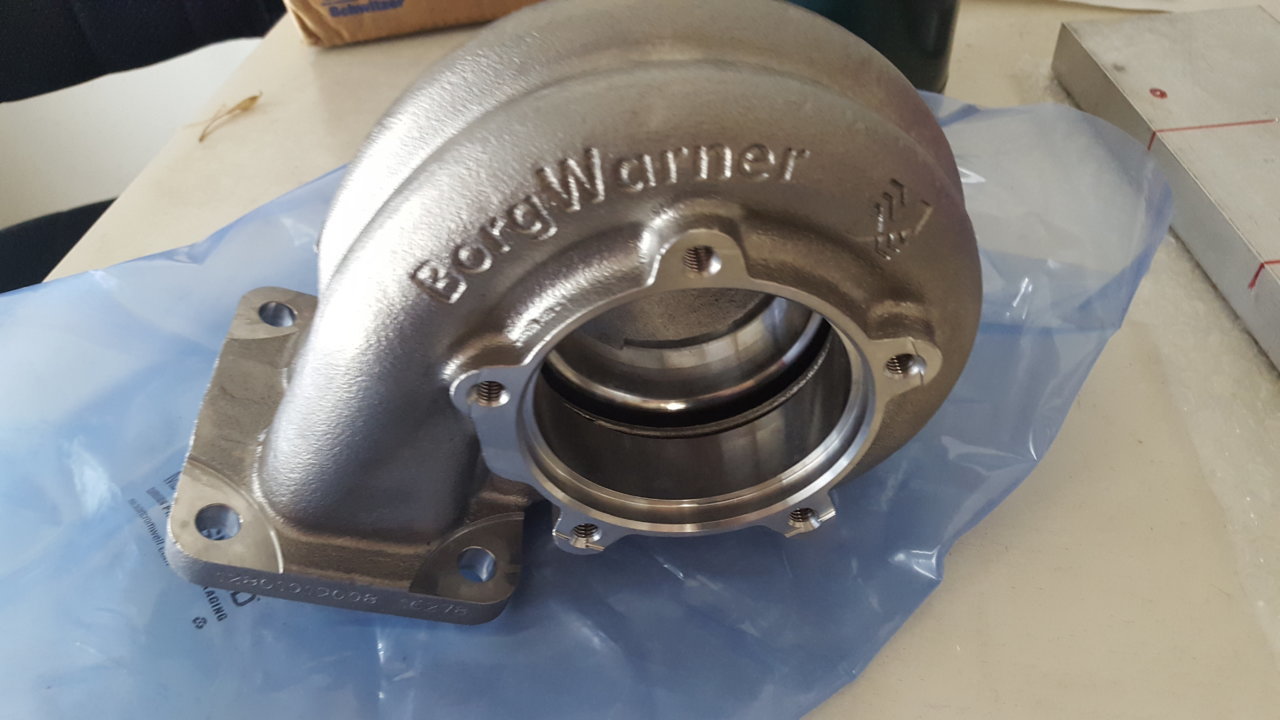

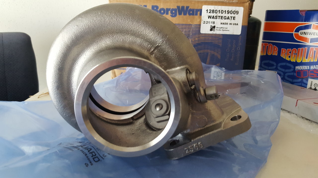

    The turbine housing that I have is for an external wastegate. It also has an A/R of 1.05. The new turbine housing has an Integrated Waste gate, and an A/R of .94. Slightly quicker spooling. My main focus is the integrated wastegate. Simplifies packaging.

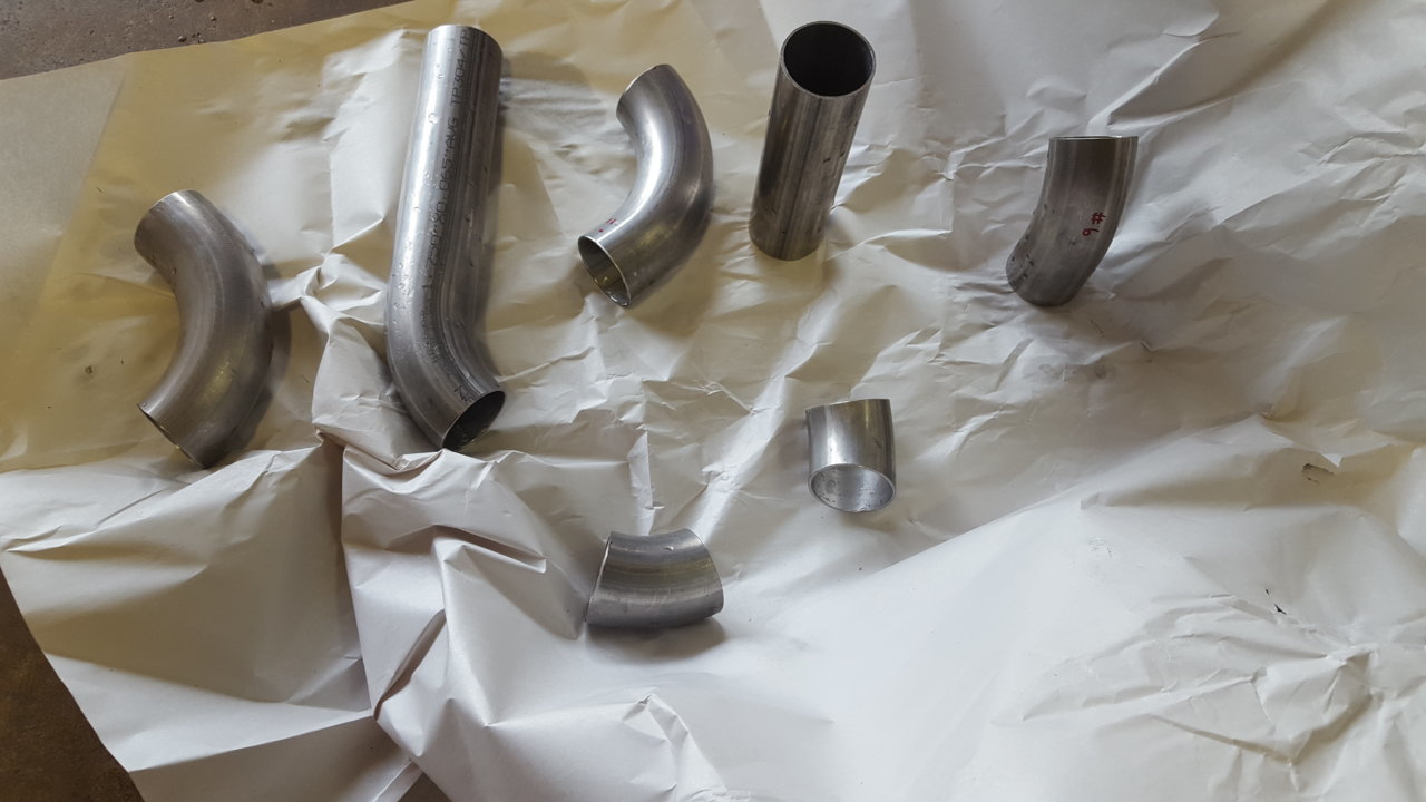

    Here are a few of the latest item to roll on from the boost and fabrication gods.
    Got this is the mail. Then quickly realized that I need more things in the mail....
    Integrated wastegate housing.

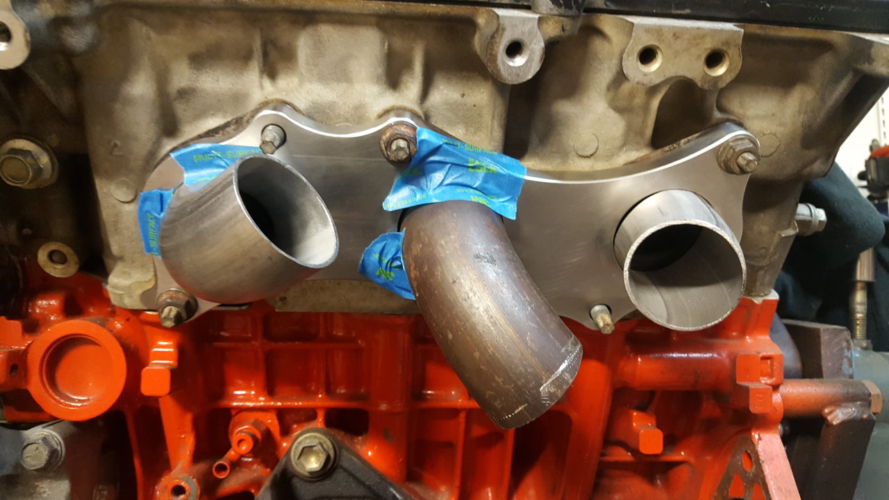

    Been doing a little fooling around with the driver side header mock-up.
    A few more pieces of material will be on their way soon enough, to finish up that header project. :D

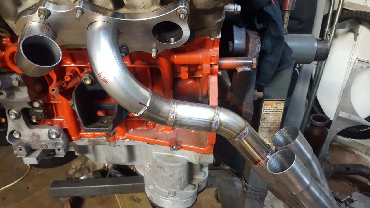

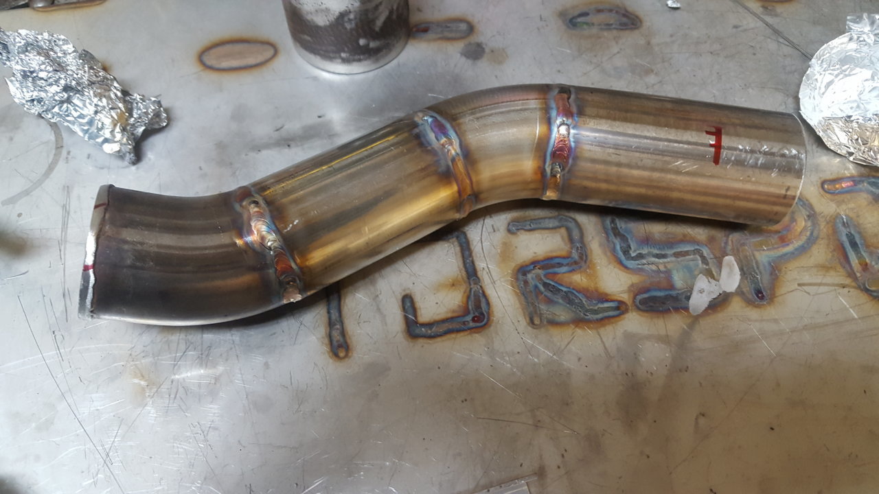

    After a weekend of hanging out with @Lucario Runner , modding and relaxing, I decided it was time to get back under the hood.
    I spent a few hours in the garage...and turned idea into reality.

    I had originally wanted to get all extravagant and but then decided just to keep the form simple. Solar Flux is an absolute dream, making it easy to weld the parts together without having to back purge. I am a fan.
    This is where I leave off for now.

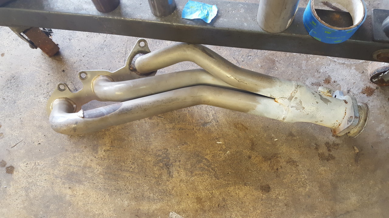

    Here is a fun fact. The original gen 1 Doug Thorley long tube headers were made with 1.5" primaries. As seen below.
    Those are smaller than the current gen 2 Doug Thorley long tube primaries, which are 1 5/8" O.D. I purchased that gen 2 set from @Lucario Runner some time ago, when he upgraded to the URD Spec-U headers. I believe those are also 1 5/8" primaries, but that would need to be verified.
    This header, which I am fabricating, has 1 3/4" primaries.
