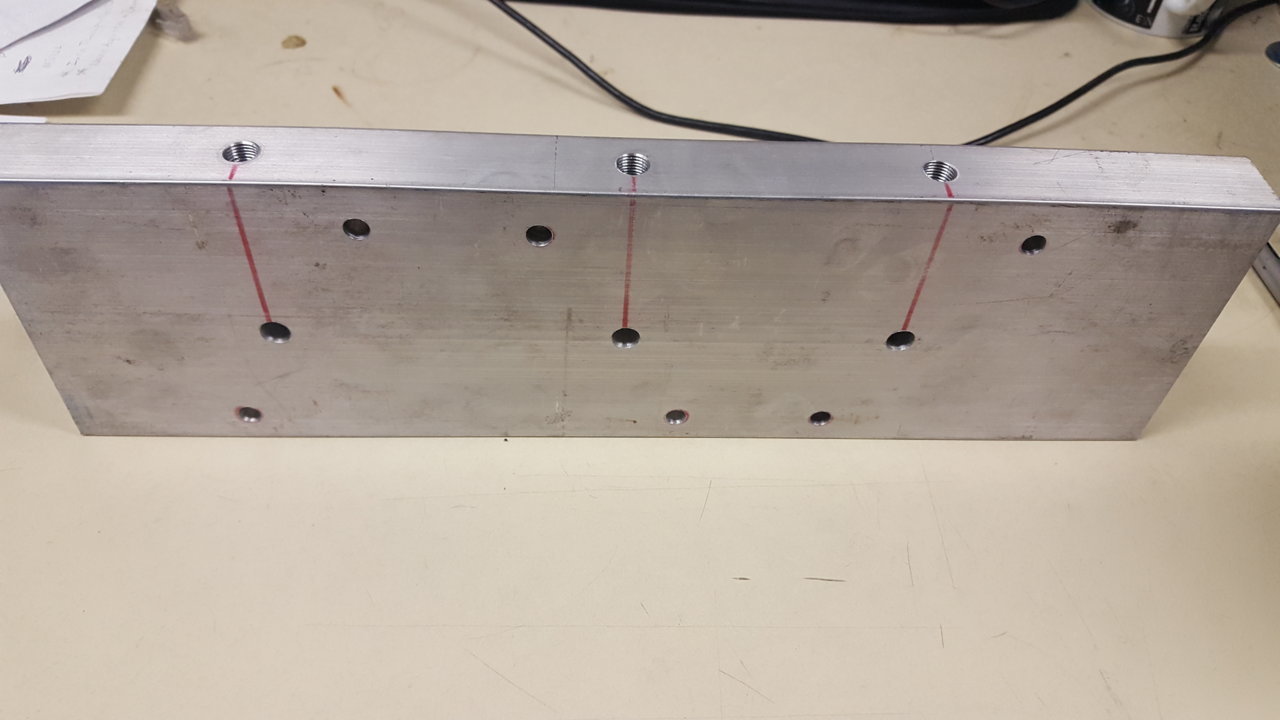

    Back-purge torque block. Just finished. For 1GR header flanges.

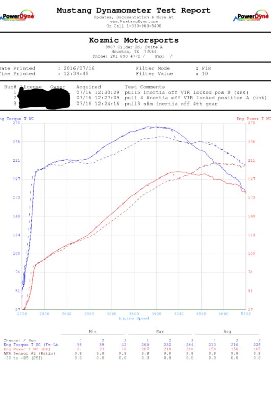

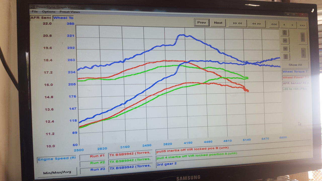

    Weather changed my plans today. Had hoped to install the kit, so that I could fabricate the down pipe. Instead I went back after the tune.
    After comparing the two dynos posted, I had a strong feeling that the ACIS valve was setup to transition to long runners, at 3900 rpms. In the previous graph, there is an obvious down turn in the torque curve, at 4100. Not up.
    That is why the torque spiked up in the most recent graph.
    I altered the "On" rpm of the ACIS valve to 750 rpms. Long runners for torque until 4100. Then "Off" for the short runners.
    As anticipated, a huge bump in low rpm acceleration was realized. Let me tell you, it keeps on pulling to 6100 rpms now! Wow!

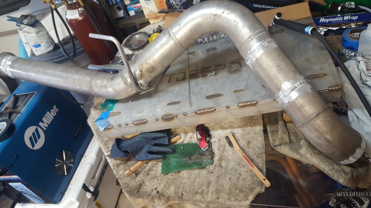

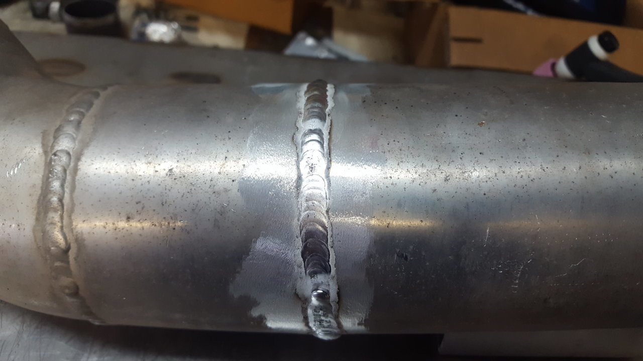

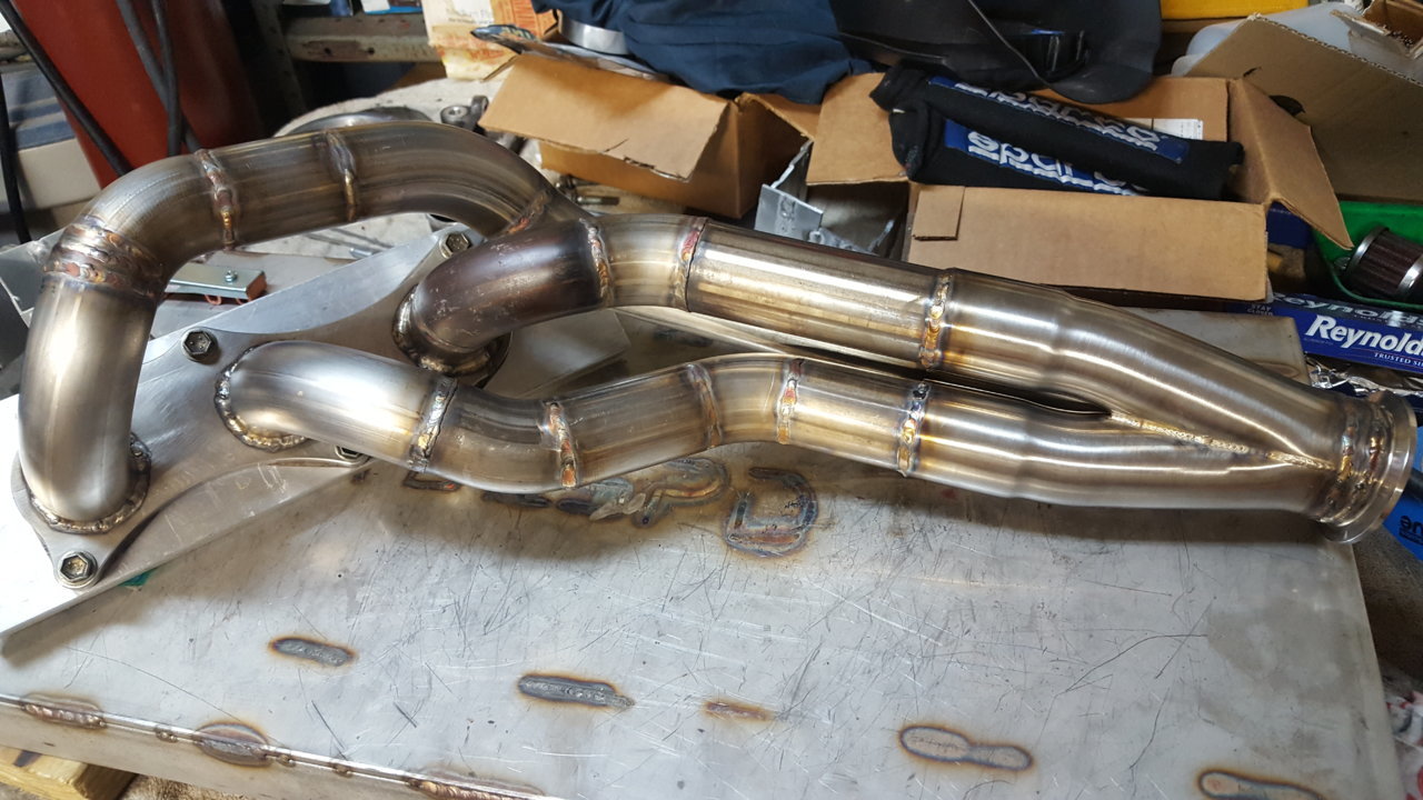

    And the finished product. It is not the finest piece ever constructed, but I am very proud of my accomplishment. Especially after only a few months of welding.

    Frick yeh mane that's a nice looking piece!

    :hattip: Thank you! Feeling liberated.
    I was aching to get these parts on today. :pout:

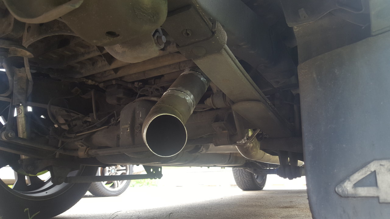

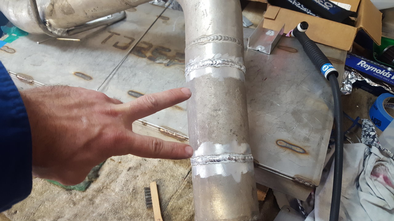

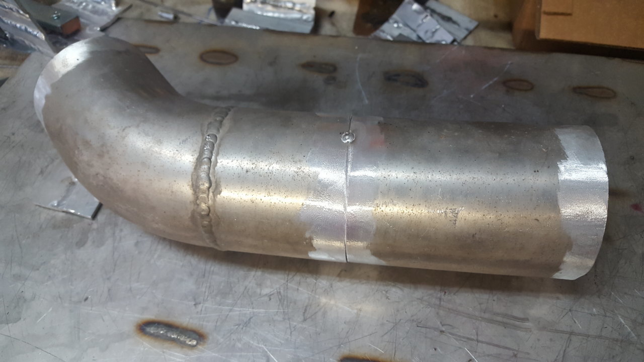

    Most recent mods, since Friday.
    Installed an Earl's Performance -8AN fuel check valve.
    Finished up fixing the aluminum axle back exhaust tubing, and routed it in a direction from under the bed. Which also means that the turbo kit is on. :spy:
    20180413_154238.jpg 20180414_123656.jpg 20180414_124714.jpg 20180414_131759.jpg 20180414_132034.jpg 20180414_140050.jpg
    It is past time that I get a true work table. :facepalm:

    Damn mark! U got some welding skills now bro. Long time no talk. Haven't logged into Tacoma forum in a while. Lol. I went to the dark side and went v8 ls3. Also I'm gonna pm you my new number brother.
