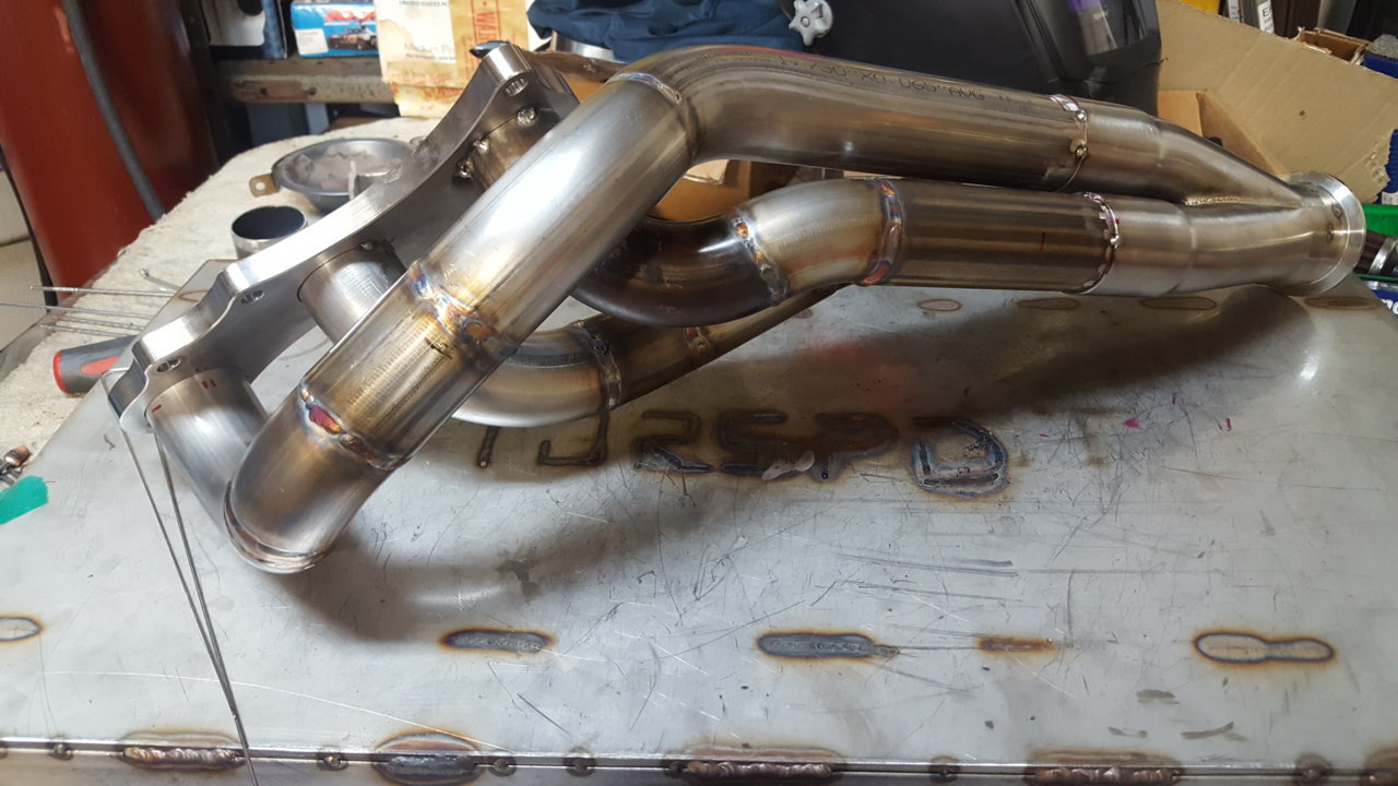

    Finished my last welds, with barely a few PSI left in the tank. I was getting anxious about that.

    Looks awesome dude! So much work involved with proper exhaust builds. Tolerances need to be spot on.

    It goes quick. Especially doing tack welds. My welder has no post flow adjustment so a 2 second tack is still burning 10 seconds of gas.

    Yikes! Mine doesn't either, but I have not timed mine to know how long the post flow is. With the #12 Furick cup, at 25 CFH, and back-purging, it was literally like watching the needle on the gauge drop.
    I need to upgrade to the next biggest tank.

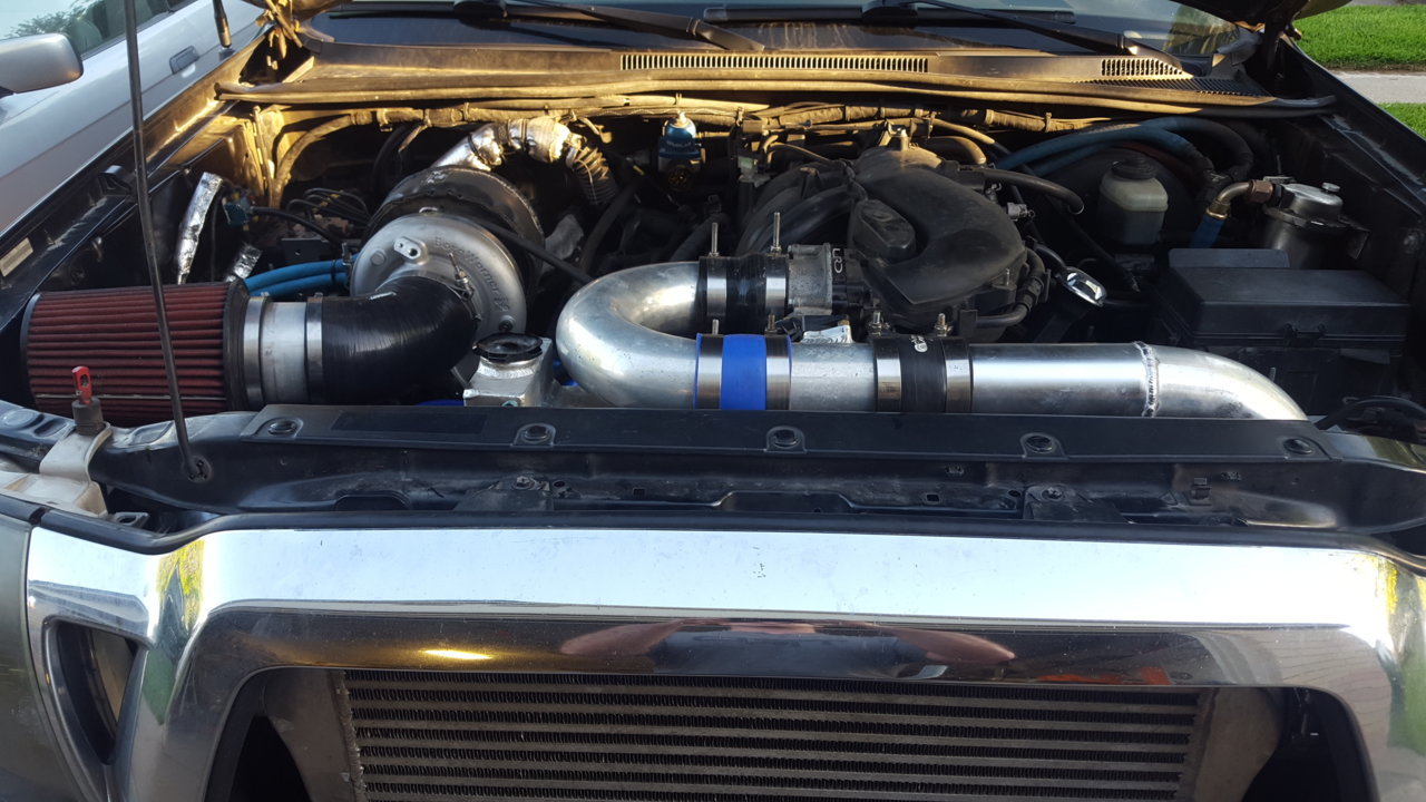

    Been awhile since it was like that.
