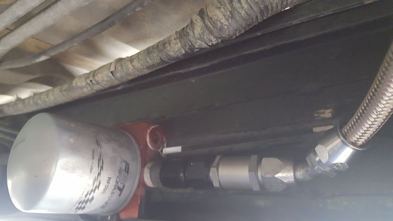

    How does the earls check valve benefit you?
  5. Apr 25, 2018 at 8:30 PM
    #7185
    Biscuits
    Biscuits Thorny Crown of Entropy
    Aug 8, 2010
    #41397
    15,577
    Swiggity swangin' biggity bangin'
    The very nature of the check valve means the fuel system will remain pressurized, which will help with hot starts and if the vehicle has not been started for extended periods.
    Would also be of assistance when replacing the external fuel filter.
