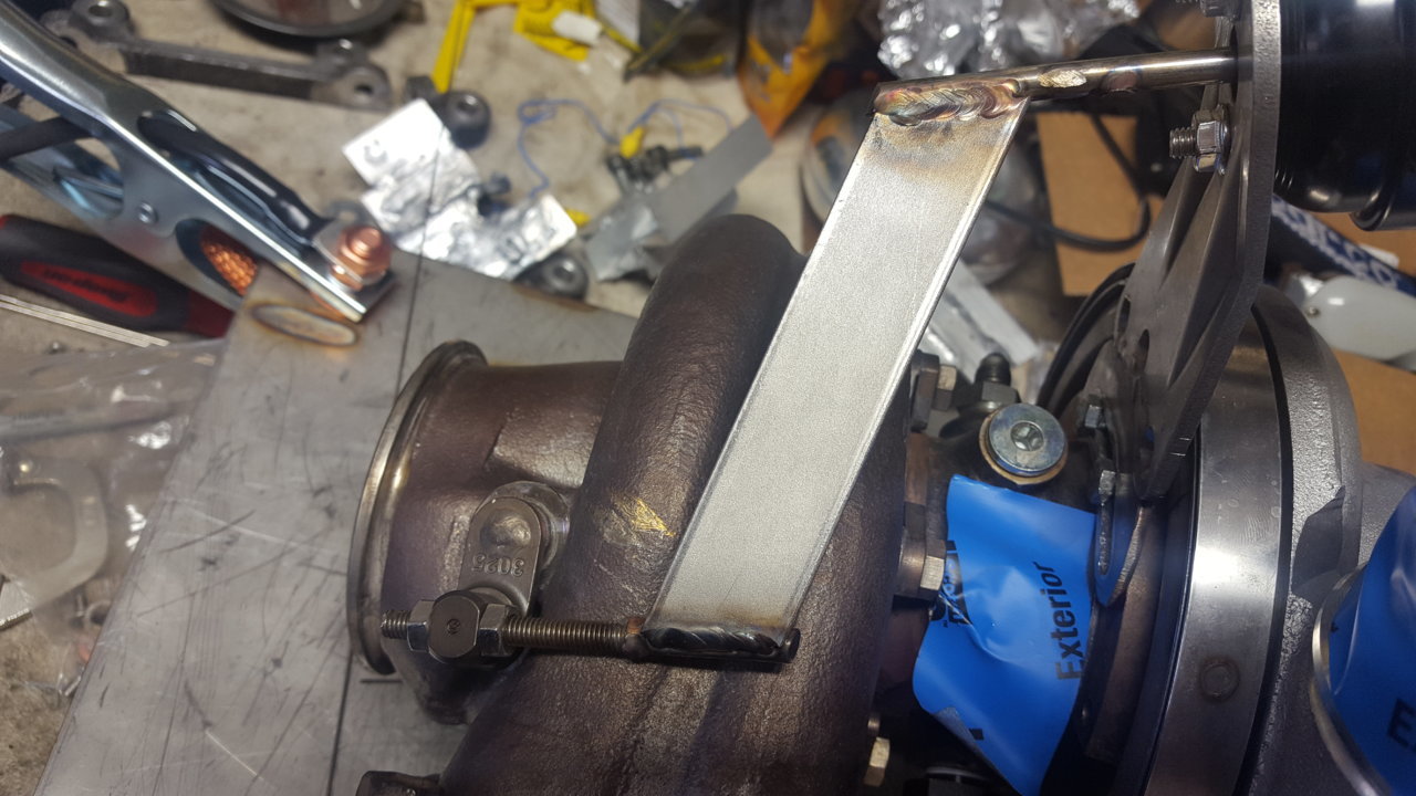

    Why was the valve opening so easily after adjusting the rod end? Deflection of the actuating rod?

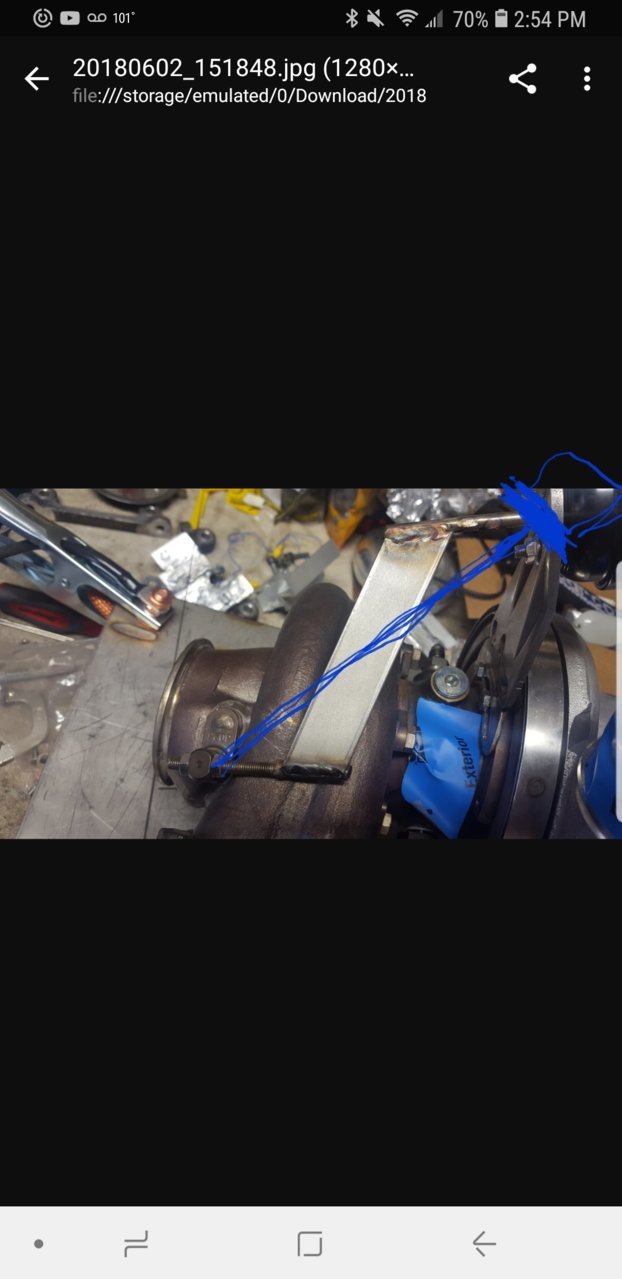

    You have a picture of what you tried? That does not sound like what I was suggesting lol

    This is what I was suggesting. The axial plane has very few variables when placed like this

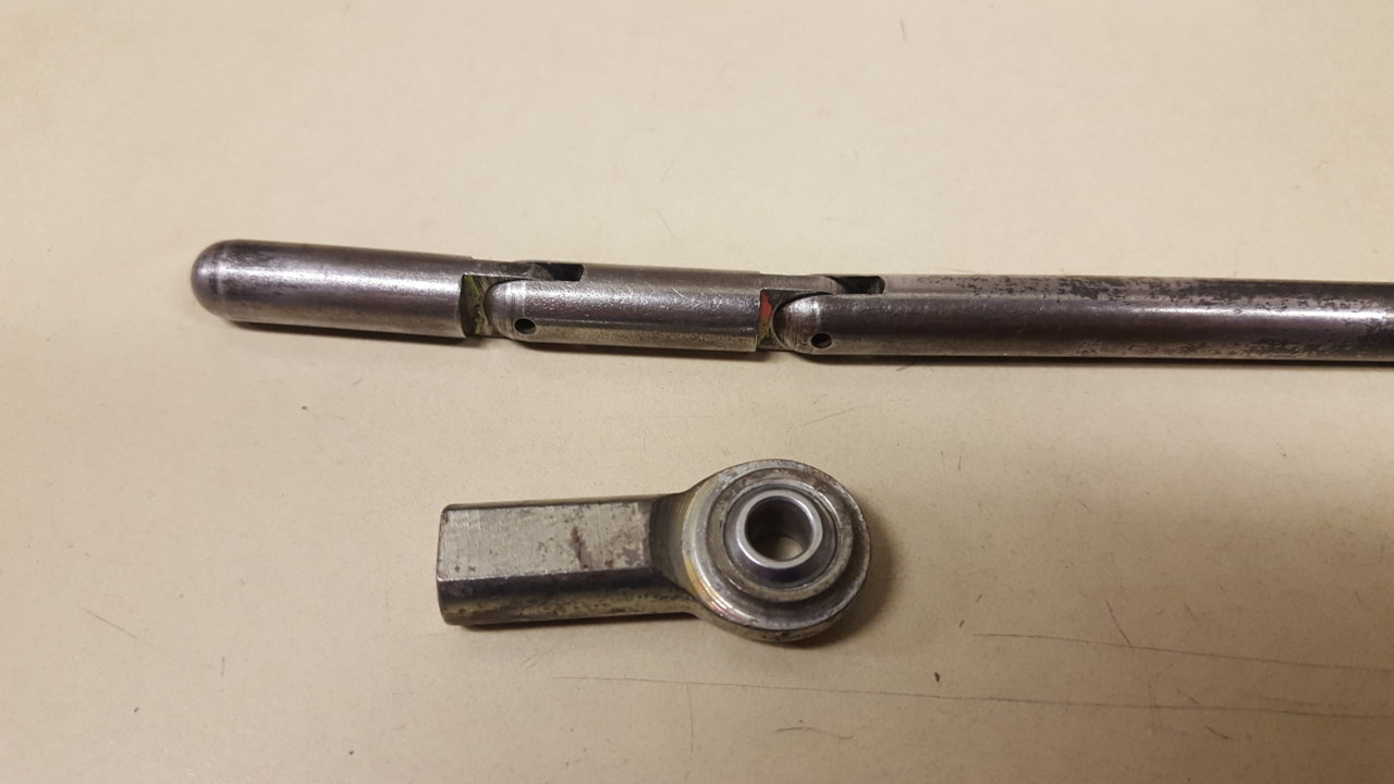

    I believe another part of the original issue, was the virgin state of the wastegate. It has a spherical end to allow deflection. I even greased it to help it flex, where the rod comes out. It was EXTREMELY stiff. Now it deflects quite easily. Some time and operation helped to wear it in I suppose.
    Holds a steady 6 psi now. Nothing impressive, from a boost point of view, but it holds it repeatedly. That is a good sign.
    Now to fix a v-band exhaust leak that I found. Ugh....whhhhhhyyyyyyyyyy. lol

    so you didn't try my method lol

    I thought that was your method? Angled flat bar.

    The blue is what I am suggesting
