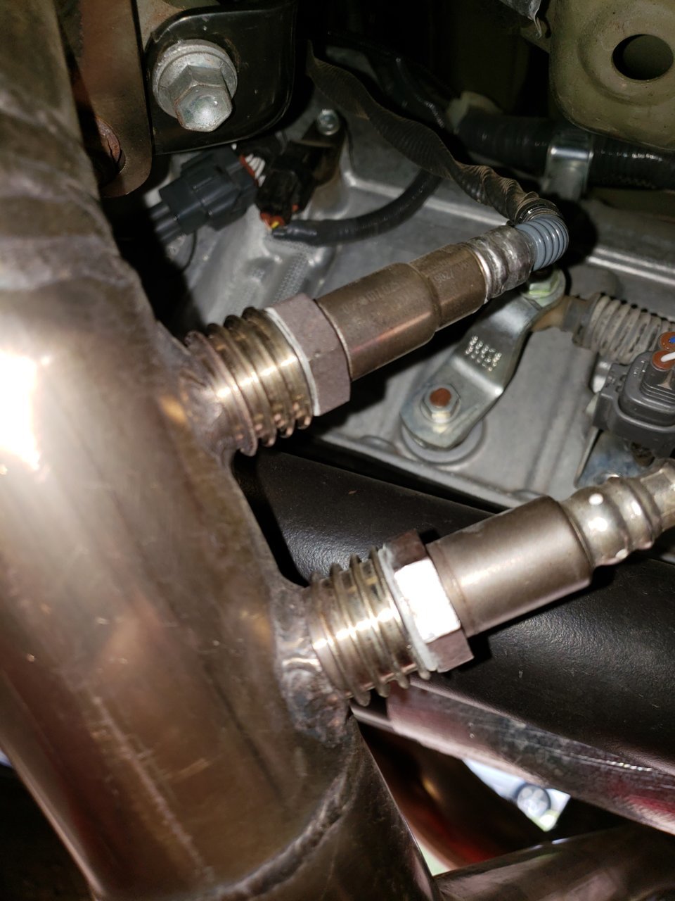

    The instructions for my PLX wideband said roughly 18" downstream for NA and 24" downstream for FI applications.
    05Taco4x4 and Torspd[QUOTED][OP] like this.

    When I was working on a Hyundai Genesis Coupe 2.0T, I remember it being mere inches away from the outlet. Which thoroughly surprised me.
    However, there was only so much distance that the catalytic converter could be, to meet lightup efficiency. Thus it had to be between the outlet and the cat.

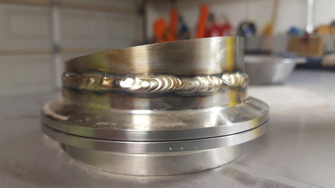

    Side project starting, should I not be able to fix the issue with the internal wastegate. Started this tonight.
    05Taco4x4 and Slashaar like this.

    From pictures I've seen, I believe it's the same way on my WRX, but I haven't been under it with the bottom cover pieces off yet to verify.

    Mod-topia Governor? All about it.
    I am betting the Subi is quite similar.

    My speed3 has the o2 right next to the turbo on the down pipe side. Only think oem can get away with this madness because that o2 sensor is $350 compared to our $80 gauge sensors. I give my oem sensor credit with how much abuse I give it.
