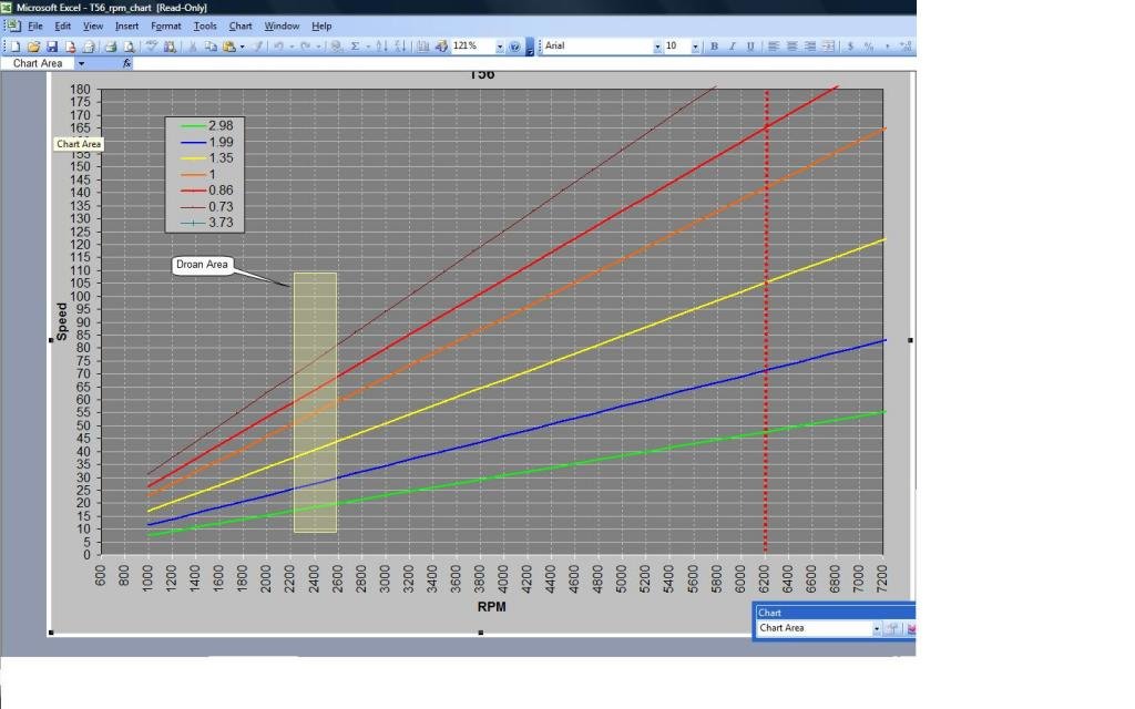

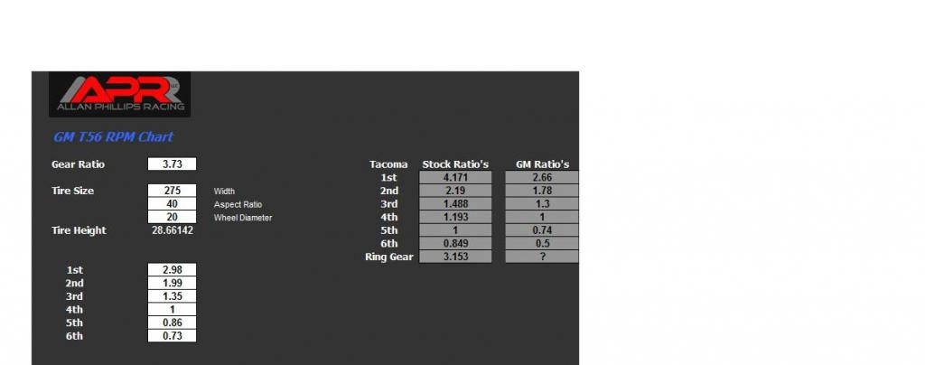

    Speaking of, I had thought that my gears were a specific set, but wasn't sure. Until I found a speed/gear ratio calculator.
    Now I know exactly which gears my transmission has, based off of the speeds at which I had to shift. I will post those up a little later. Until then, the newest additions.

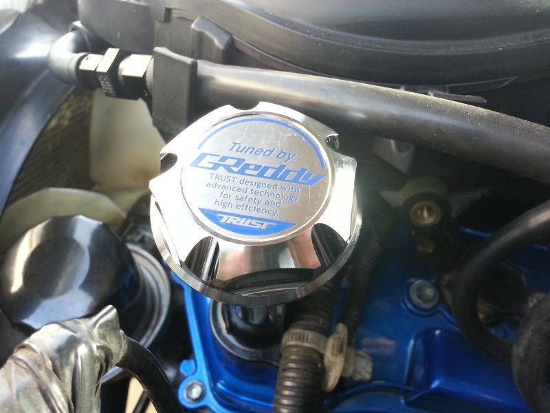

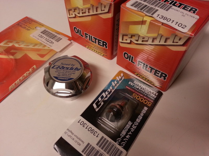

    I purchased the OX-02 filters.

    You're 6th gear is almost the same at the 5 spd auto's 5th gear, 0.716

    Curious now what all of the auto gears are? I'd like to punch them in and see what 5th gear's limit is.
  12. Feb 26, 2013 at 4:20 PM
    #732
    BradyT88
    BradyT88 Well-Known Member
    Nov 3, 2011
    #66419
    36,723
    3.52, 2.042, 1.4, 1, 0.716

    Have you had the opportunity to drive around on your T56 yet? I just noticed that your 1st gear went from a 4.171 to a 2.98. How different does taking off from a stop feel now, like during daily diving?

    Yes actually. I installed it after the spare engine went it. But prior to it having the rod knock problem.
    I cannot not honestly describe how much smoother the shifting is compared to before. It is something that has to be driven to truly feel the difference.
    Taking off is very easy. Probably due to the fact that my truck weighs just 3700 lbs. If I ever did change the final drive, I would most likely go to a 3.90 out of an FJ.

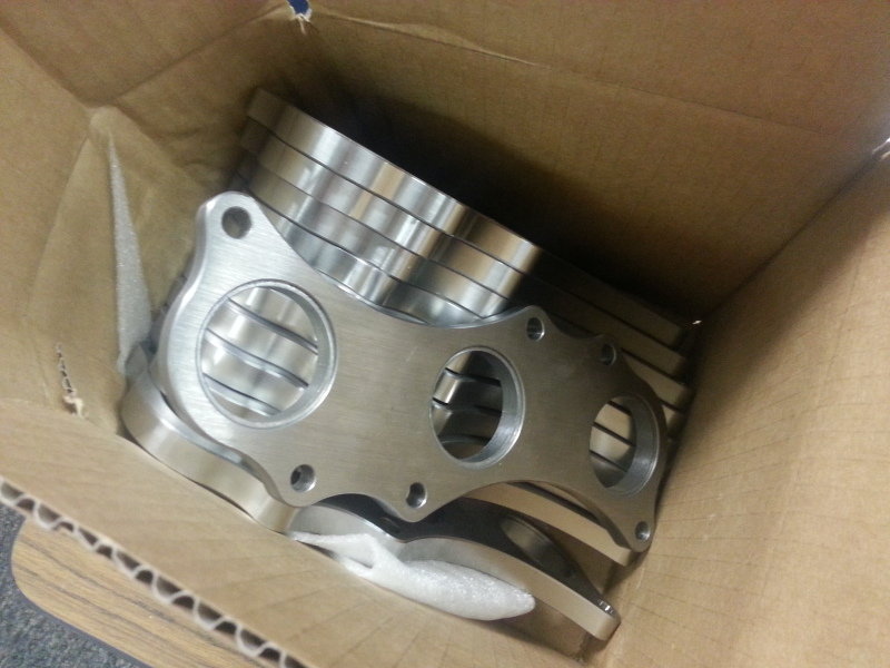

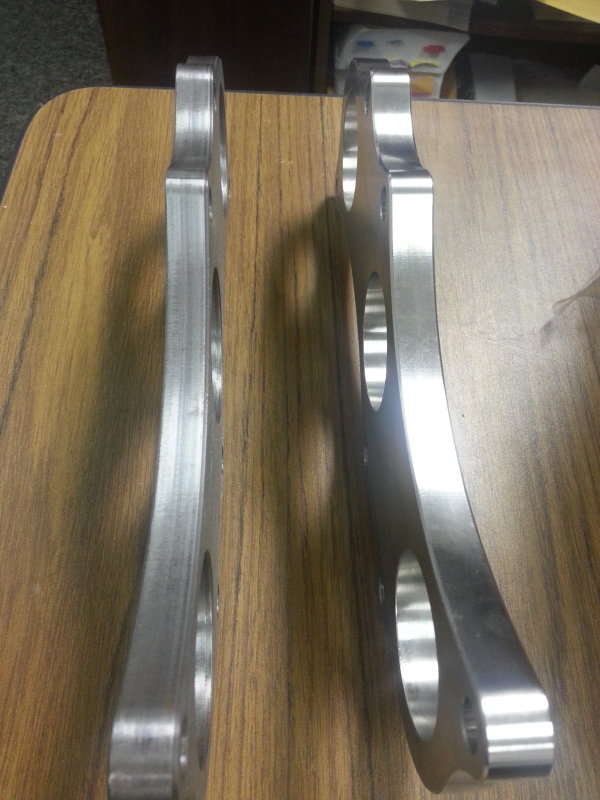

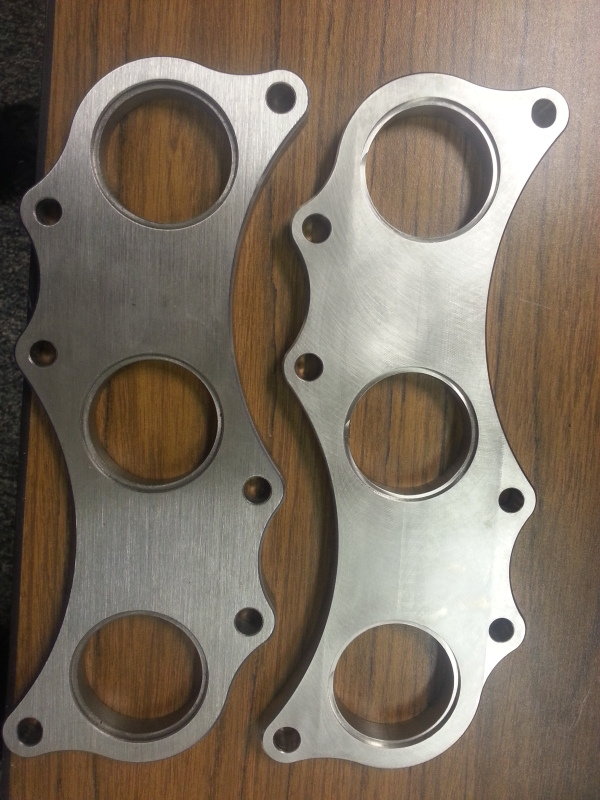

    Picked these up from Coupe yesterday. The one on top is the original mild steel flange, which was used as a template for the new 321 stainless steel flanges.
    That is right. 321 stainless steel.
    Had to make a minimum of 5 sets to get the order done. So I have spares up for grabs.
    These are designed to fit a 1 3/4" tubing for the primaries.
    I can't wait to use them on my build, that is for sure!
    The one on the right^

  15. Mar 7, 2013 at 10:45 AM
    #735

    Help me out here... :eek:
    What are those?
  16. Mar 7, 2013 at 10:48 AM
    #736
    Millertime187
    Millertime187 I'll be your huckleberry!
    Sep 25, 2012
    #87698
    1,924
    David
    Clay City, KY
    1995 Taco
    Just a few little things. It's my DD
    Header parts. What you make a custom header with.......I think

    Nice Mark, can't wait to see what you come up with for your manifolds. Going to do something similar to how Alex did them, or going with something a little more Toespeeedoo?

    This. They're flanges for building headers/exhaust manifolds (the part that bolts onto the engine block) :cool:

    What Millertime said is accurate. These can be used to make whichever style header you want. Mine will obviously be turbo style headers.
    Yup. You can actually purchase similar flanges from JBA or Doug Thorley. However, those will be made out of mild steel. These 321 flanges weren't cheap. To get my money back I have these for sale for $250 a pair. The Mild steel equivalents for our engine, through PowerFab, are about $75 a pair. Did some quick digging last night, and even what I am selling my extras for is still really cheap comparatively.
    You know me, always the innovator, and always like to do things a little different than everyone else. ;) I will be working hands on with Alex when that time comes. Just like I did with my current kit. All 321 stainless primaries as well. A little heavier, a lot stronger, and a little more expensive than 304 SS. Much more durable though.
