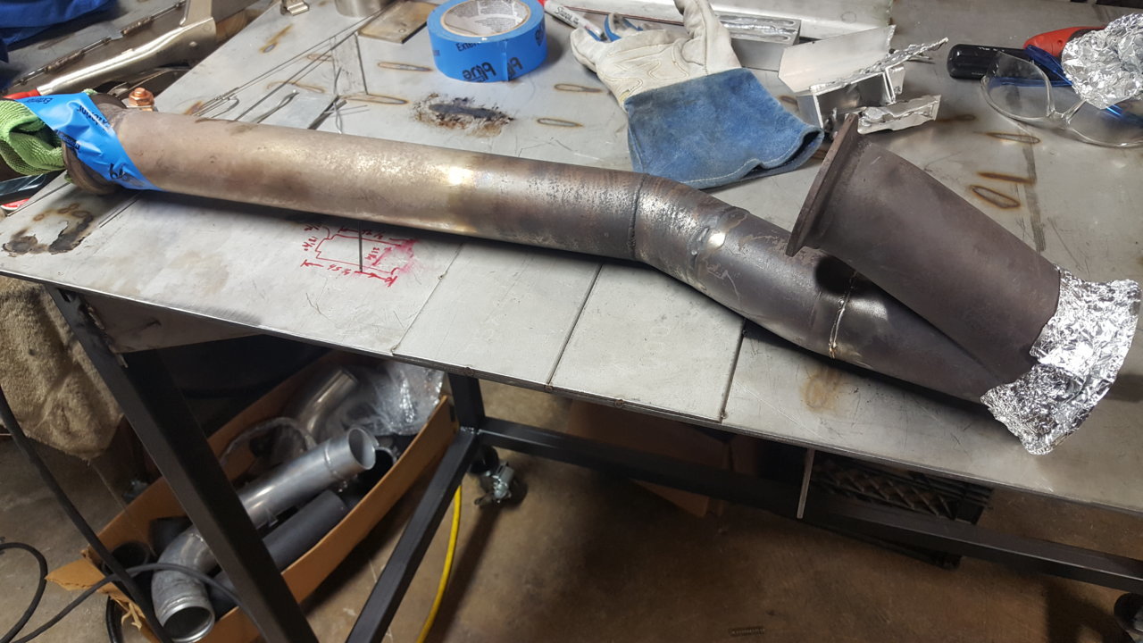

    Back purged, used 347 rod, as the tubing is 321, and made for a full penetration, and clean back side of weld. I should have gotten those pictures.

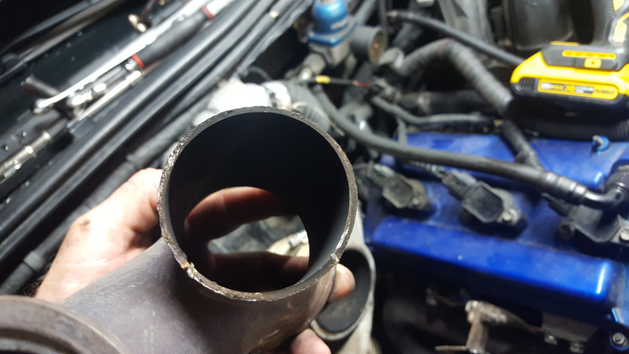

    Always. Age and an insufficient weld. It was inevitable. Had another break, years ago from the same issue.
