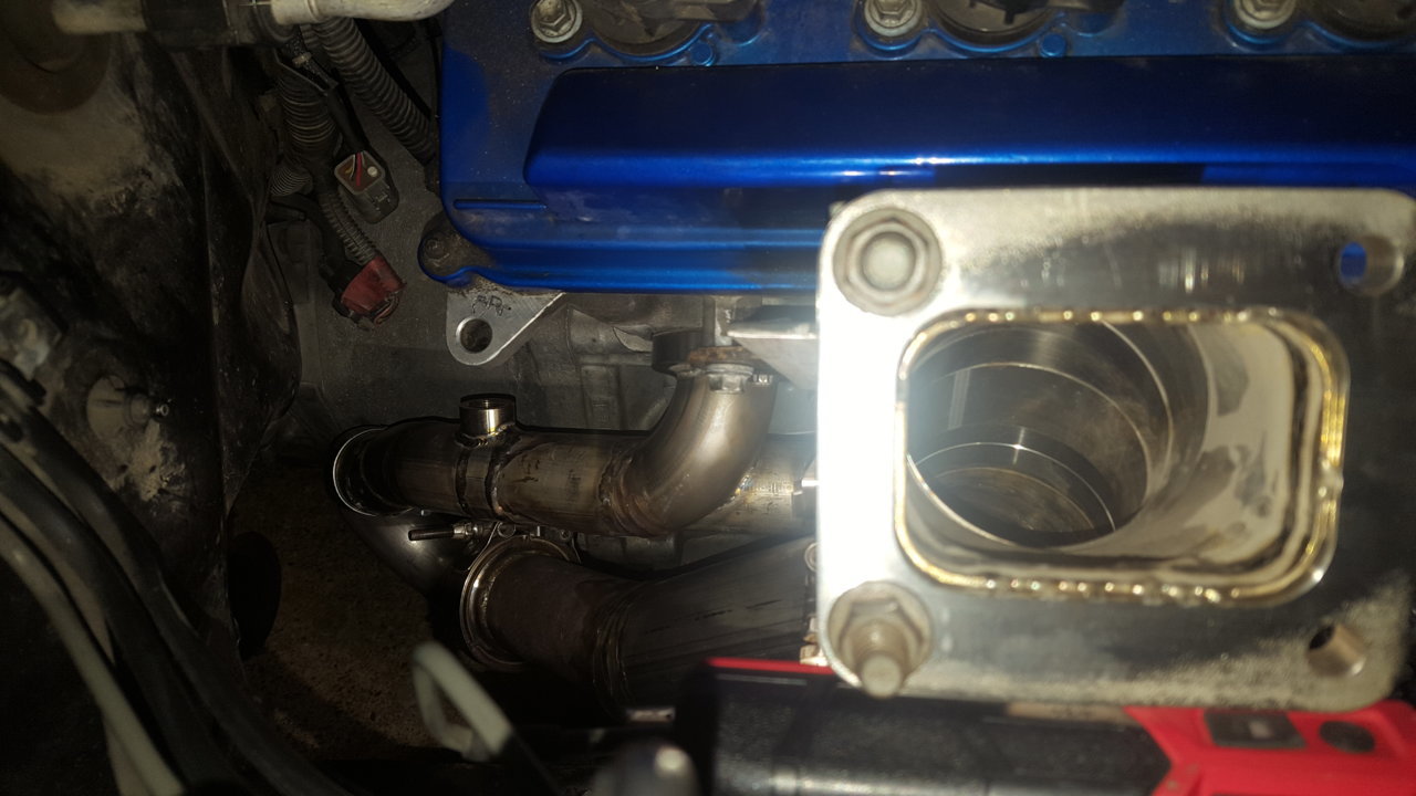

    Header into merge is completed. Not as happy as I could be, but with people coming, over time being short, and parts on hand, this is done for now. Easy enough to remove and rework in the short future. Besides, perfect when I disassemble it all to wrap everything.
    A dark picture, as it was well, dark.
    The tight radius U-bend needs to be cut in the middle, and spaced about a 1/4".
    That would give me a longer straight section to double slip, or v-band flange the tubing. We'll see.
    What I don't have shown, is the bend into the T4 flange. That is 90% welded. Then once completed, the wastegate tube can be installed. As well as down-pipe routed.

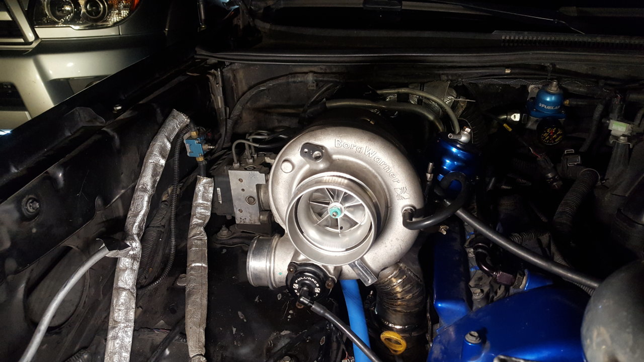

    Either @Biscuits or @loginfailed got a first startup video. Until that time, here is a smidge of eye candy.
