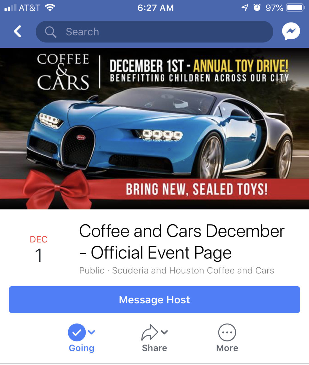

    I am quite excited to have it ready for Coffee and Cars! That's December 1st Roost. The first Saturday of every month.
    Hoping that @Lucario Runner , and @Biscuits can also make it. :fingerscrossed:

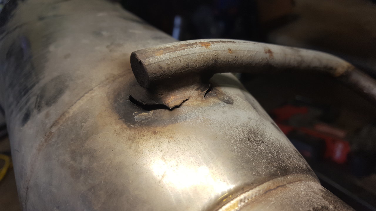

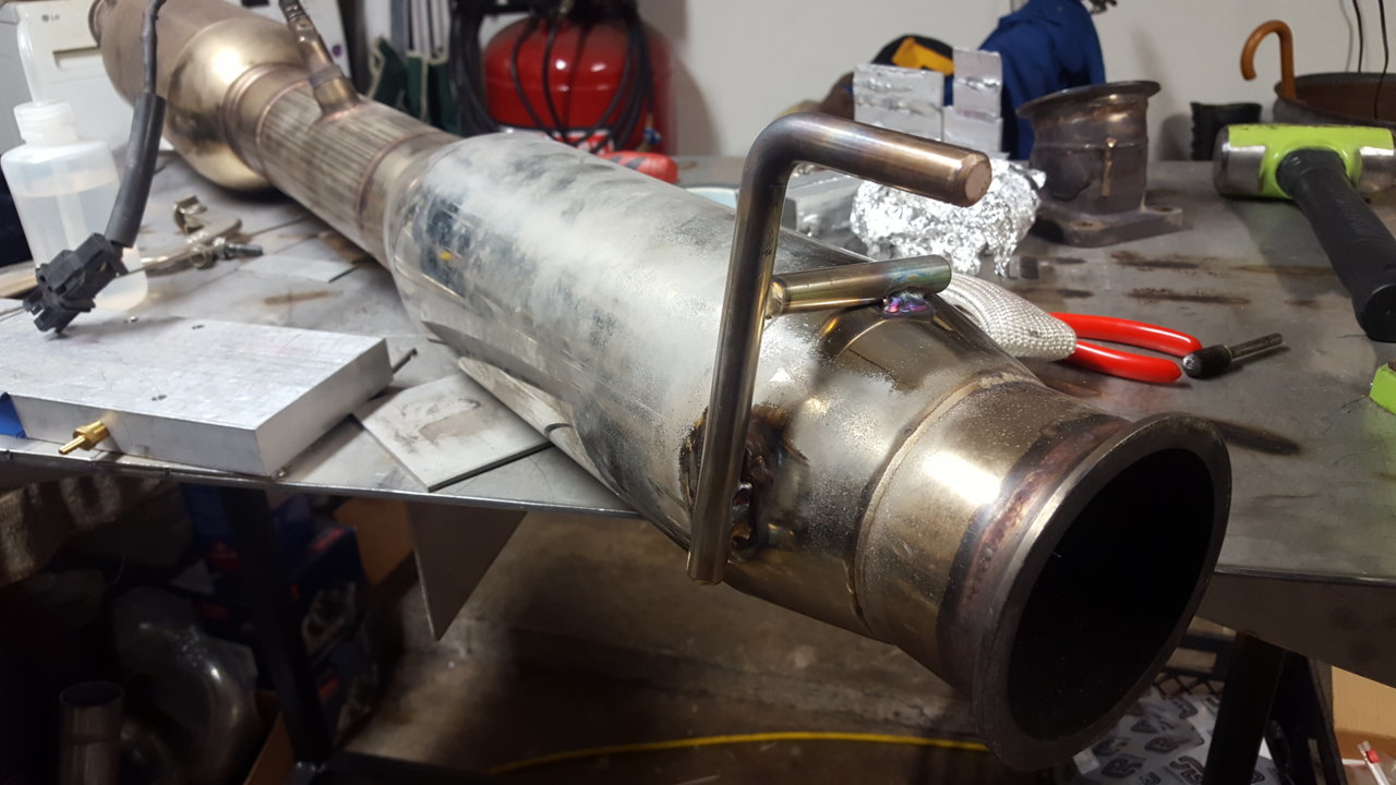

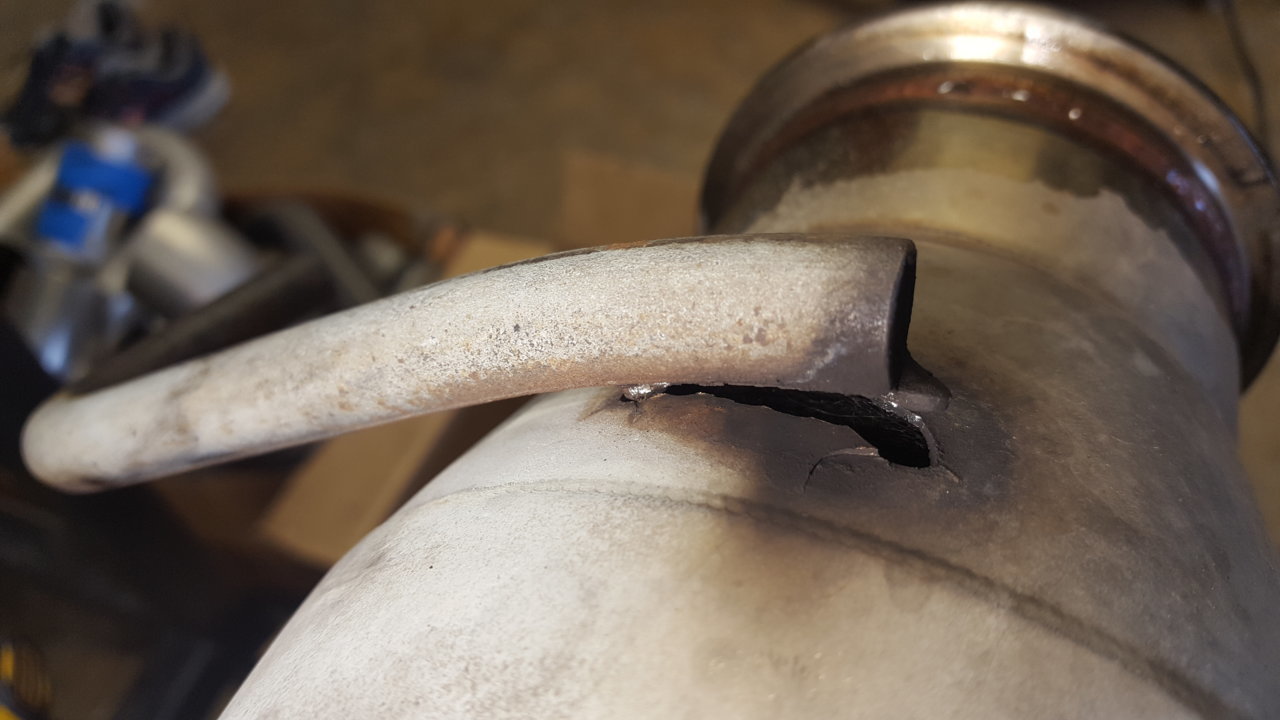

    Not enough daylight to get more finished. I did manage to get the hanger problem sorted out.
    More support, welded on both sides instead of one, and 304 stainless 1/2" rod, versus mild steel.

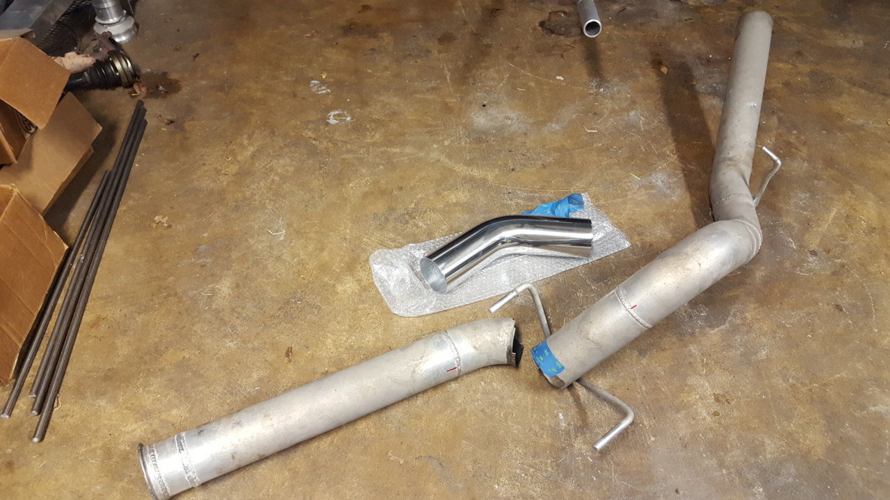

    This is all finished. Glad to have some nice throaty tunes pumping.

    Alas, the bosozuko style has been modified back to a more mundane angle. With a unique flare on the tip.......:spy:

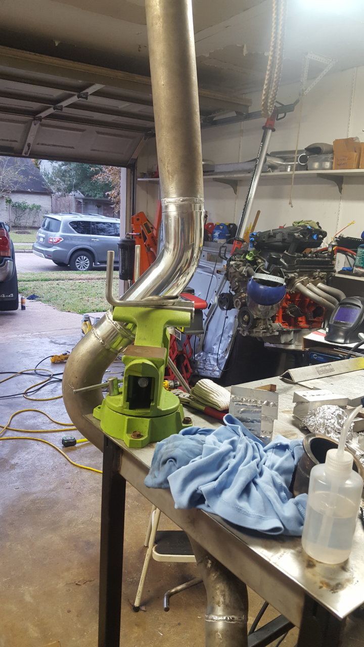

    Only been working a short while on it today, but this is all connected now. Time to TIG in the wastegate to down-pipe.
