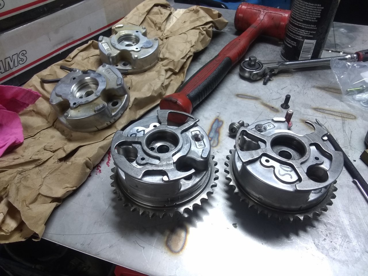

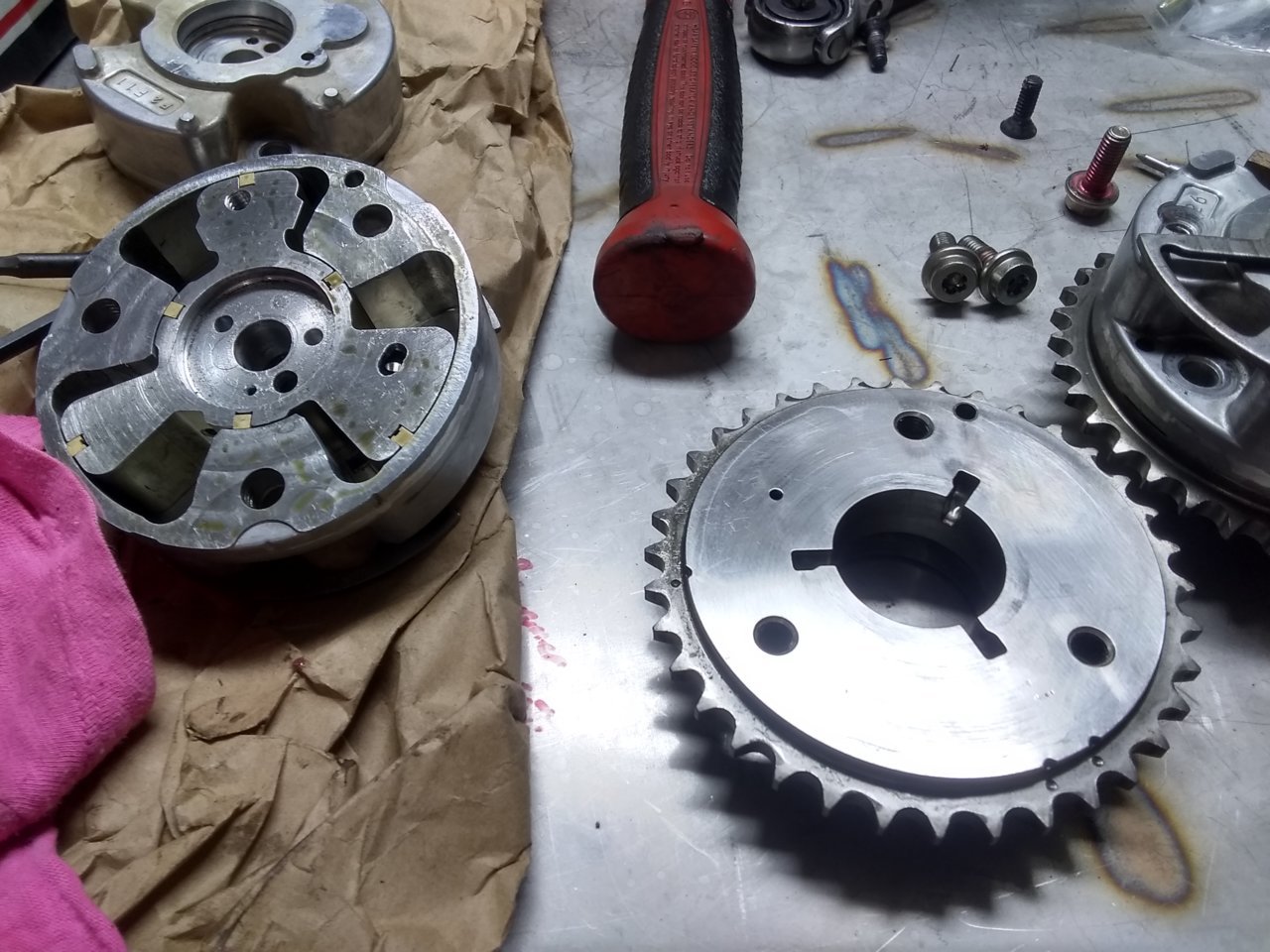

    Didn't get where I wanted to with the truck this weekend, but that is OoooKaaaayyyy. Had a blast doing hanging out. Much needed fun after that heavy few days on the GT-R and too much work. Just finished with the scavenging around and swapping over components for these intake cam gears.
    The assembled ones have screws in them to prevent phase movement. That was the original solution, before I had Kozmic Motorsports machine up solid ones.
    For those curious what the underside contains.
    Everything swapped like stock.
    Cams are already on the table next to them. Soon will be opening of the engine.

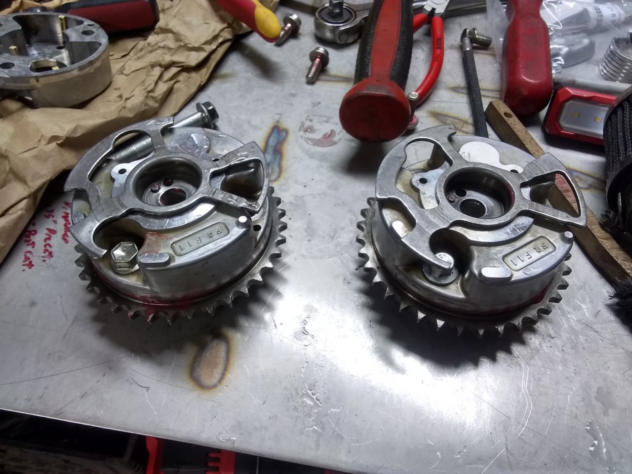

    Only was able to pick up bolts to lock the actuator halves together. At least that is done.

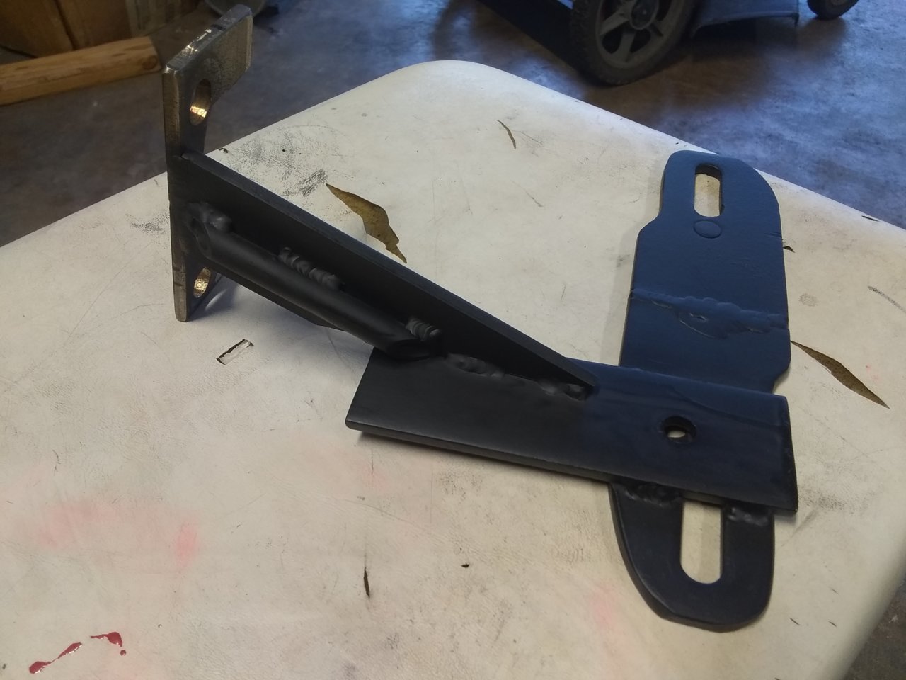

    Both brackets as one, but good eye! @Lucario Runner spotted that in text as well. More function over form, but works flawlessly. First time using a Riv-nut gun. I dig it!
    Made the relief cuts in the side supports to get the angles needed for it to sit flush with just enough tension. That is why the sides are rough with supports.

    Rust protected the support bracket with high temp enamel paint. Blah. Not the fanciest bracket, but it is stout.

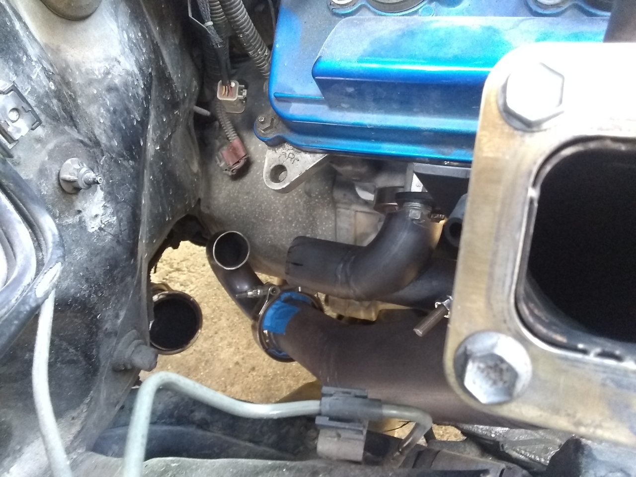

    I'll post up some pictures of what I am changing from the passenger header a little later.

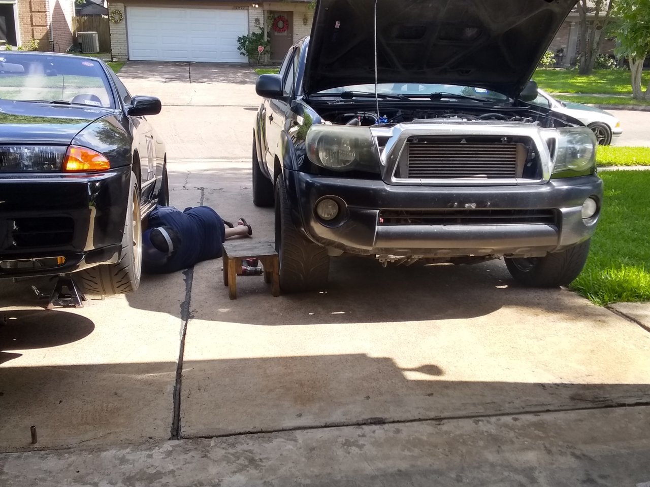

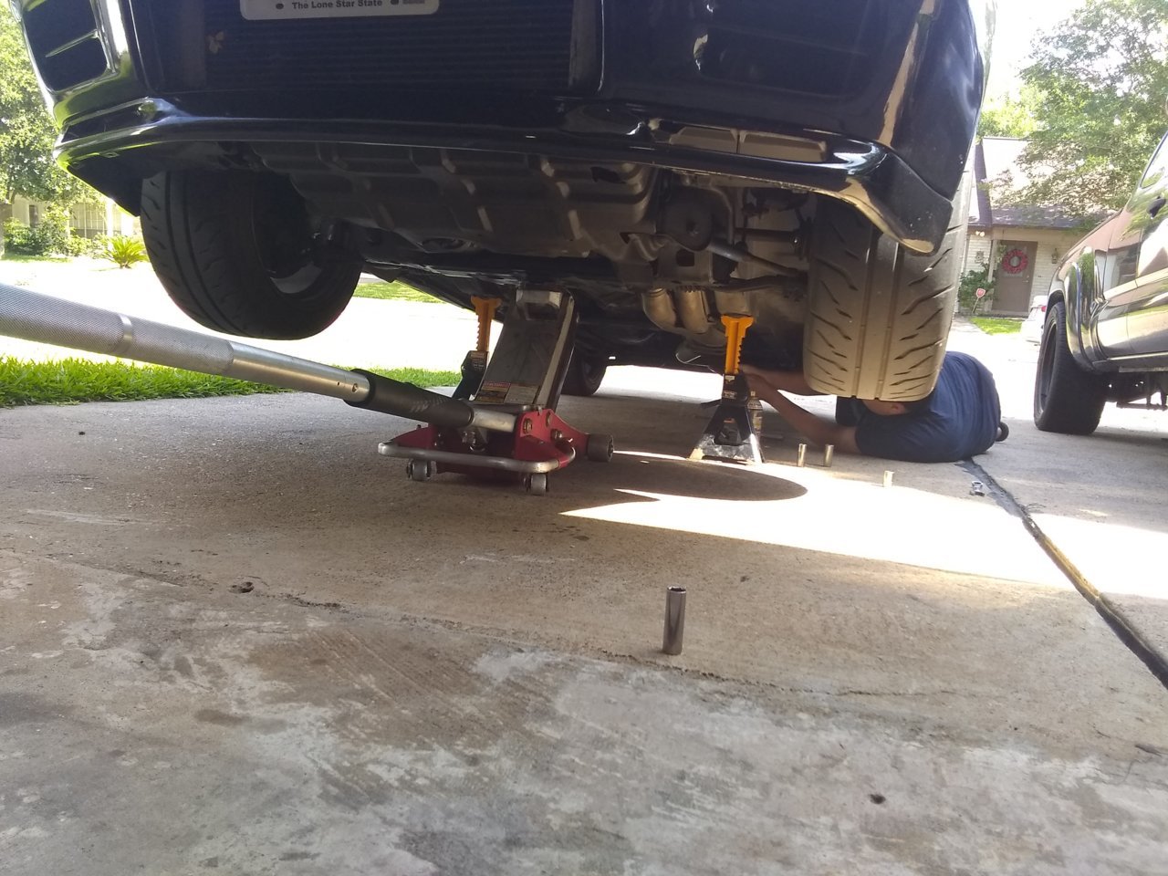

    A few other pictures from yesterday.
    IMG_20190619_163057826.jpg IMG_20190619_164410847_HDR.jpg IMG_20190619_165253764.jpg
