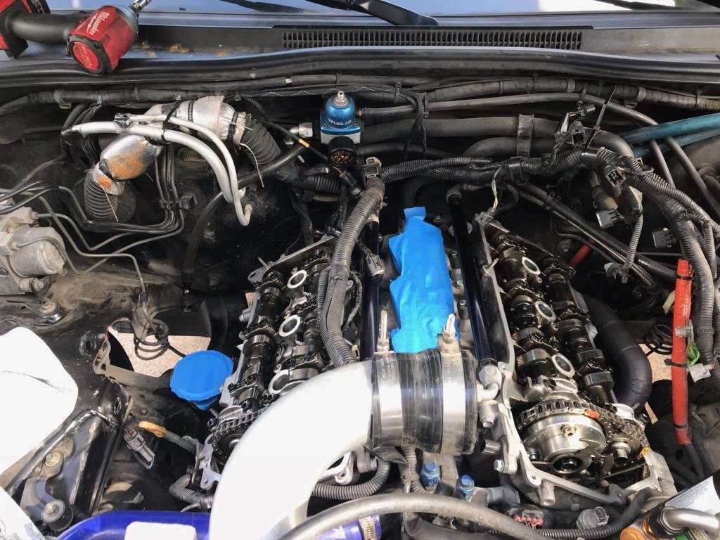

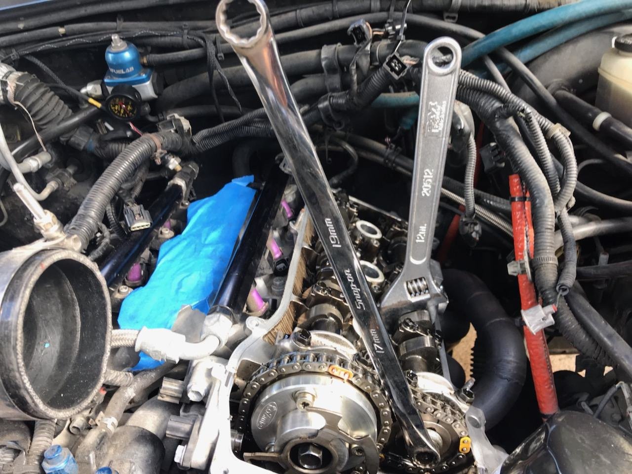

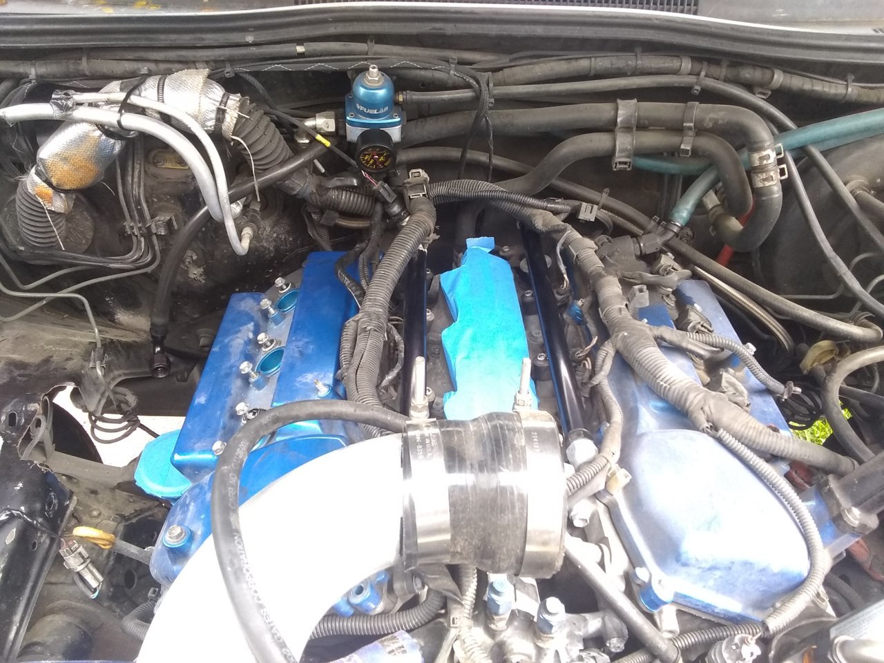

    Got this finished up yesterday. On to the cams. When the sky stops falling down. (First picture for orientation reference.)

    I like pie. :hungry:
    What is the expanded section? Slip joint?

    Endless pie. Mmmm. :hungry:
    Double slip joint. Clamp-less slip seal. What I had before, was an out of time make it happen slip joint. It leaked exhaust and through off the idle AFR's. All fixed up now. :D

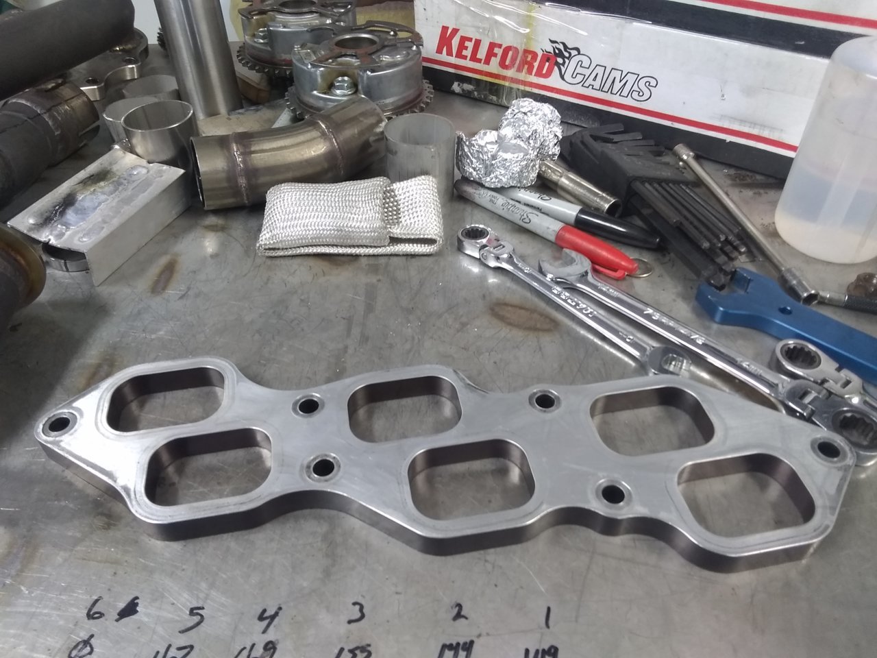

    It's started, and then it's stopped. Blasted rain. :annoyed:
    #0000001 Intake manifold spacer.

    You’re gonna mess around and get me to order a spacer, I figured it wouldn’t help in my quest but now I’m not so sure.

    Cam gears or cams, and HP Tuner first. Spacer later. Priorities man!!!

    I actually made one for @Lucario Runner . He purchased a used intake manifold. I cut the bottom off, then carefully sanded it on my belt sander. Voila! Uses the OEM gasket and reduces heat saturation from the lower (aluminum) plenum. ;)

    Ha! Great minds think alike. I was looking at the factory intake wondering if I could pull off that exact thing. I probably won’t stay NA long once I reach the top so that may be the way to go.

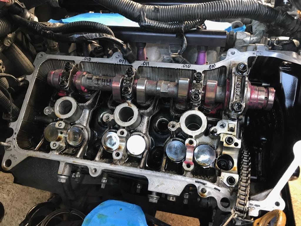

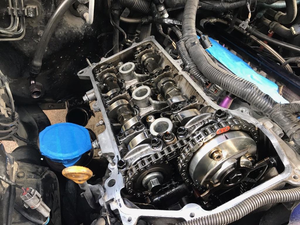

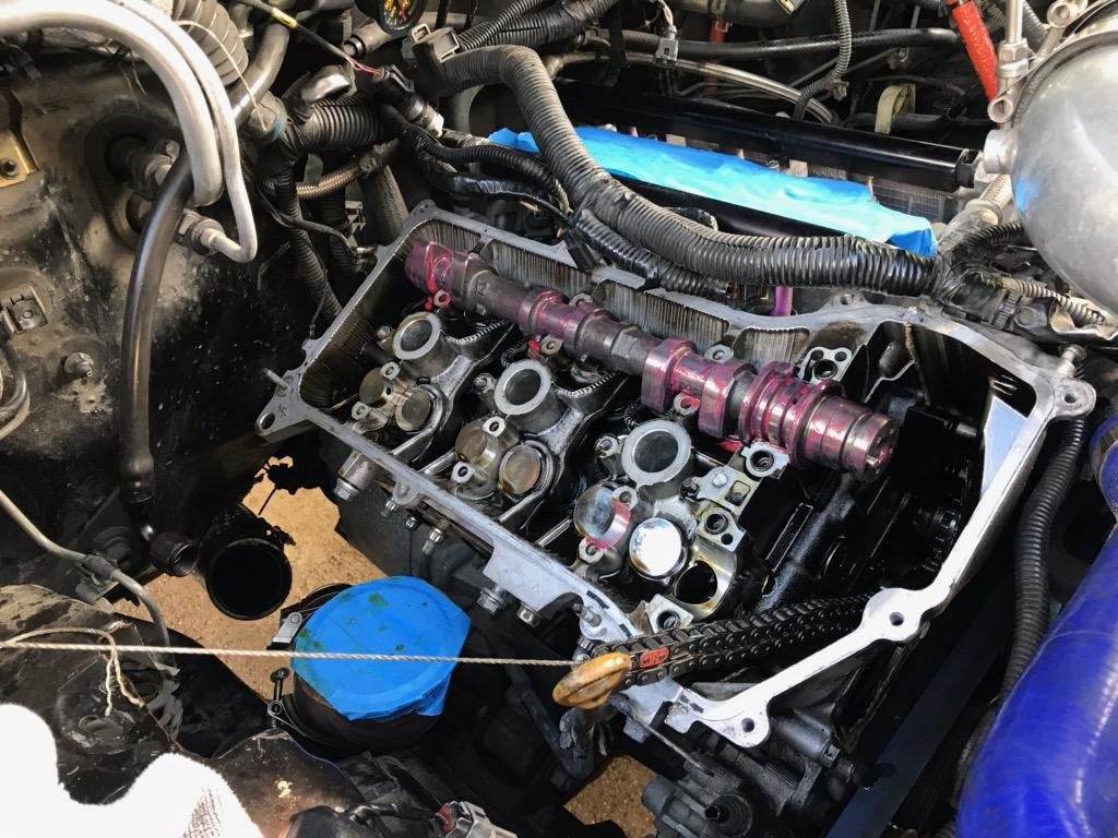

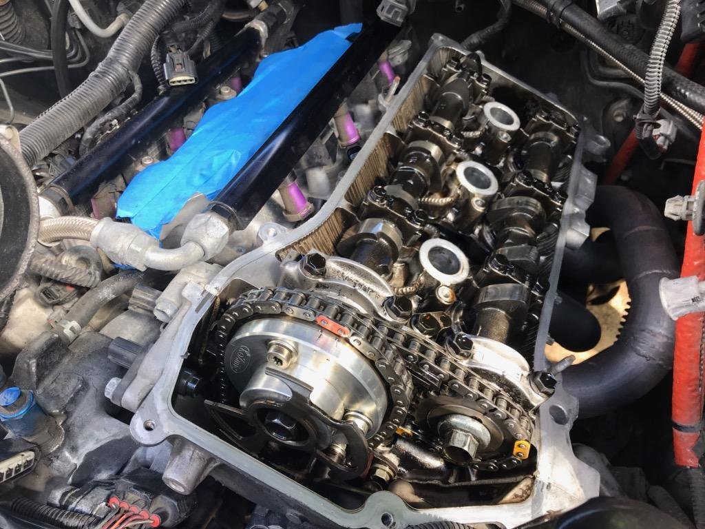

    Got the driver side cams off today. Was a little tedious but easier than anticipated. Aligned the intake links, pulled the tensioner, and easy to pull out. Having a buddy and his extra hands to hold the chain while I moved things around made it a lot easier.

    I have to pull out my spare heads and swap out the buckets to find the proper lash, then onto the other intake cam. Those first, then the exhaust.
