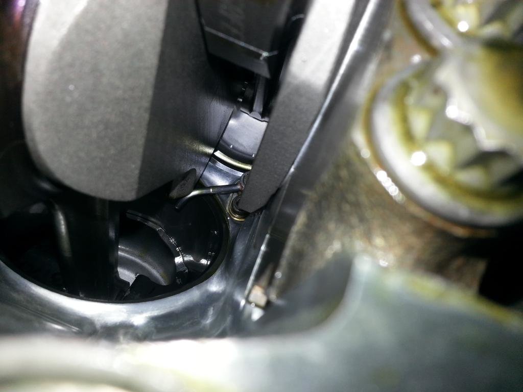

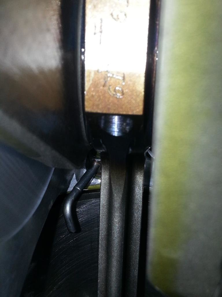

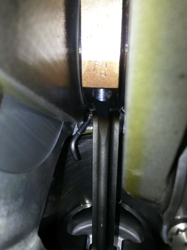

    I think I noticed you’re using Carrillo rods with the stroker motor. Did BC not have a complete kit at the time? Or was that an upgrade?
    I was imagining the rods were a one off proprietary design for the stroker crank.
  8. Aug 25, 2019 at 8:25 AM
    #7988
    Torspd
    Torspd [OP] Tor-nication
    Sep 18, 2009
    #22958
    26,445
    Tor
    The Great America!
    MMVI 4.4L 4x4 Access Cab
    Torspd Custom Turbo kit [] Borg Warner 9180EFR Turbo [] Haltech Elite 2500 [] TiAL Q BOV [] TiAL V44 Wastegate @ 15psi [] CP Pistons [] CP Carrillo Rods [] ARP Head studs [] ARP Main Studs [] ARP Header - Head Studs [] Ported Heads w/ 1mm oversized valves intake/exhaust [] Brian Crower Forged Stroker Crank [] Darton M.I.D. Sleeved Block [] Kelford Camshafts [] Torspd 160* T-stat mod [] APR Large Fuel Rail [] Walbro 460 LPH E85 Fuel Pump [] FueLab FPR [] APR T56 Conversion Kit [] KP RACING Built T56 [] McLeod Racing Custom Twin Disk Clutch [] One Piece Aluminum Driveshaft [] MGW Shifter [] Custom lowering kit [] Ohlins Front Coilovers [] QA1rear shocks [] Custom Ron Davis Radiator [] Dual SPAL Electric Fans []
    Carrillo makes them for the 1GR. The rod length doesn't change between the factory crank and stroker crank. Just the wrist pin location in the piston.
    The reason that I went with them is due to their strength and design. Plus where they are manufactured. They are rated for over 2k hp in this engine. Strongest rod bolts as well.
    There was a problem to overcome though. The shape of the rods created an interference fit with the oil squirters. That...took a loooong time to remedy. This for that.
    The BC rods do not have a that interference issue. The stroker kit was made for the 1GR. Not a mixed bag of parts.
    The CP Carrillo rods were roughly $2200.

    DMZ, ADS, King, JFR, SOS, ECGS, LSK
    Guessing this piston clearancing is a separate issue than what the CP rods required?
    Did you end up modifying the squirters?
  10. Aug 25, 2019 at 3:25 PM
    #7990
    Torspd
    Sep 18, 2009
    #22958
    26,445
    Tor
    The Great America!
    Didn't have to clearance the pistons. Bought those through BC.
    The block needed a tad a clearancing also, for these rods.
    I did. A lot of in and out, rotate assembly, check again. Took quite a few hours.

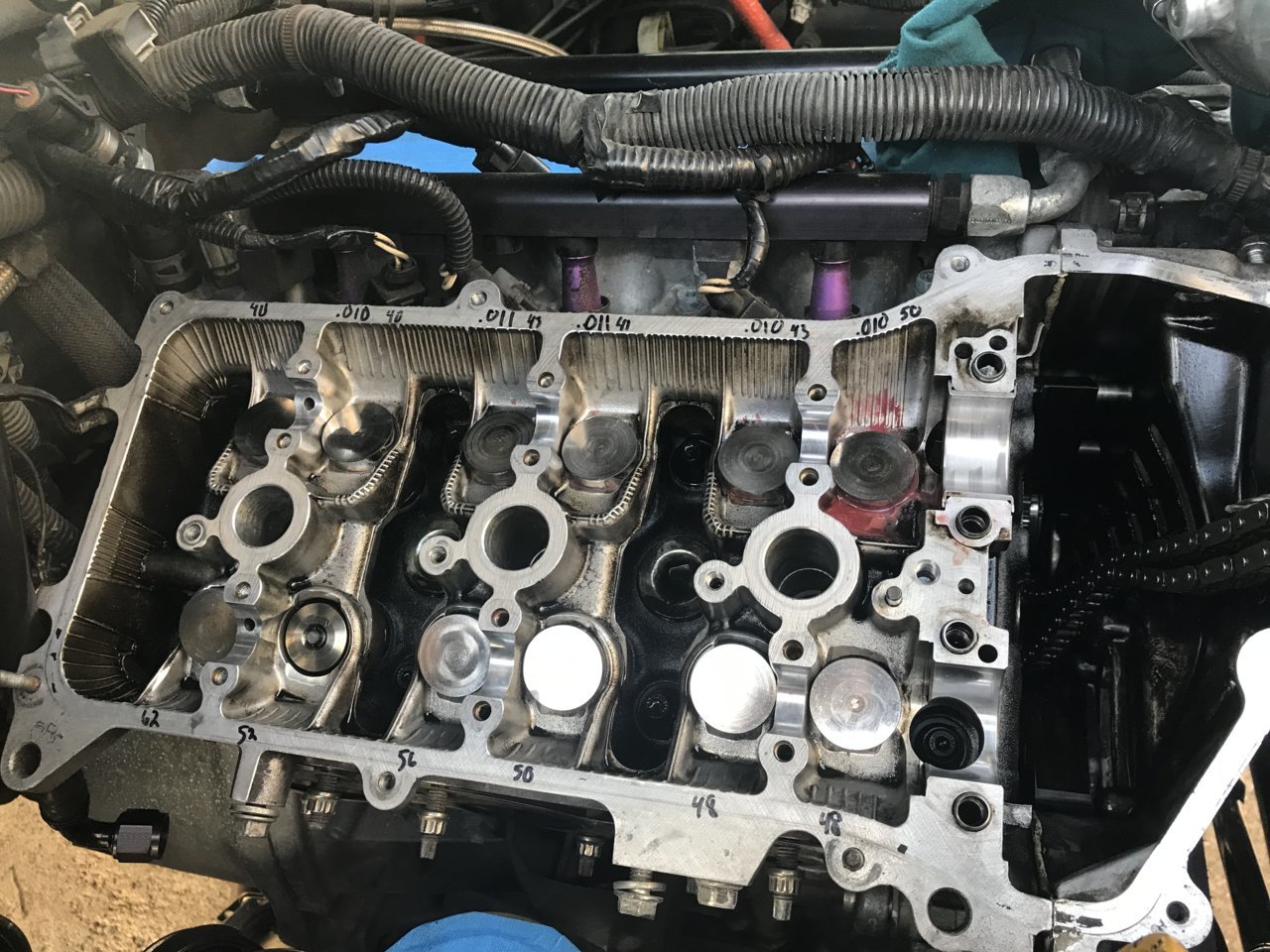

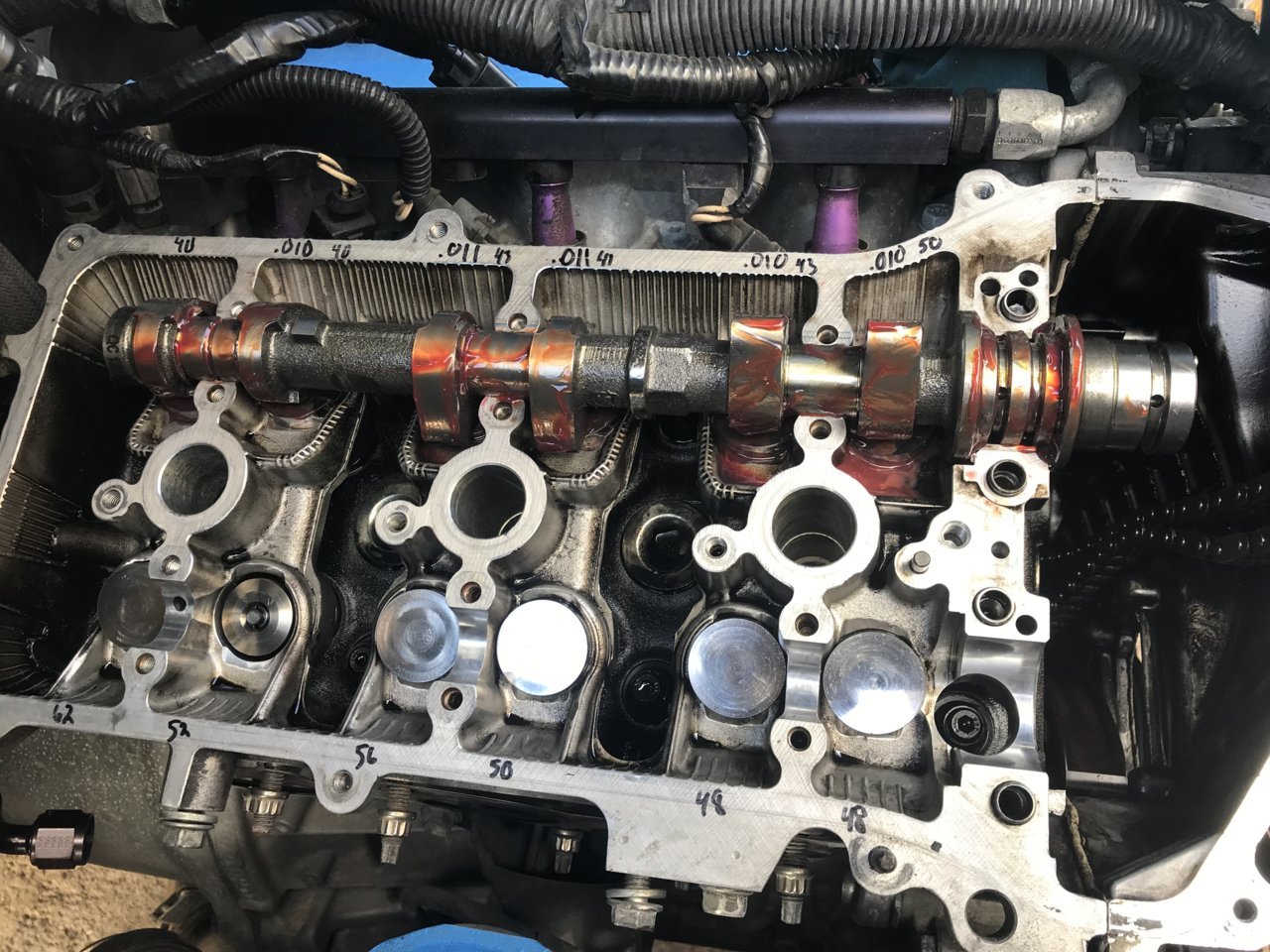

    My 1GR-FE (GTE :D) Kelford camshafts finally getting installed after too long a wait. Perfect weather and temperature for the install! Here are the cam specs for all future travelers. :thumbsup:
    14FB7EE0-B916-46B5-8EBB-B20C89987E0C.jpg 73A82C40-448B-407D-BC67-75CEB6608AB7.jpg

    By the looks of the harnesses still attached I’m assuming the motor in in the engine bay?

    I was thinking the same thing!

    That's correct
