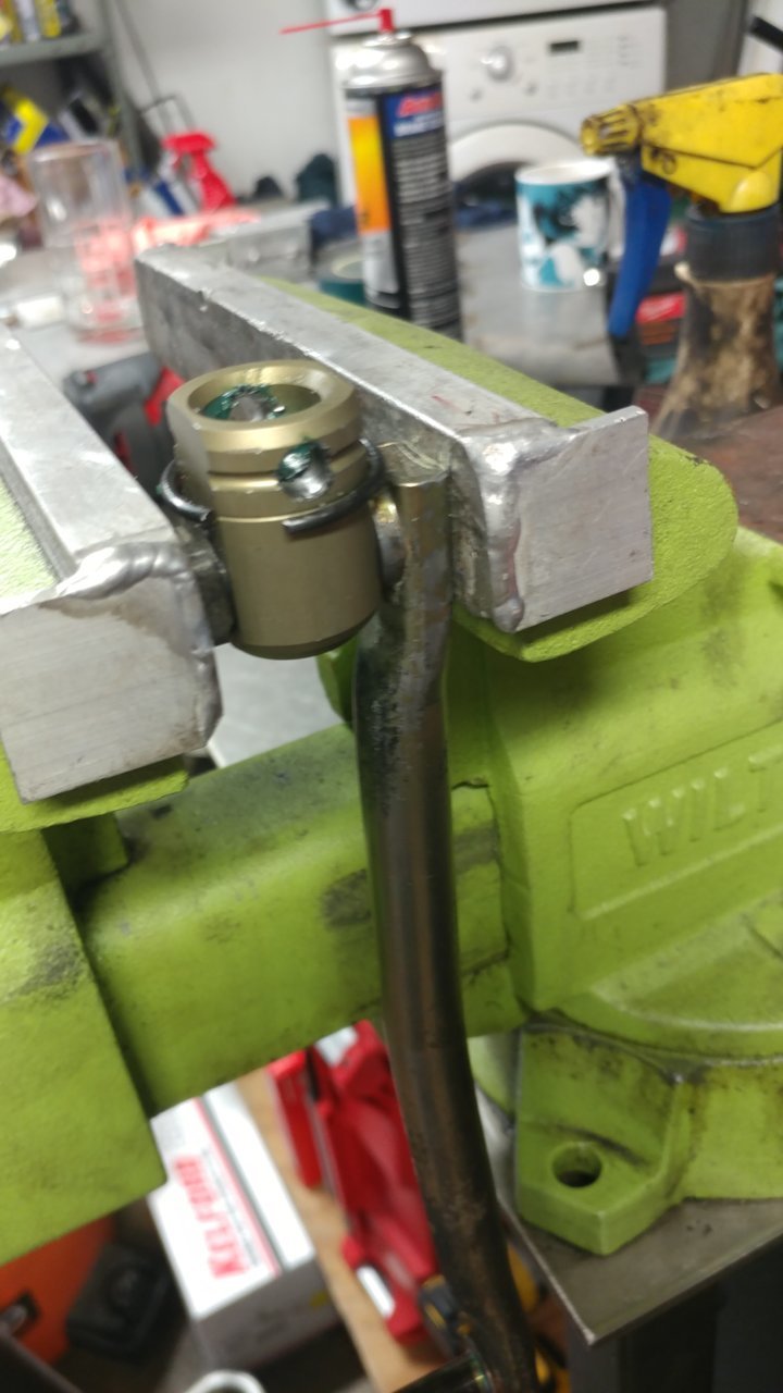

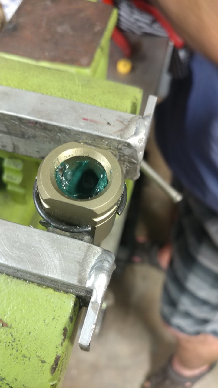

    Had to enlarge the id of this to get an oem pin in.
