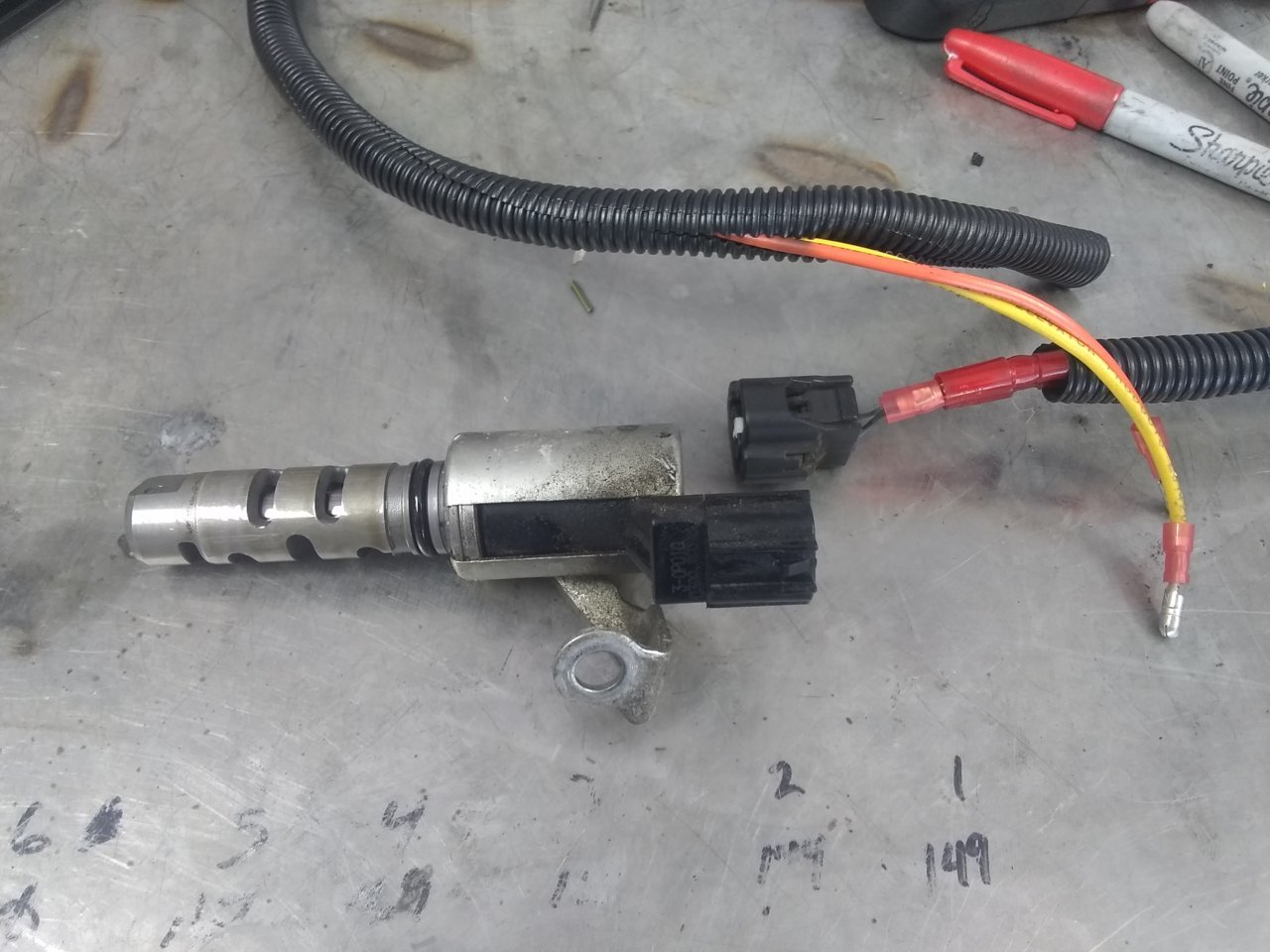

    Made a handy test device to test the solenoids today. This way I was capable of testing known good solenoids to compare to the ones in the engine.

    Holy crap!

    Got my proofs. Then testing the ones on the engine. Both with the engine off, then with the engine running. While watching the cam angles of both banks, I would pulse the solenoids directly to the battery. No change on the computer and no change in engine noise.
    Suspicions confirmed and actuators are stuck in place.

    Yup. That was one of the test procedures. Engine idling, activate each solenoid with my jumper wire. Clear and audible clunking sound when it would change states. No engine change. No angle change witnessed on the laptop. Held revs at 3k, and repeated. No change again.
    Having to re-bolt together the clover to the gear without a know torque spec could be the cause. Having sat for so long in a box could be the cause. Who knows. New ones ordered from Rock Auto with a discount code. A lengthy process in my near future, but worth it.
