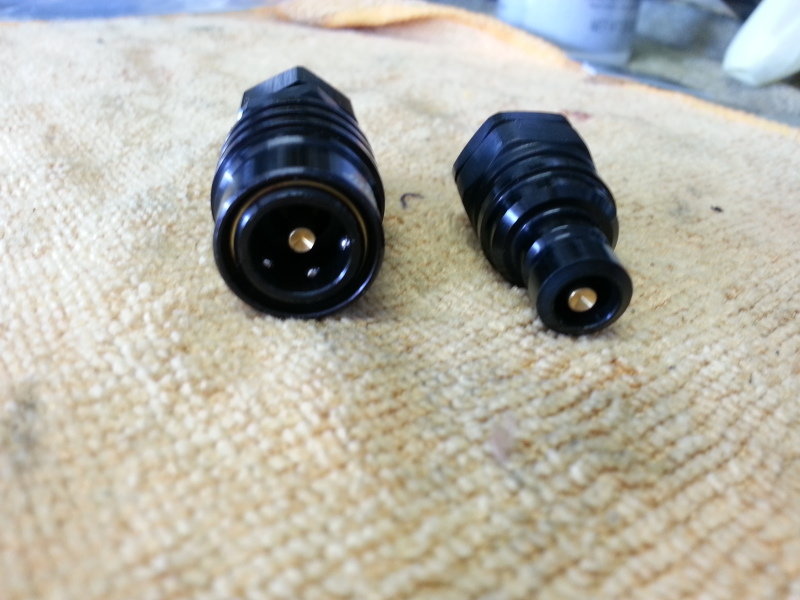

    Also, the other half to my Jiffy-Tite quick disconnect fitting for the clutch came in yesterday. So that will be going on today. Hopefully I can fix this issue in about 30 minutes time today. Hopefully.

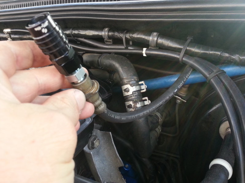

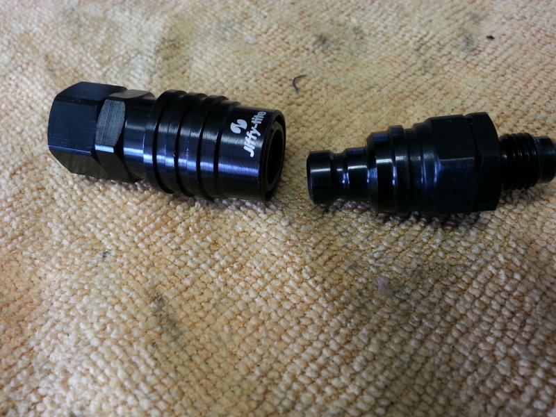

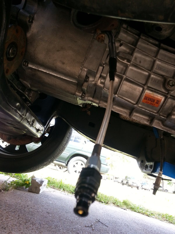

    The Jiffy-Tite quick disconnect for the clutch line.

    i wonder if those jiffy fittings would work for brakes?
  9. Mar 22, 2013 at 5:47 AM
    #809
    Torspd
    Torspd [OP] Tor-nication
    Sep 18, 2009
    #22958
    26,344
    Tor
    The Great America!
    MMVI 4.4L 4x4 Access Cab
    Torspd Custom Turbo kit [] Borg Warner 9180EFR Turbo [] Haltech Elite 2500 [] TiAL Q BOV [] TiAL V44 Wastegate @ 15psi [] CP Pistons [] CP Carrillo Rods [] ARP Head studs [] ARP Main Studs [] ARP Header - Head Studs [] Ported Heads w/ 1mm oversized valves intake/exhaust [] Brian Crower Forged Stroker Crank [] Darton M.I.D. Sleeved Block [] Kelford Camshafts [] Torspd 160* T-stat mod [] APR Large Fuel Rail [] Walbro 460 LPH E85 Fuel Pump [] FueLab FPR [] APR T56 Conversion Kit [] KP RACING Built T56 [] McLeod Racing Custom Twin Disk Clutch [] One Piece Aluminum Driveshaft [] MGW Shifter [] Custom lowering kit [] Ohlins Front Coilovers [] QA1rear shocks [] Custom Ron Davis Radiator [] Dual SPAL Electric Fans []
    Yes. These are specific to brake fluids. I used the builder in the link to find the proper fittings, then ordered them. Paul at Dezod said that he can get them.
    http://motorsports.jiffy-tite.com/fittings#.UUxQ_KNOkb0
    So you could do all quick disconnects for all brakes, if you wanted.

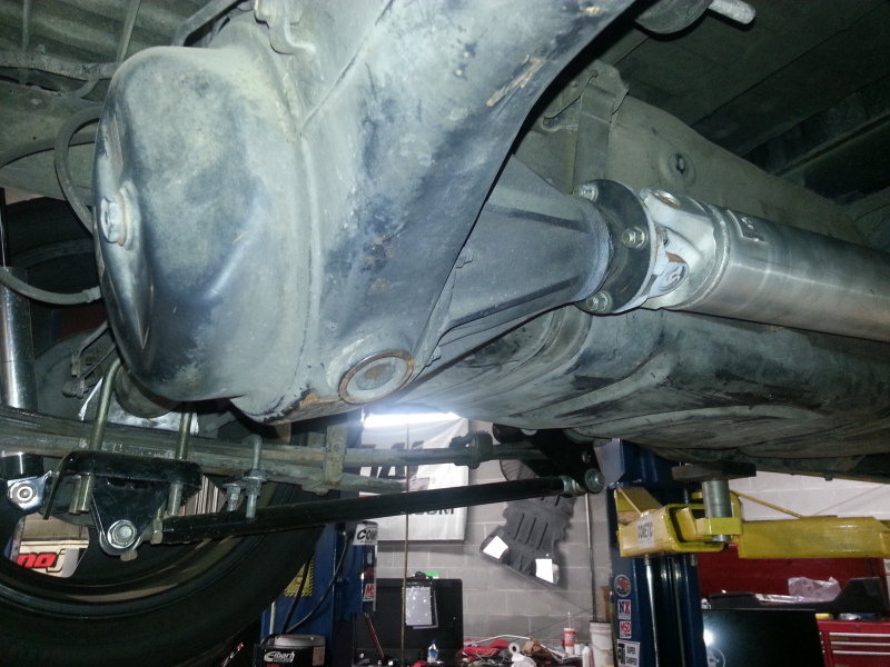

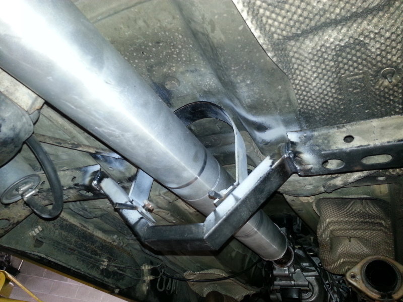

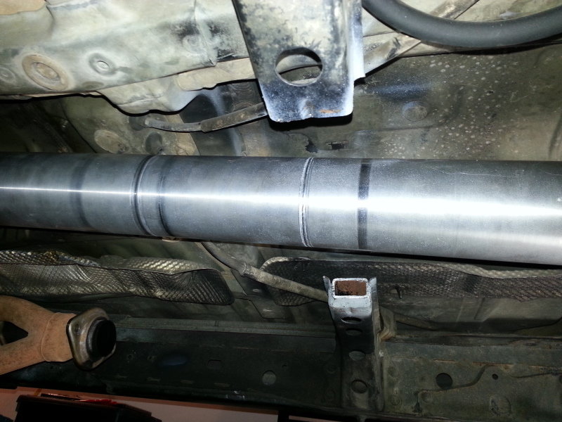

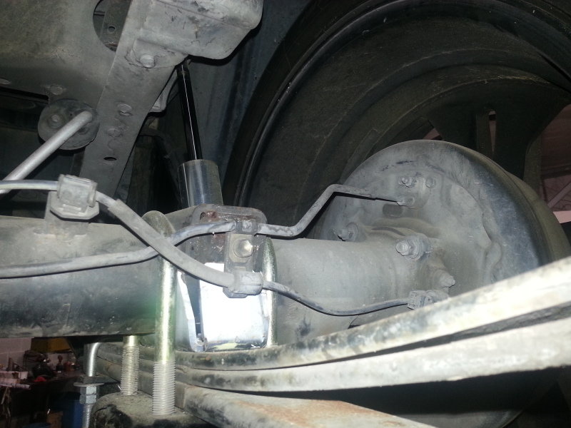

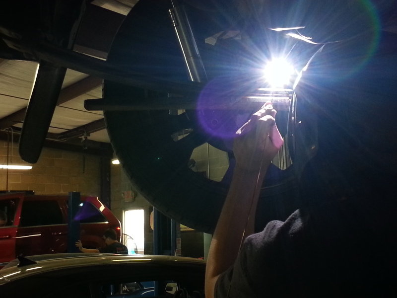

    During the first test drive, a couple problems presented thsmselves. Although, I was already under the idea that they very likely would anyway. So I had to schedule an appointment at PowerFab for some work.
    Last Friday night, the 22nd of March, I got to work in Britt's garage. That is where the truck had to stay until I could make it driveable to get to PowerFab on Saturday morning. I had to cut out this cross member(which was already custom) and move the ebrake lines a little.
    Slashaar likes this.

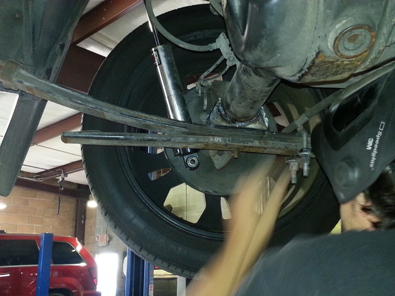

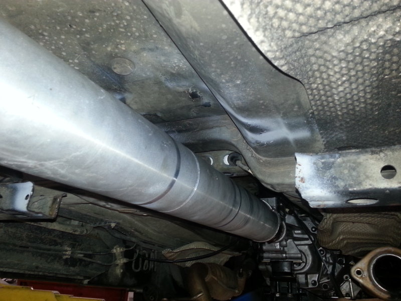

    Here is what it looked like after the first time that I had the crossmember modded. For reference.
    Due to the new low, it just needed to be flipped over.
    Here you can see where I had to slot the area where the brake lines came through the cab. As one cable was juuuuuuust rubbing.
    The axle also had rotated upward a slight bit, due to the axle perches flex, and not being welded on. Which was something that I knew had to be done anyway. A little spirited shifting by a test driver, brought it to light sooner than expected though. ;) It was all good though. No real harm was done.
    So Alex welded it all back up for me, and it is good to go now.

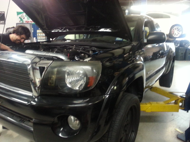

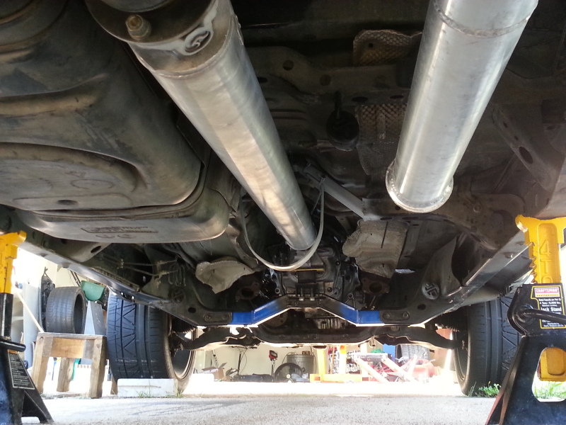

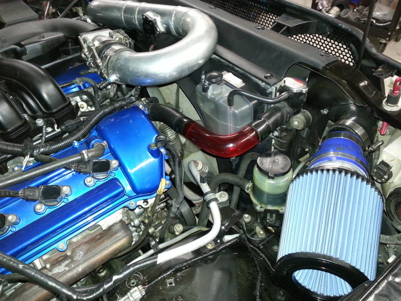

    And lastly....my hot air intake. Intercooler. Haha
