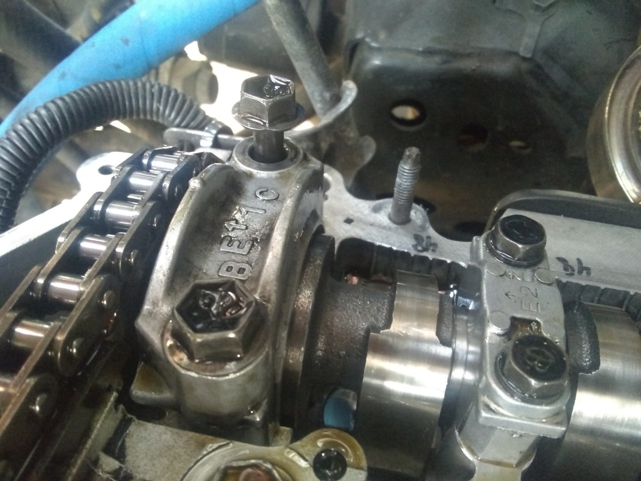

    Going to start tearing into the engine to do the cam gears swaps later this week. Fingers crossed as well and legs and feet, (that's a strange contortionist image...) that they solve the issue with not phasing properly.

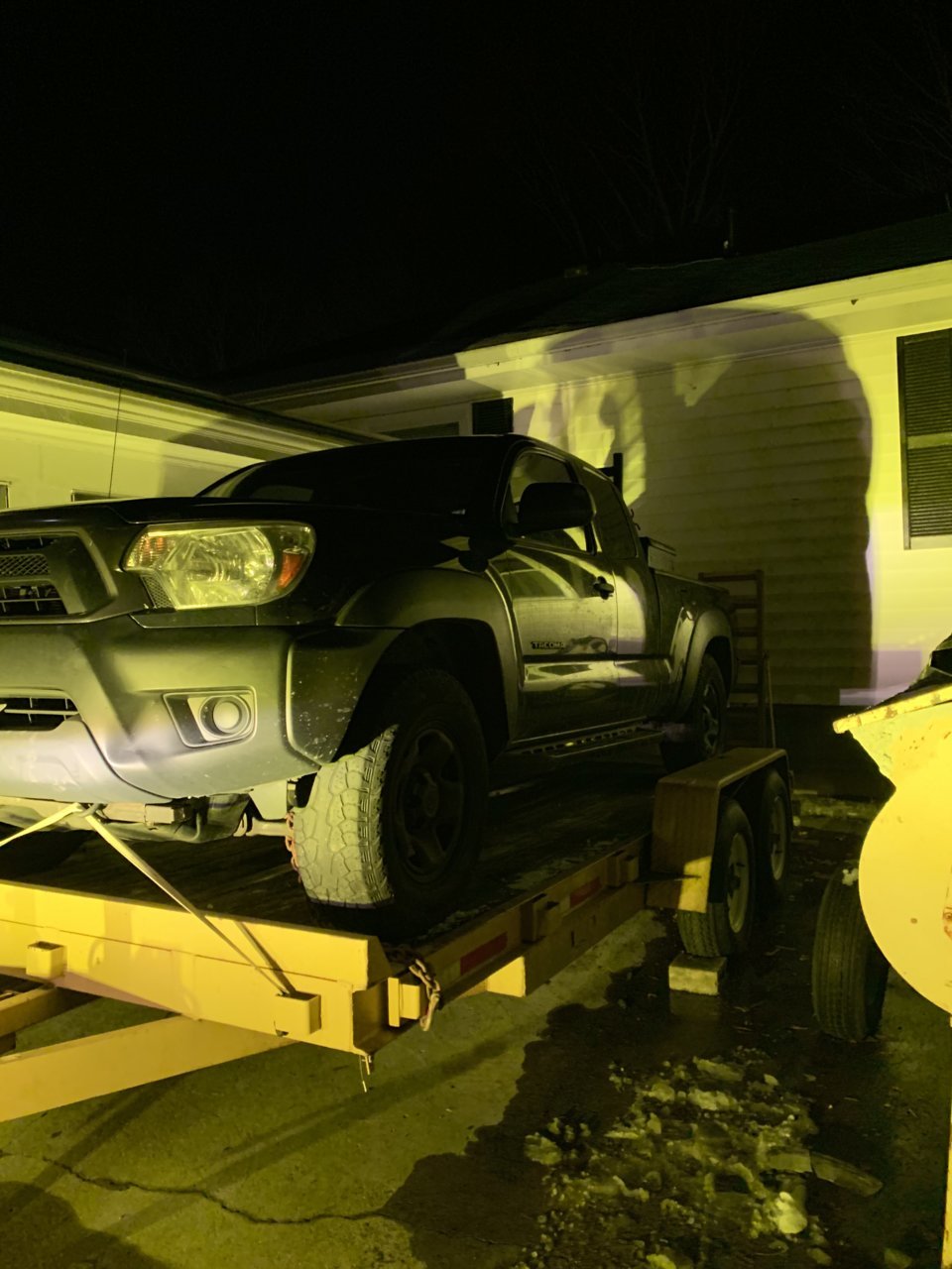

    Scored this taco with a smoked motor for a song gonna flip it to help support the addiction on my taco

    Nice!

    Nice little update. Got the new actuators in. With only one small issue. Had a Roadkill moment. Thankfully my after thoughts haunted me.
    Passenger side, exhaust cam cap was loose. Luckily there was no scoring. Tighten back up and dodged a bullet. Phew.
    Could hear them knocking around until they filled with oil. Then they quieted to normal. All was well. Then I encountered the tail chasing hunt of getting no where positive with the value changes for cam phase angle. Only one would somewhat move and the other didn't have barely flicker a movement. Devil was in the details, as they say.
    All sorts of different methods of testing. Finally came back around to using the values of a 2003 Lexus IS300. Exact same VVTi oil control solenoid. Instant gratification!
    Threw together a ten minute tune and I am quite a bit happier with the low end results. Not ecstatic yet, but happier. Just needs some quality seat and datalogging time.

    Why do you think that cap came loose? Just one that wasn’t torqued down? I was careful to check and re check all my torques...

    The usual. Limited time and rushing. I had just forgotten to torque it. Usually I leave the bolts visually loose. That time I had hand threaded them all the way down. Cam didn't shift out of place, nor bind. Unbelievably fortunate.

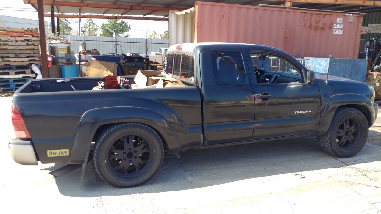

    Putting in work.

    ...and getting there and back REALLY fast...

    Payload was 1500lbs

    That fat azz can move! At a snail's pace. ;)
