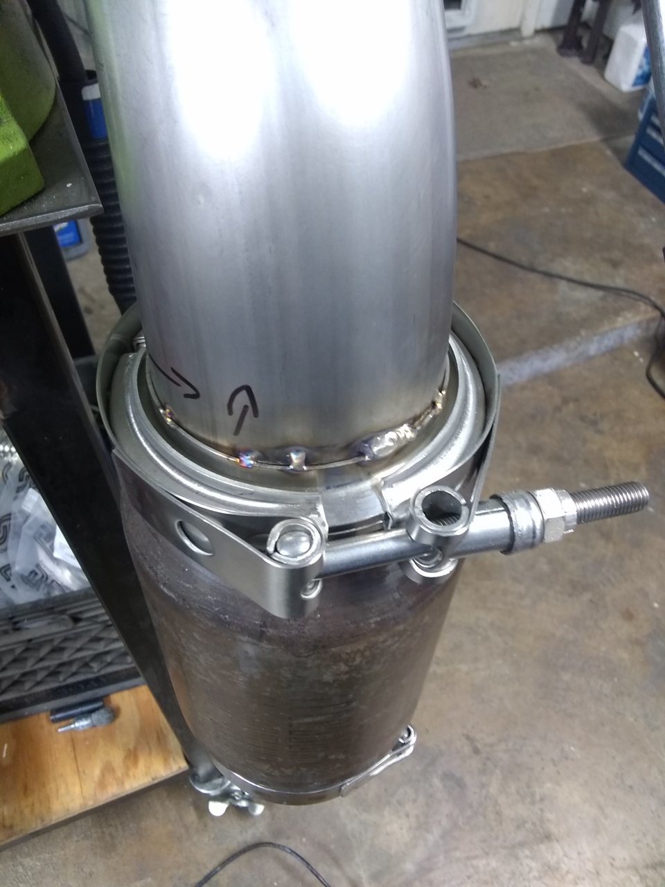

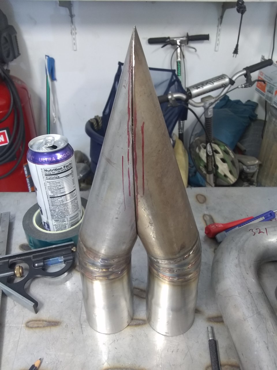

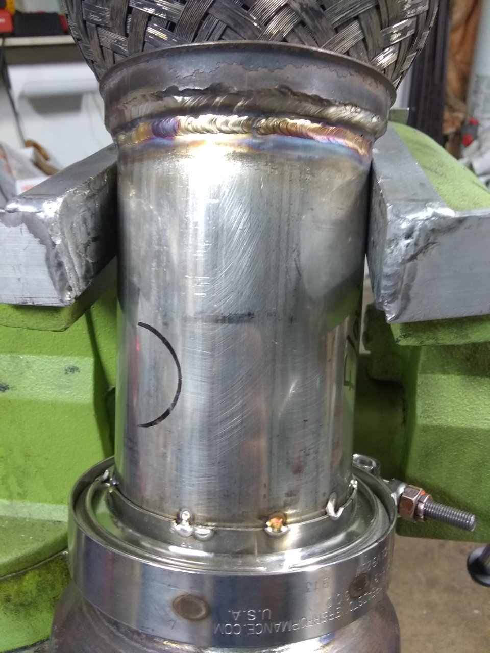

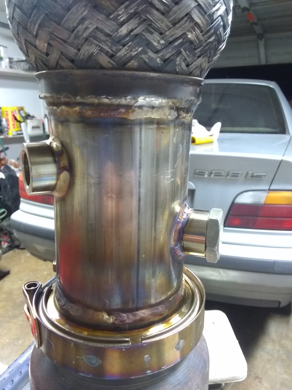

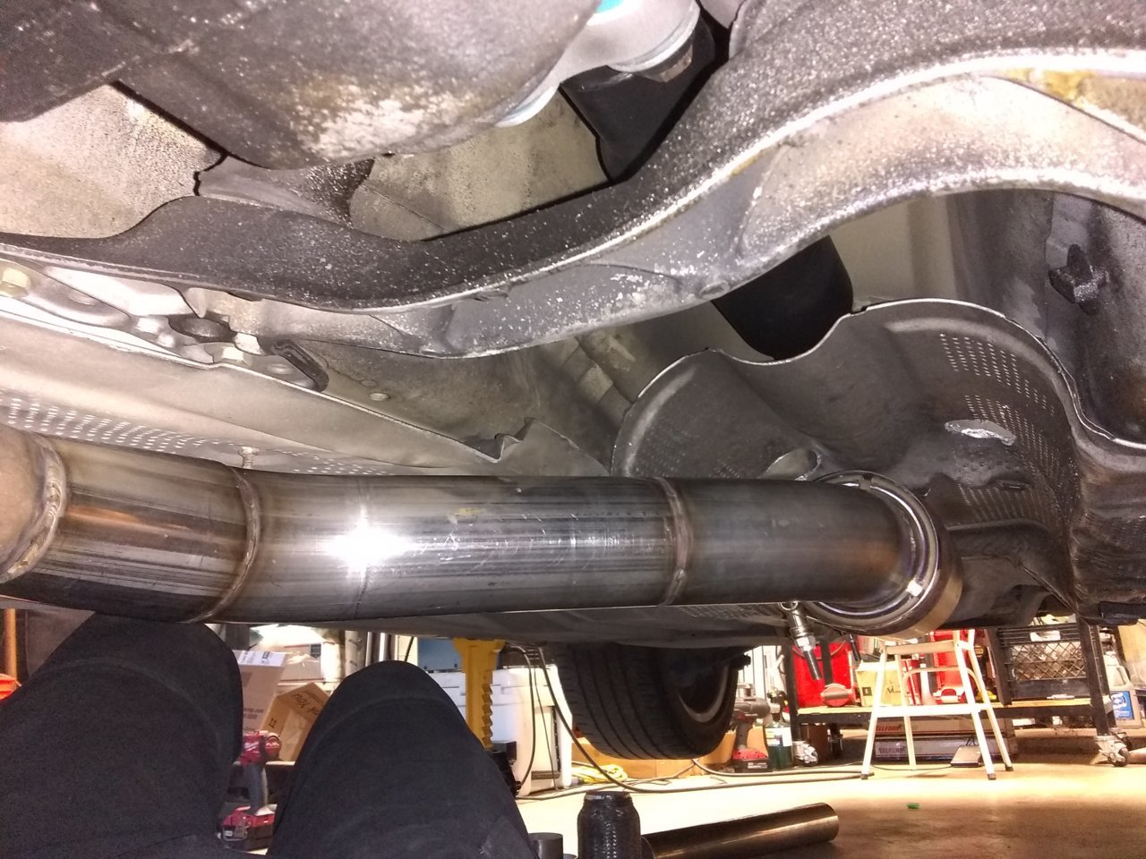

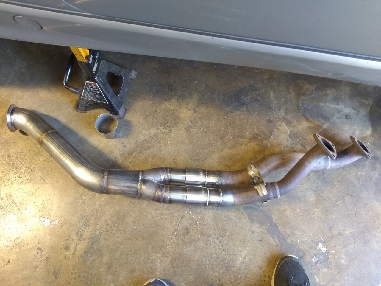

    Working on my Bimmer's exhaust. Getting close. Once done, then onto the reconfigured Taco exhaust. That will be a lot of fun.
    IMG_20200501_125455835.jpg IMG_20200501_202710018.jpg IMG_20200503_140933811.jpg IMG_20200503_150713179.jpg

    I’m not familiar with the build in your BMW, what’s the bungs for?

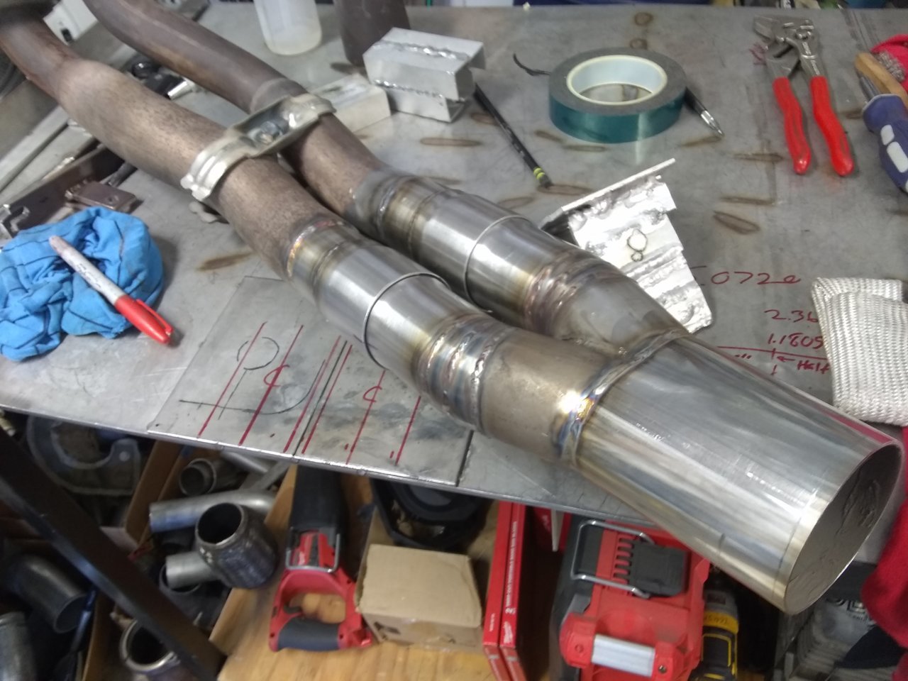

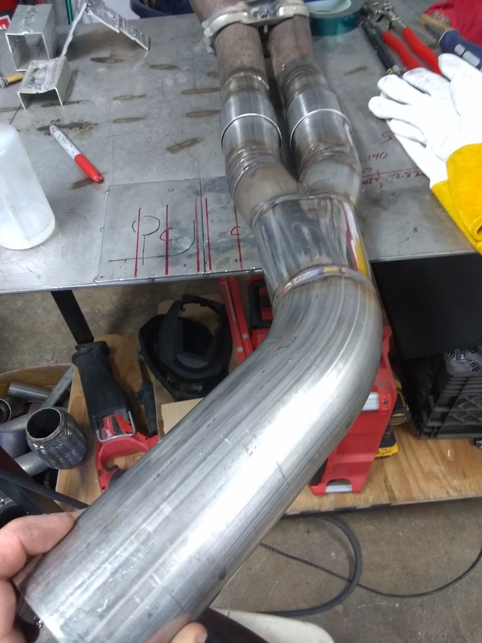

    Those are post catalytic converter bungs. Originally, the exhaust was dual, with a sensor in each leg, post each cat. I am upgrading mine for a future turbo build. Thus the single 3" tubing.
    The OEM exhaust also had zero flex couplings. Fail.

    Gotcha, love seeing people fab their own stuff. You’ve got some nice welds going.

    Thank you! Had desire; now have a skill.
