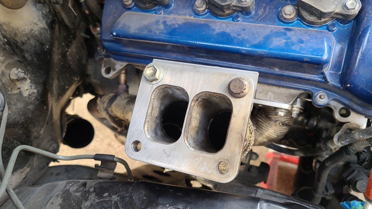

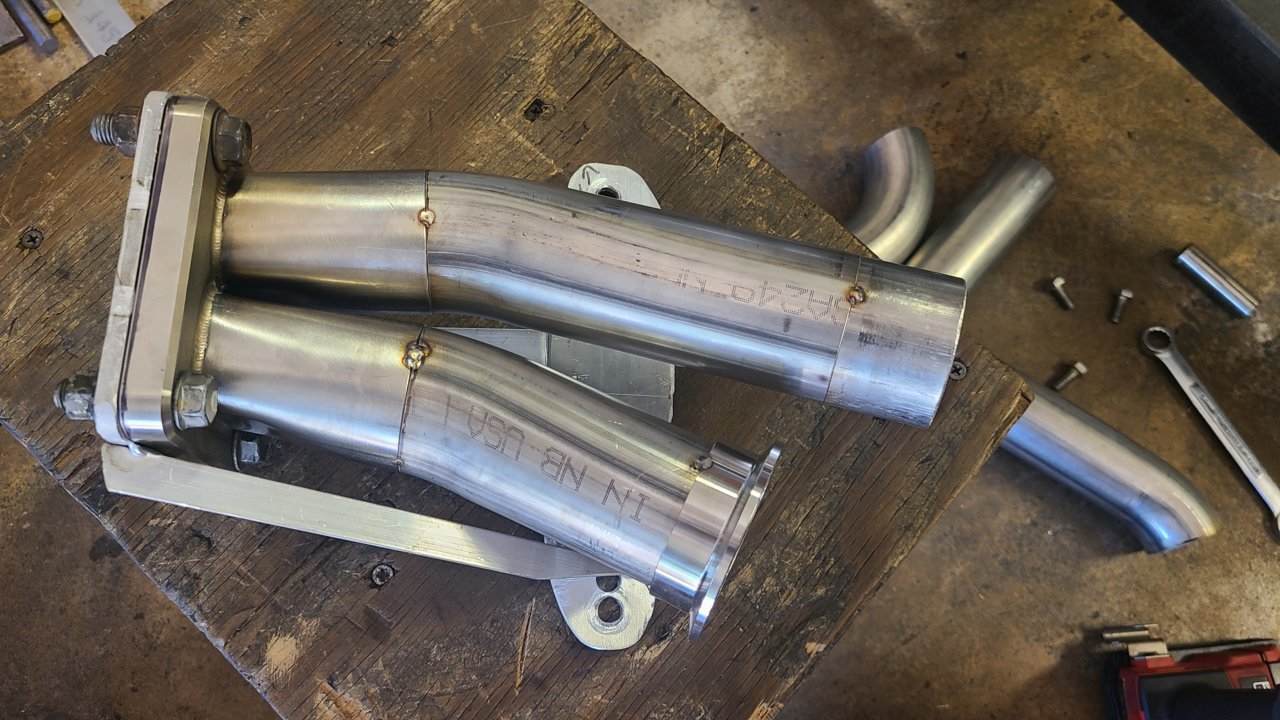

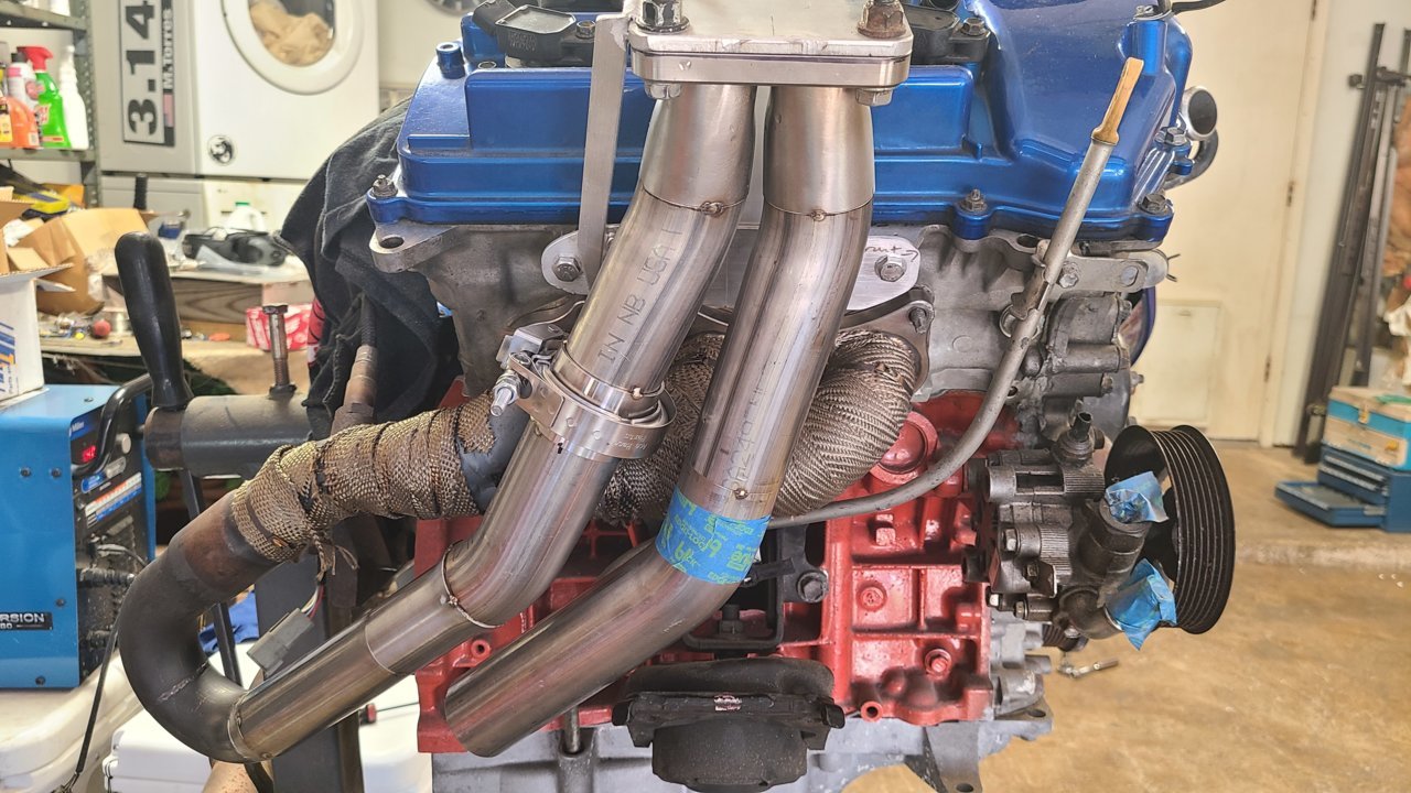

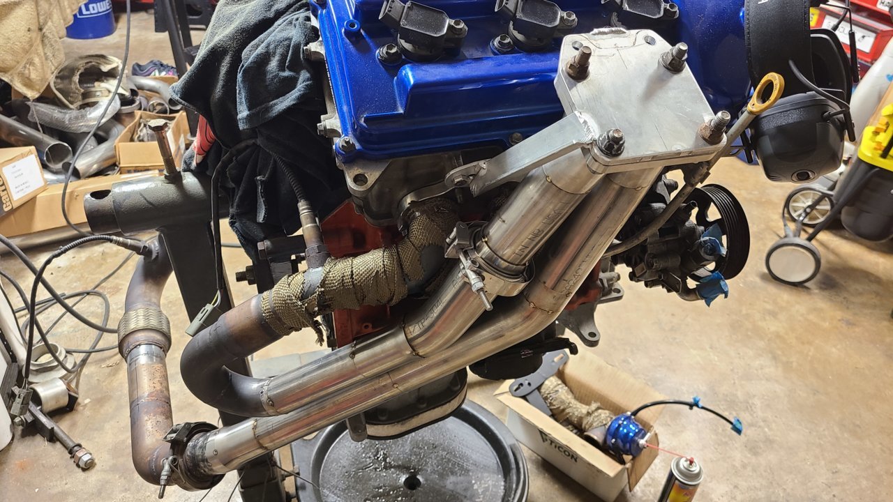

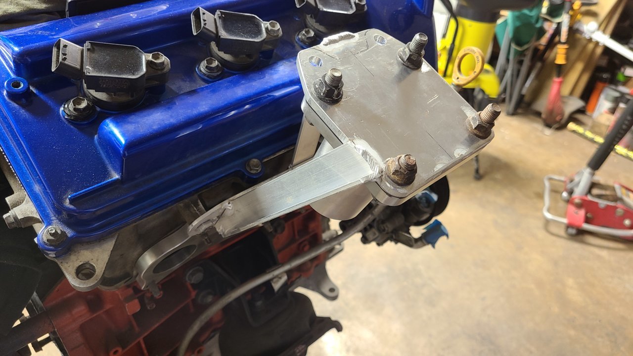

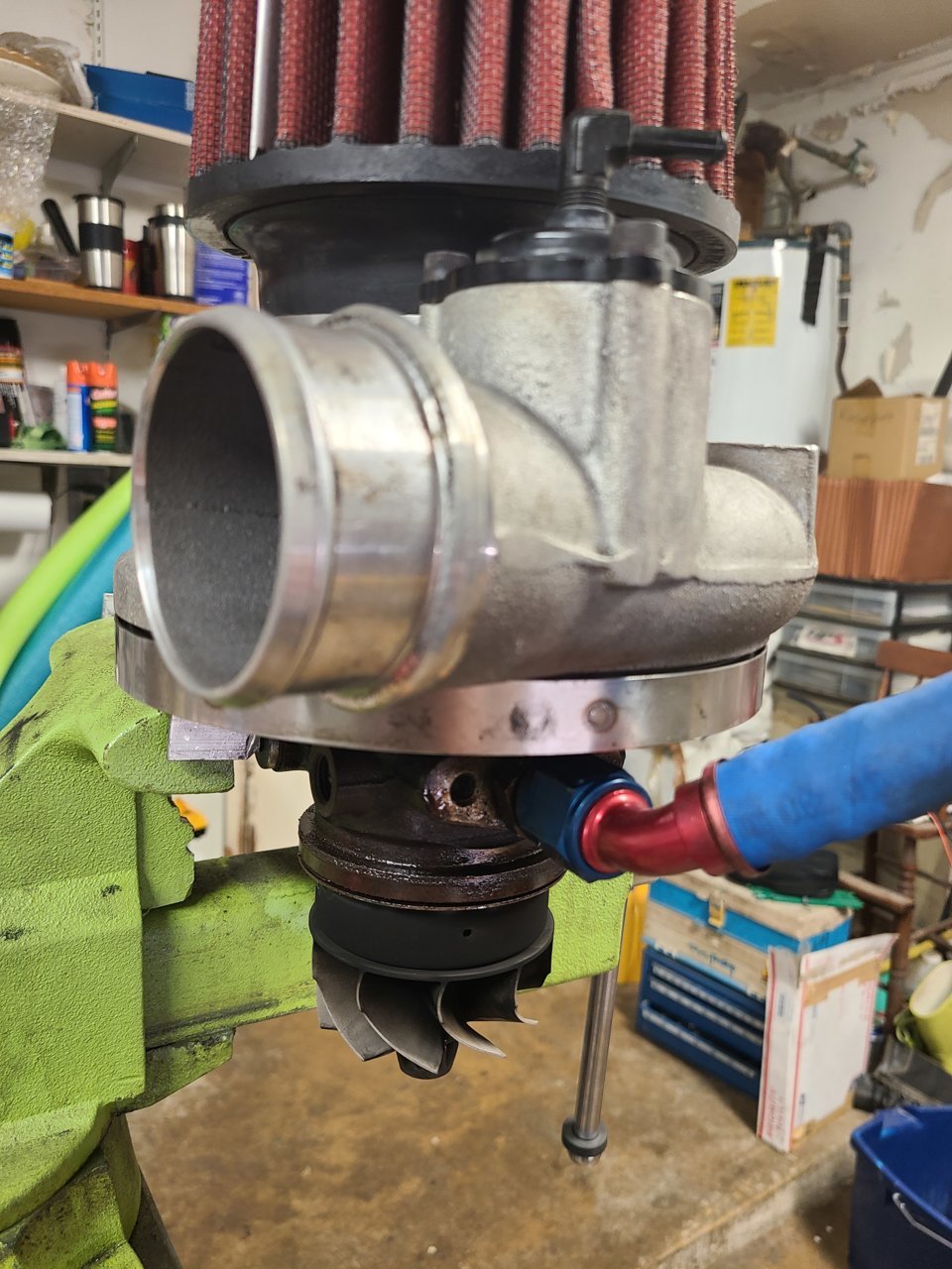

    Worked on this project over the last week. Time to install and finish up the down-pipe.

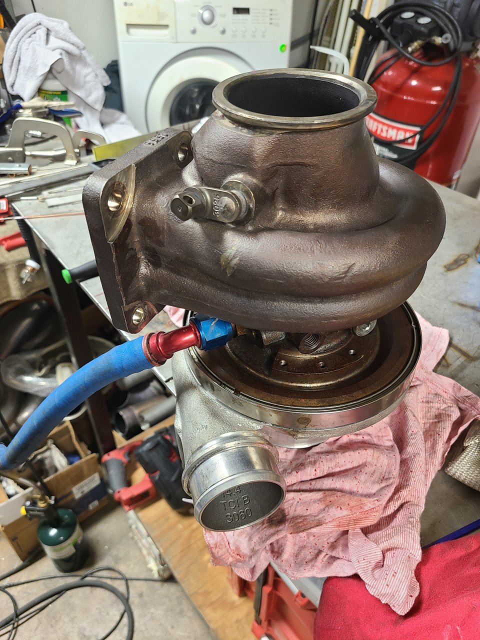

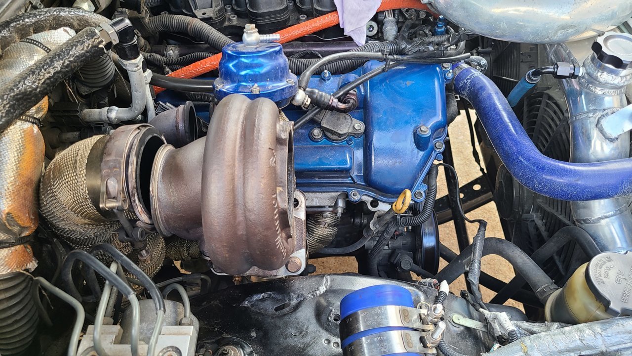

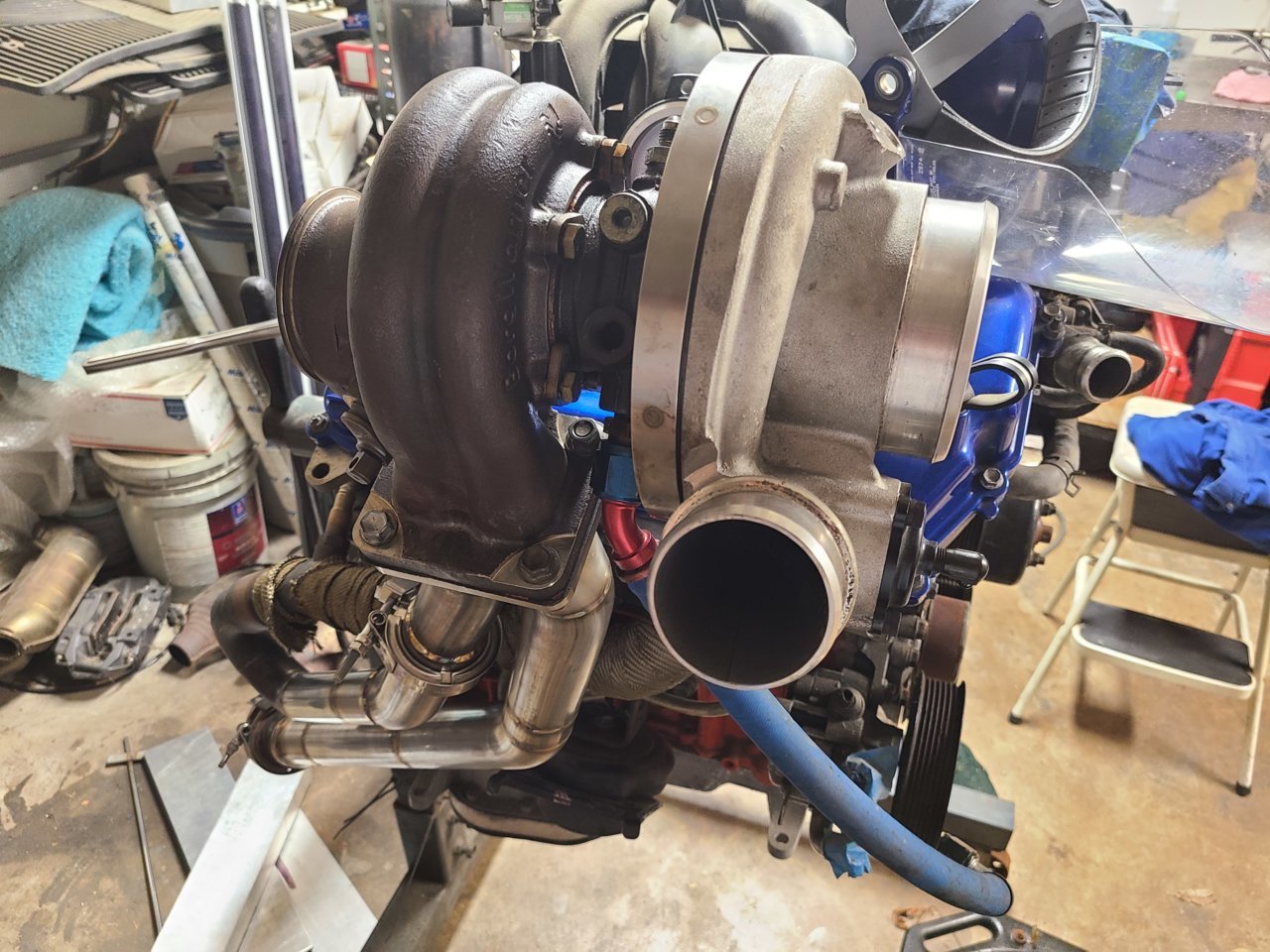

    Testing in the truck.

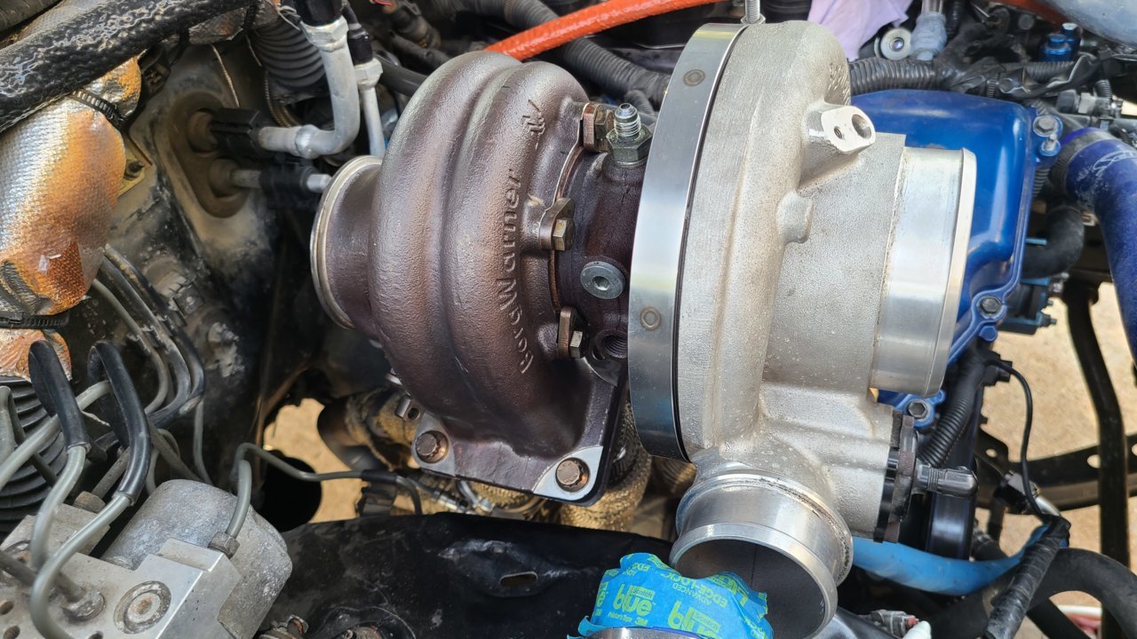

    Tighter A/R housing installed.

    Properly clocked center cartridge, and mounted.

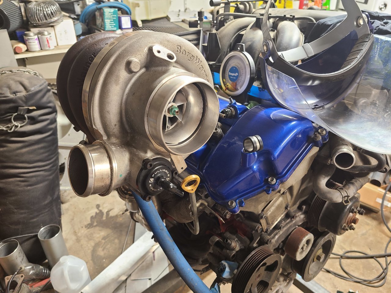

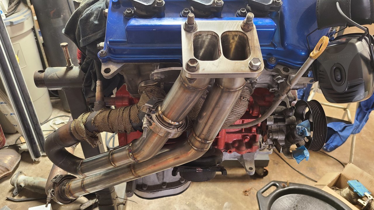

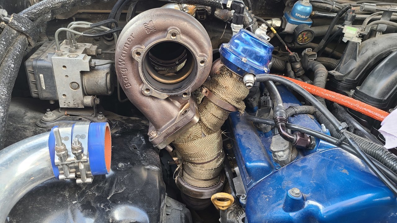

    Moving along...

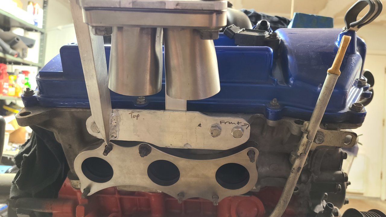

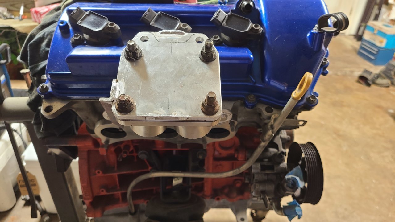

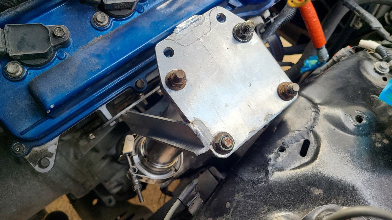

    A problem that I encountered last time that I had the IGW housing on, was being able to properly mount the Turbosmart wastegate. As well as the actuation effort of it. Making a new mount completely this time around.
    Testing the mounting location of the WG.
    Enough for tonight.
