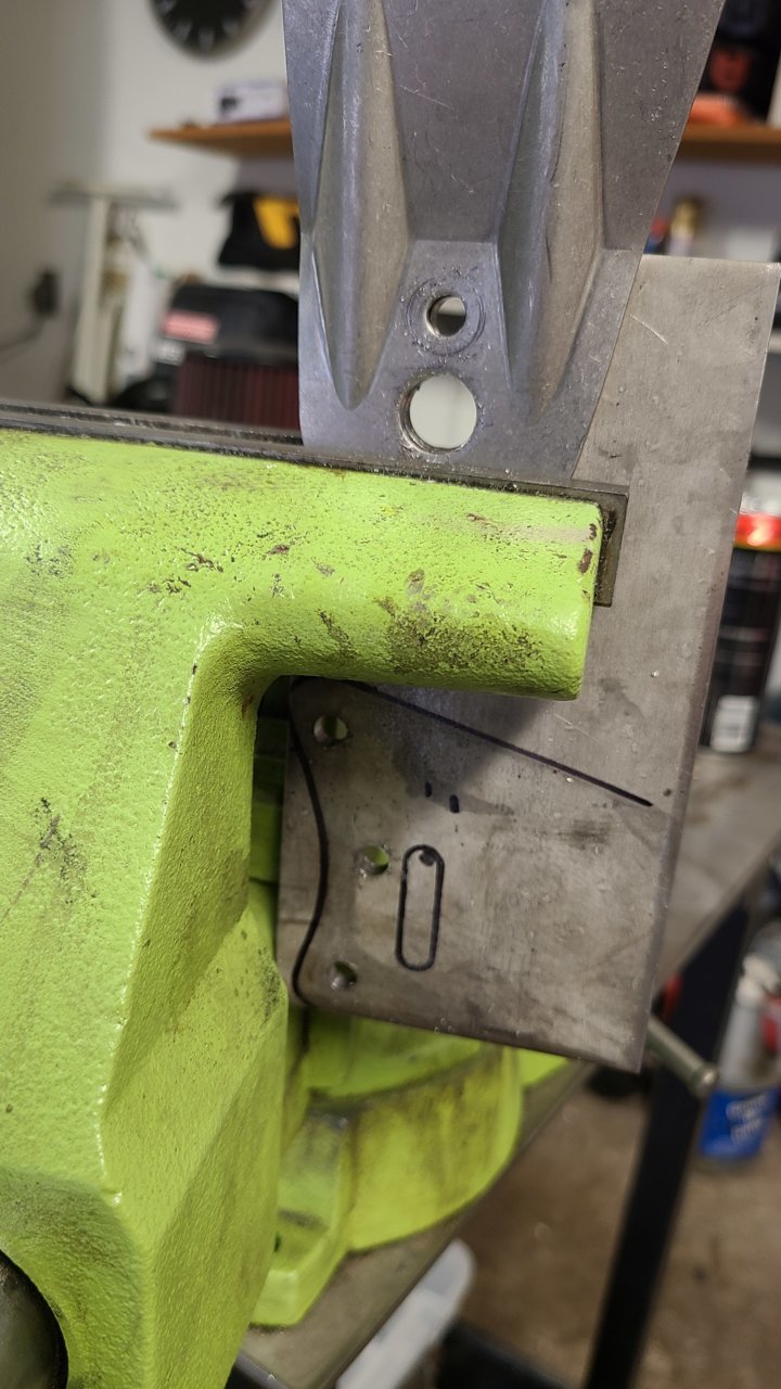

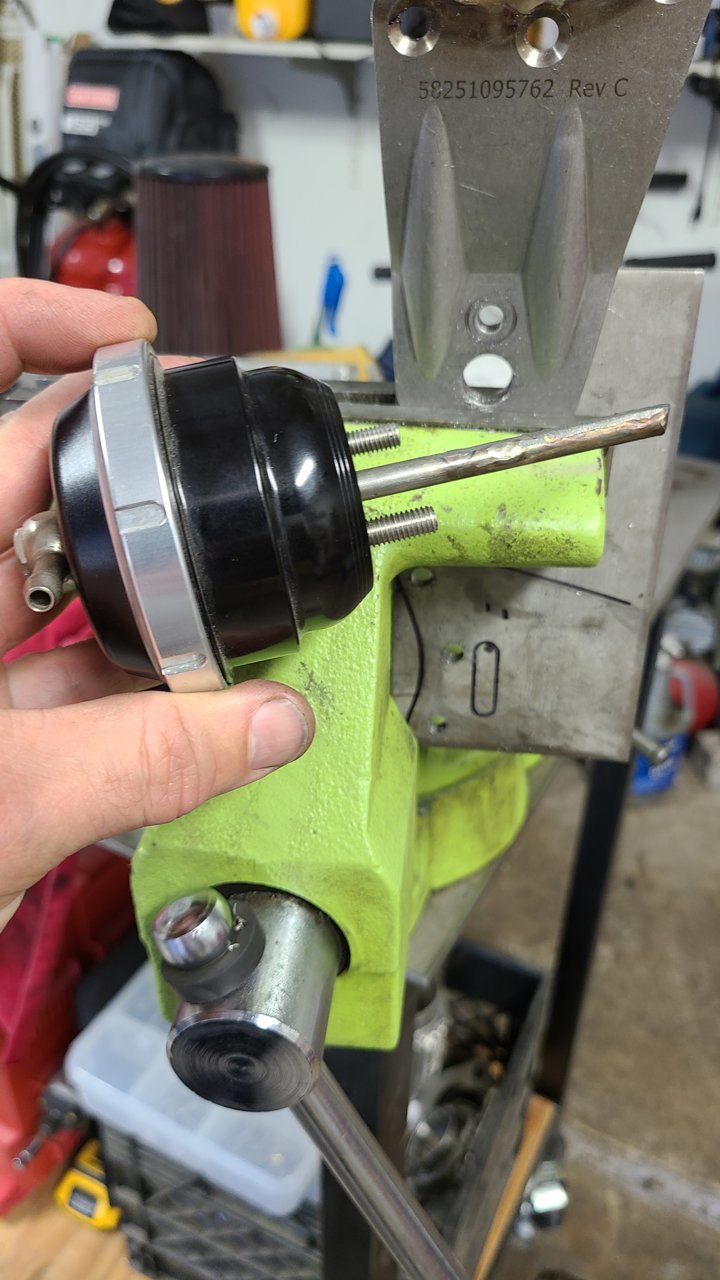

    Did you weld an extension onto the wastegate arm? Never seen one with that much character! :D

    I did in the past. Got a bit of a smiley face, doesn't it? Lol

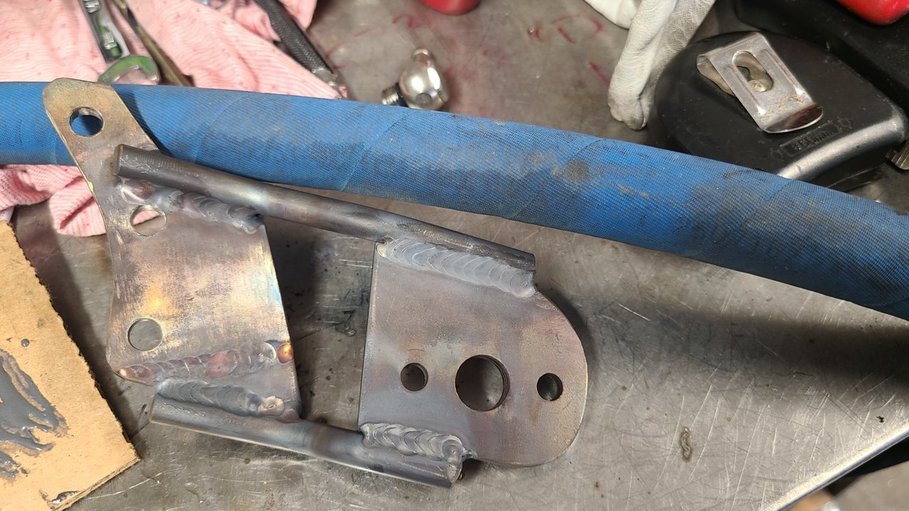

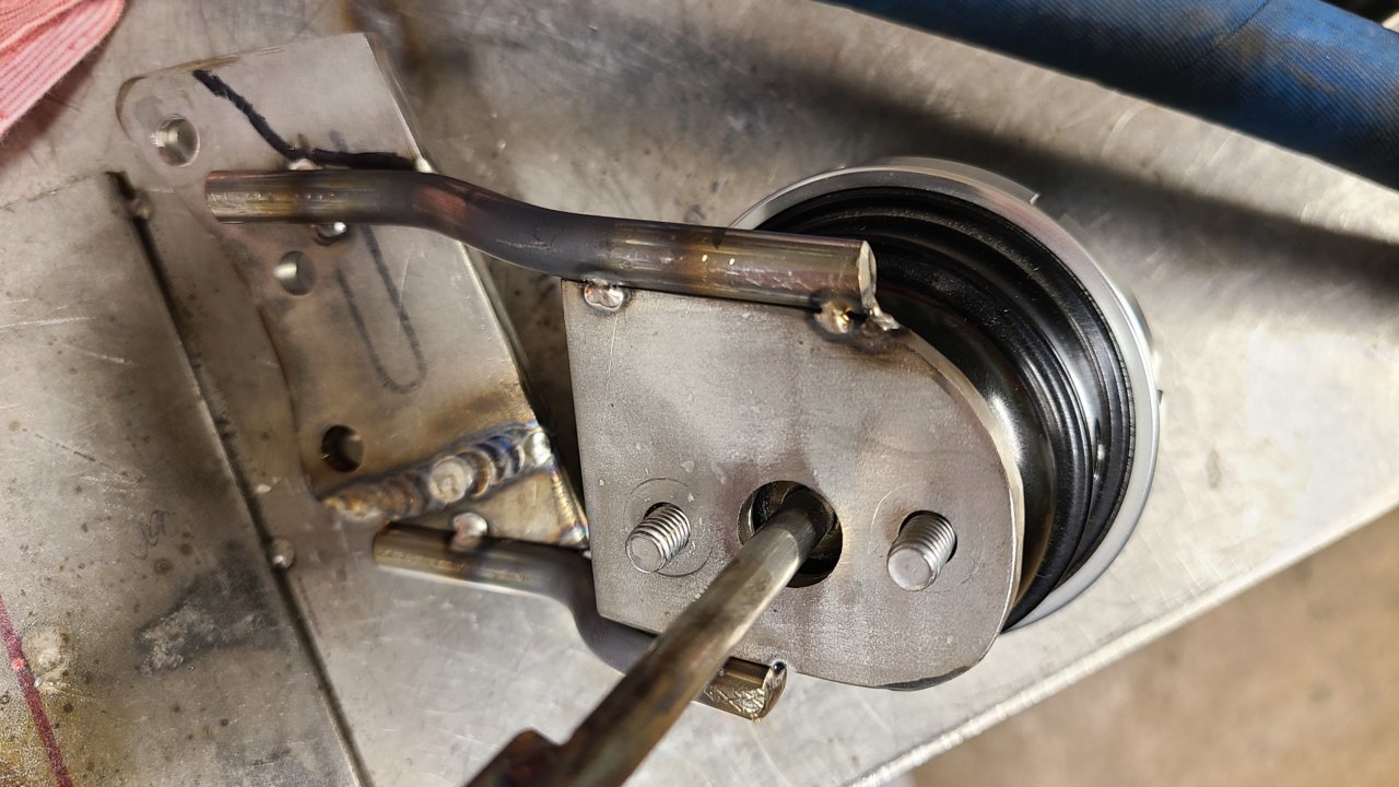

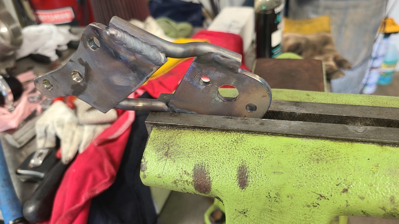

    WG bracket nearly completed. Just requires a finish weld. Then onto the charge pipe, down-pipe, and test drive!

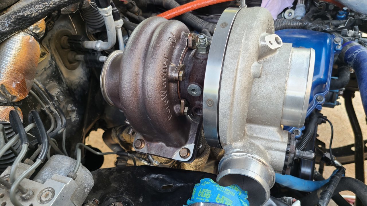

    Nearly completed

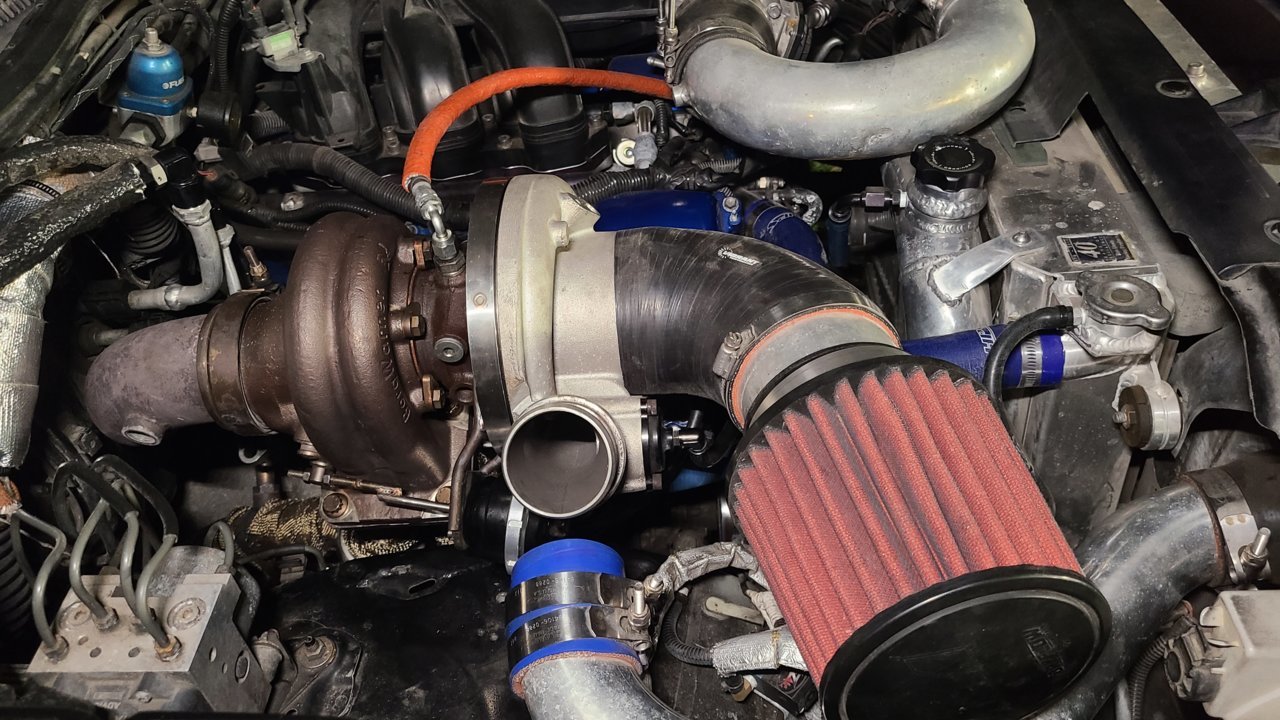

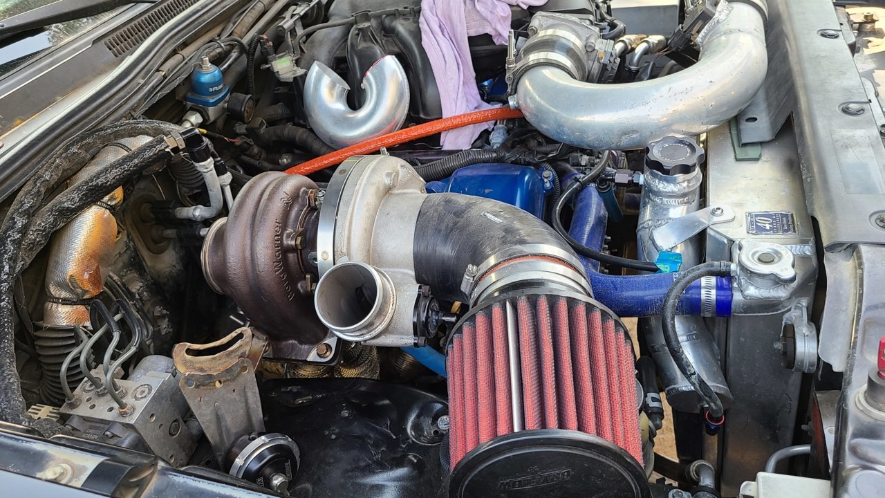

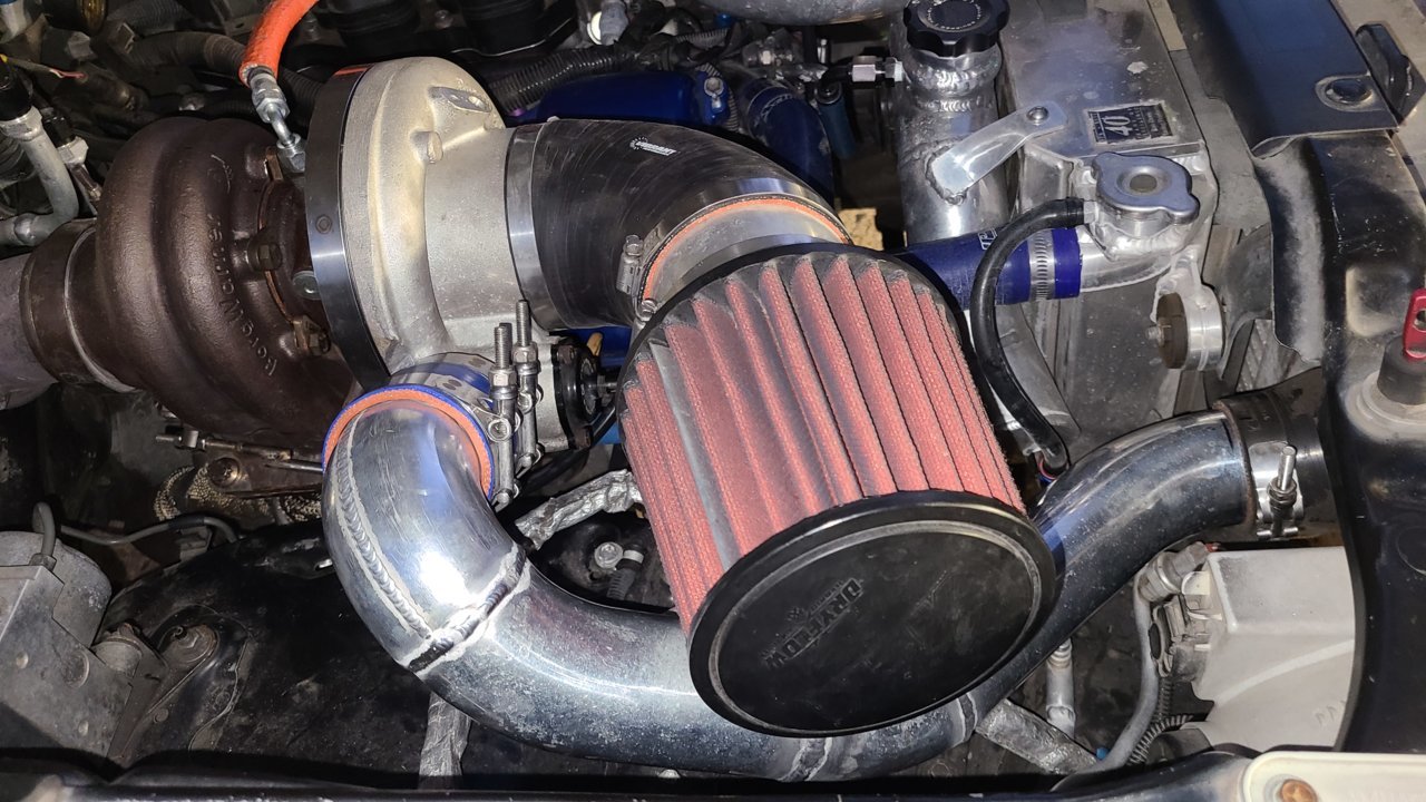

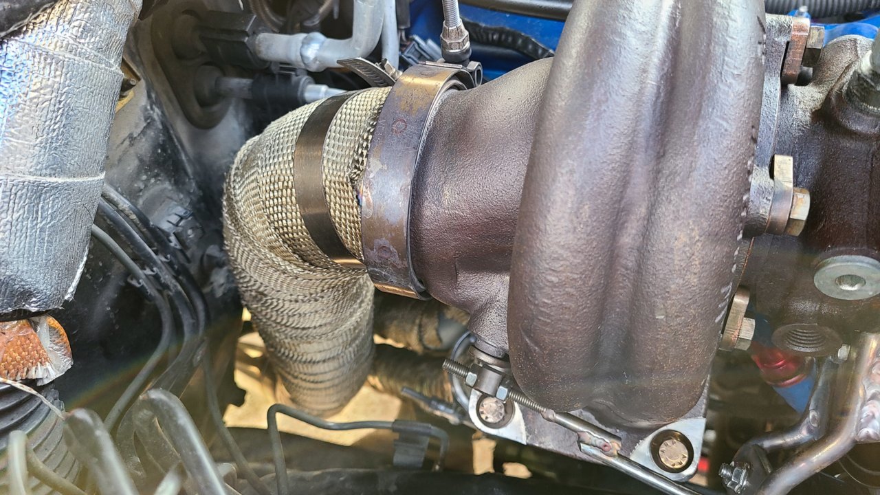

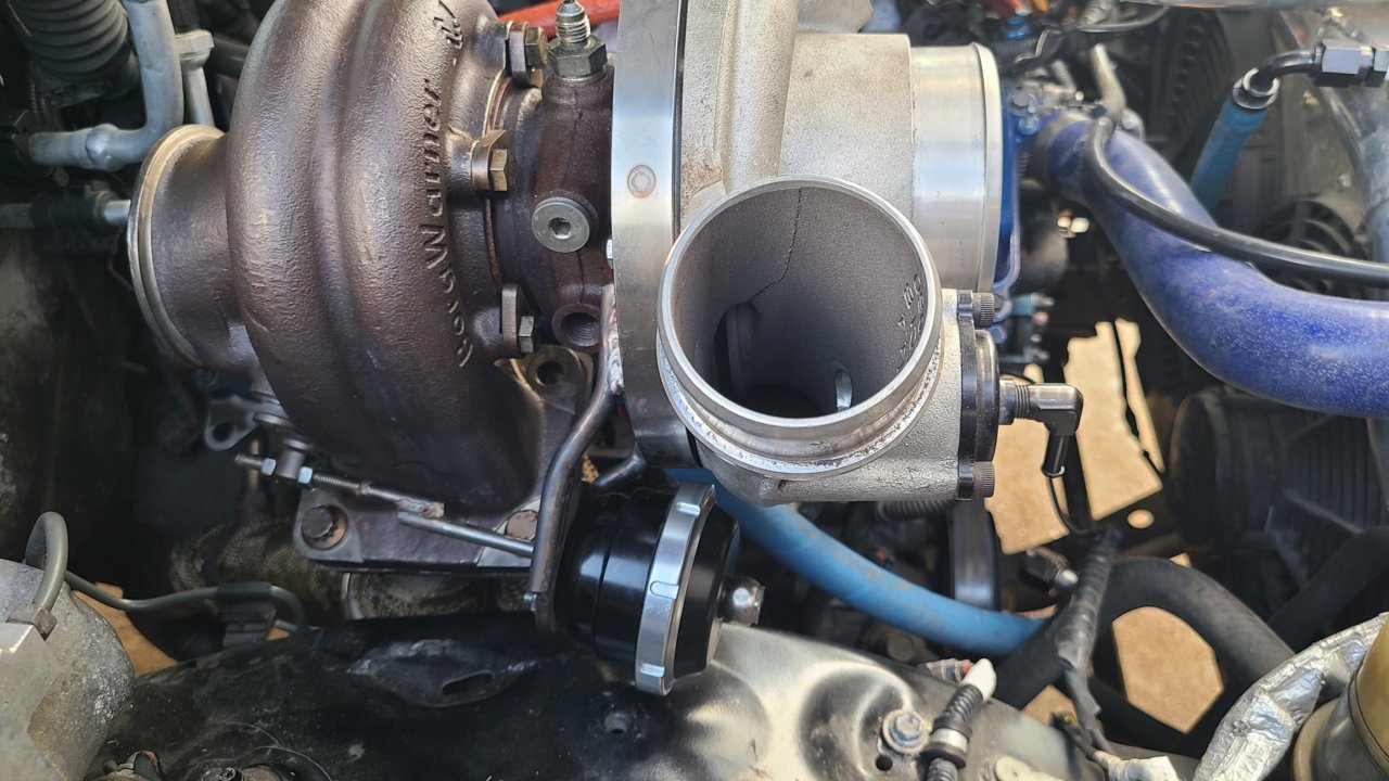

    She runs well! It responds much more quickly. As it should, but breaking boost threshold at 2k.

    Looks good! Let's here a video now :thumbsup:

    Once again get some time to datalog. It is dangerous lean after 4k.

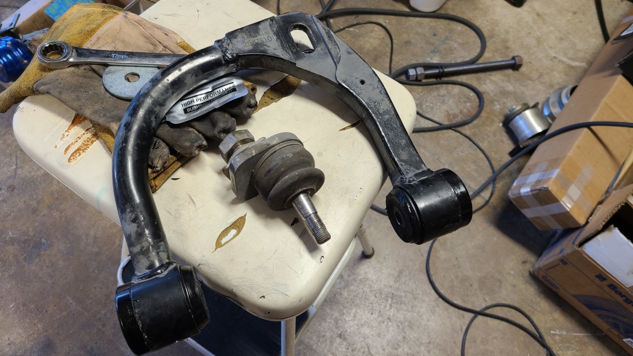

    Nothing exciting. Just some maintenance. New ball-joints with the zerk fittings, and bushings. Piece of cake.

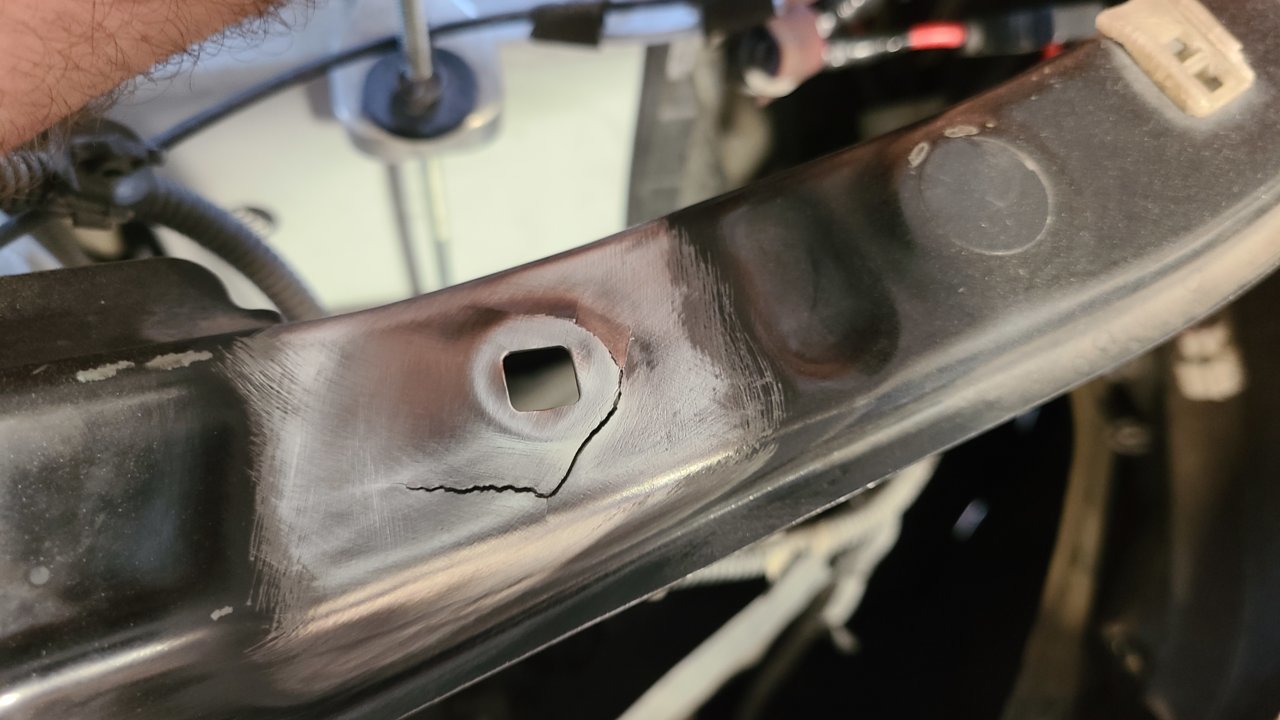

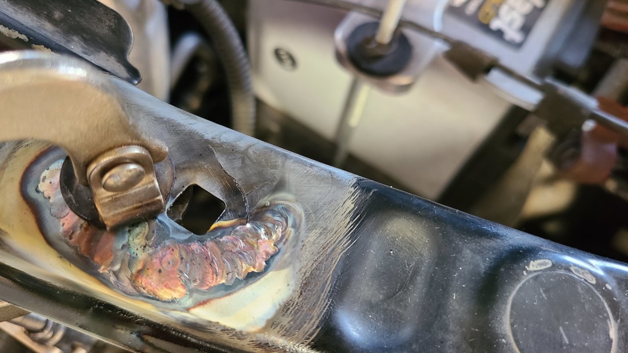

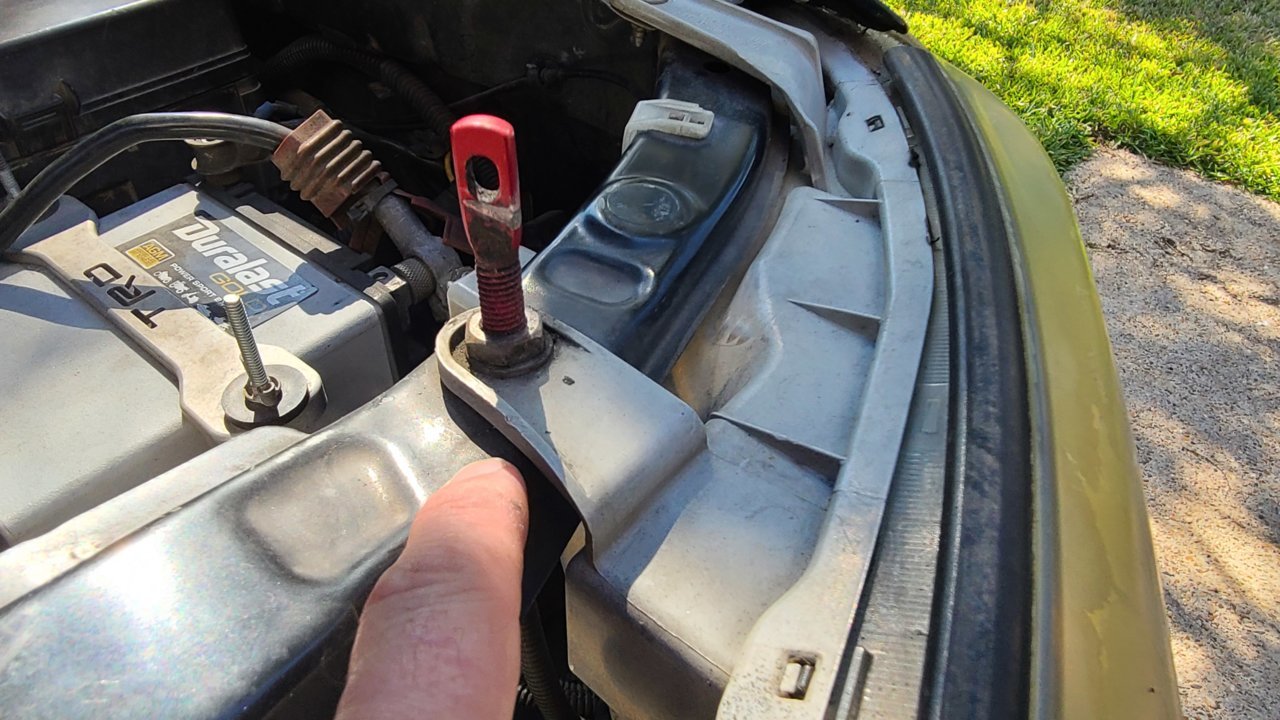

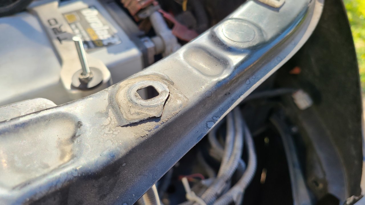

    Been hearing a creaking, metal on metal noise. Found it...

    All better there. Need to repair two more cracks on either side of the radiator core support. Stupid thin sheet metal.

    That weld looks stronger than the whole support lol

    The rigidity was immediately improved! For obvious reason.
    I use the lockable Aerocatch hood latches. With the under hood support. Due to my hood being fiberglass/carbon fiber.
