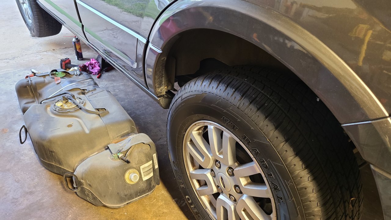

    Nothing yet. Been too busy helping fix other people's cars.
    2014 Ford Expedition, as an example. Fuel pump wire, shorting in the tank.

    That was after some irregular time spent troubleshooting an intermittent loss of power.
    Also, the OEM wiring loom routing, on the passenger side of the engine bay, had nearly rubbed through a handful of wires. It was resting on the A/C line.

    Very nice find Tor. I bet that drove you and the owner nuts!

    :cheers: I will say. Dropping the tank on that was a breeze compared to the 2nd Gen Tacoma. Truly a breeze.

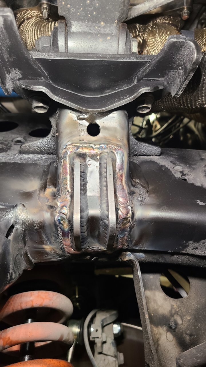

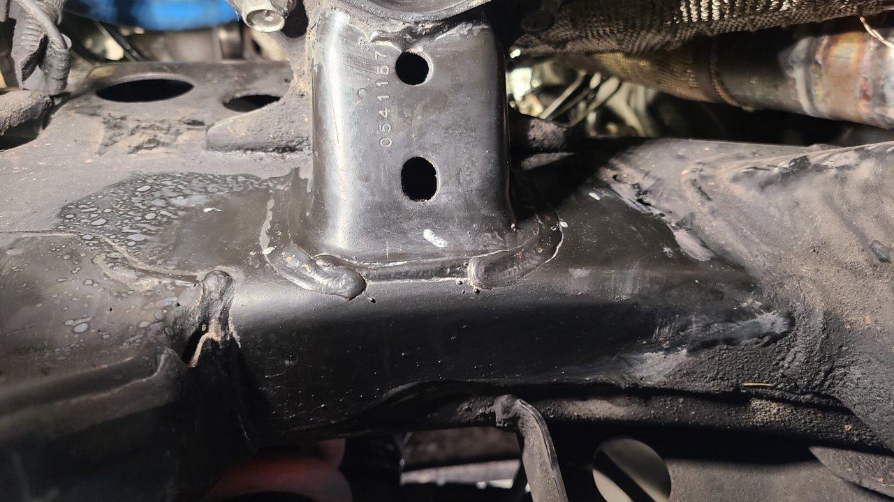

    Got the passenger side DMZ Fab engine mount gusset welded in. Was a challenge to the bead on the area closest to the shock. Bit of a challenge overall, with a TIG torch in that confined area. Even with a stubby.
