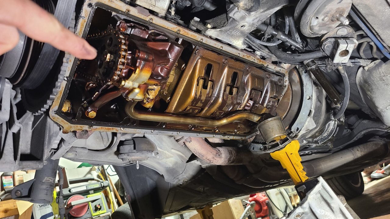

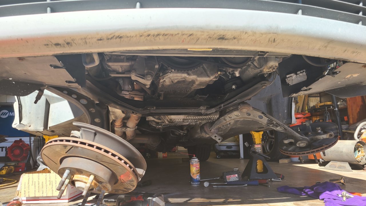

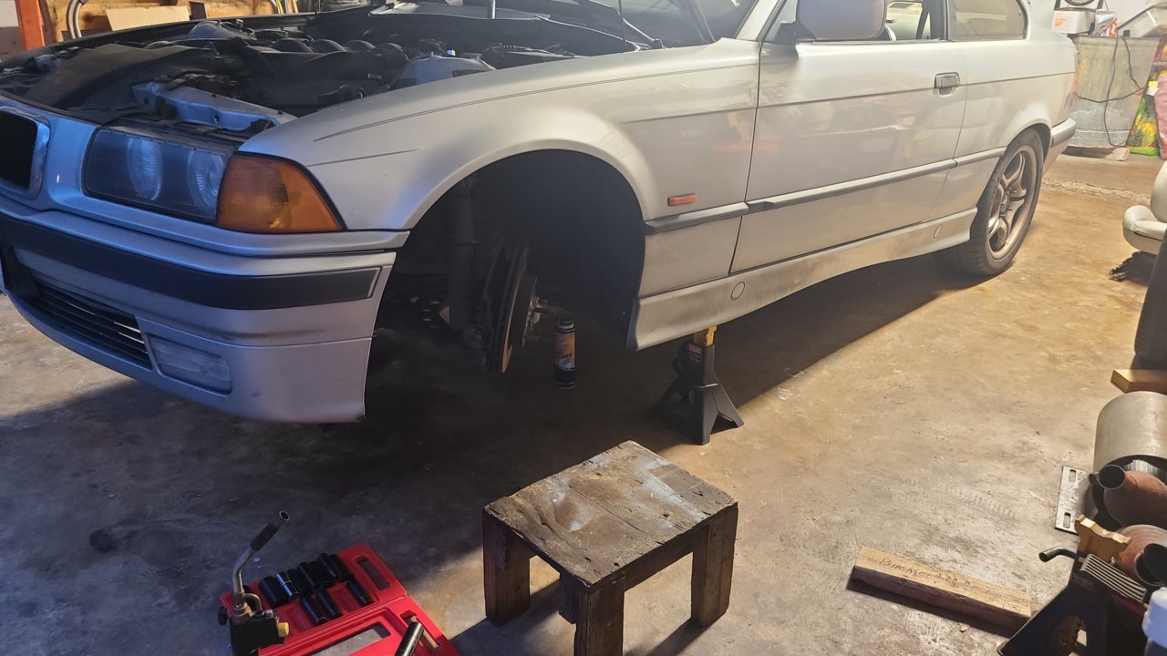

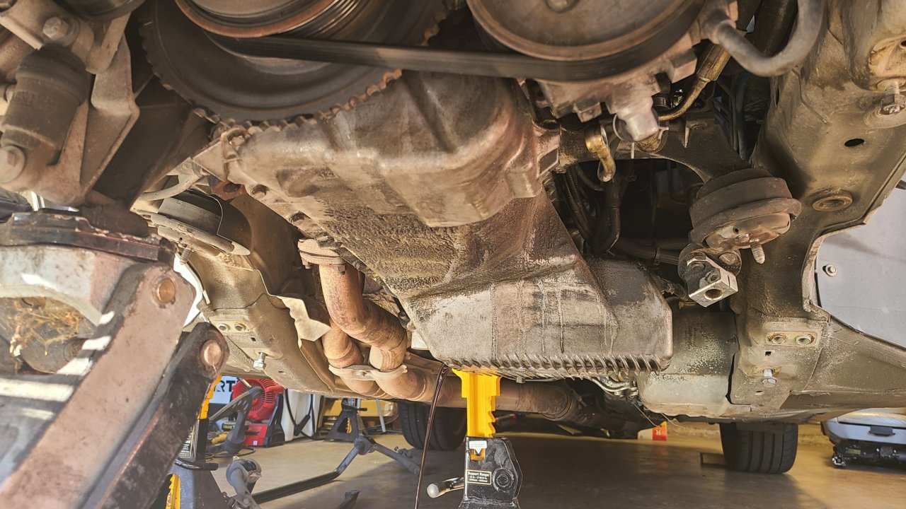

    @BassAckwards , this is a major portion of the delays in me getting work done on the header. Rather annoying level of work necessary to get to the oil pan...
    20201223_174001.jpg 20201225_134453.jpg 20201225_134512.jpg 20201225_145710.jpg 20201225_183254.jpg
    What I am pointing to in the last photo, is the nut-orious failing oil pump nut.

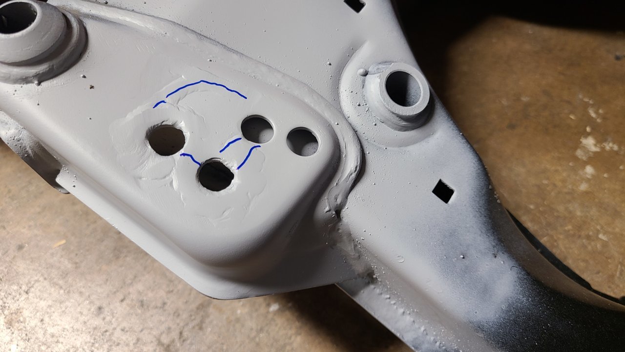

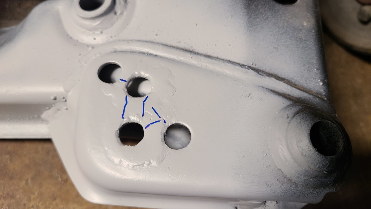

    Was having a flickering tin man oil light. Checked the oil, and the level was low. No problem, add some back in. Oil pan gasket had just been progressively failing.
    Later that evening, the light was flickering a lot, or staying on. Back to the house for a game plan.

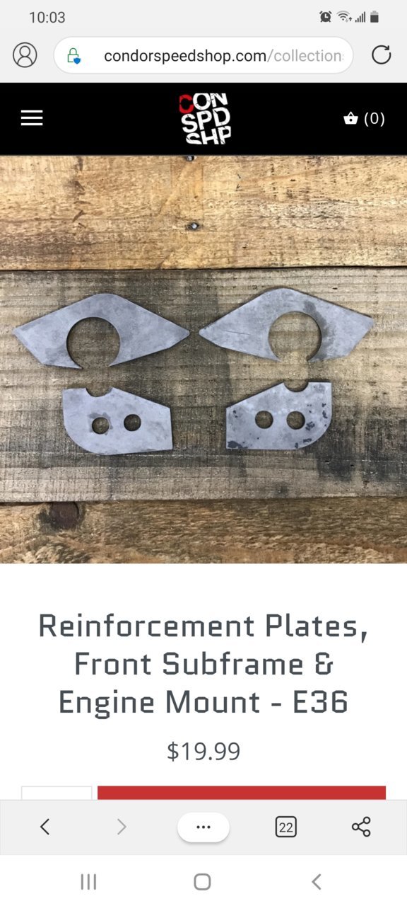

    Ordered: new gaskets, oil pressure sensor, oil pump w/ reinforced pick-up tube, better engine mounts and trans mounts, subframe gusset kit.
    Loctite from a previous engine entry, held, but being in there with all of the age and miles, time to replace those critical components.
    The subrame is also well documented for failing at the engine mounts. Sure enough, barely any material was holding the metal together. Welded up the cracks for the time being, while waiting to receive the gussets.

    No worries man, things happen! That is a lot of disassembly just to drop the pan, what a pain. It'll be worth it though once you get everything ironed out. Better to find it now than when you're on the track and it causes other problems

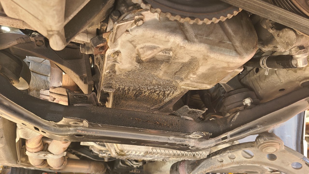

    Here is where the cracks were on the subframe.

    For the price and time....

    Oh yeah $20 easy decision haha

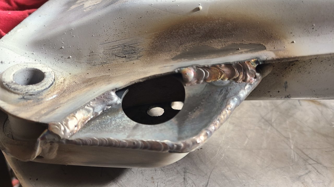

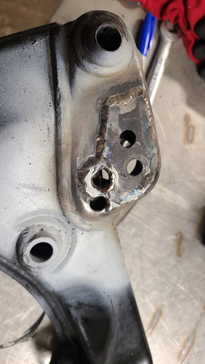

    Subframe welded.
