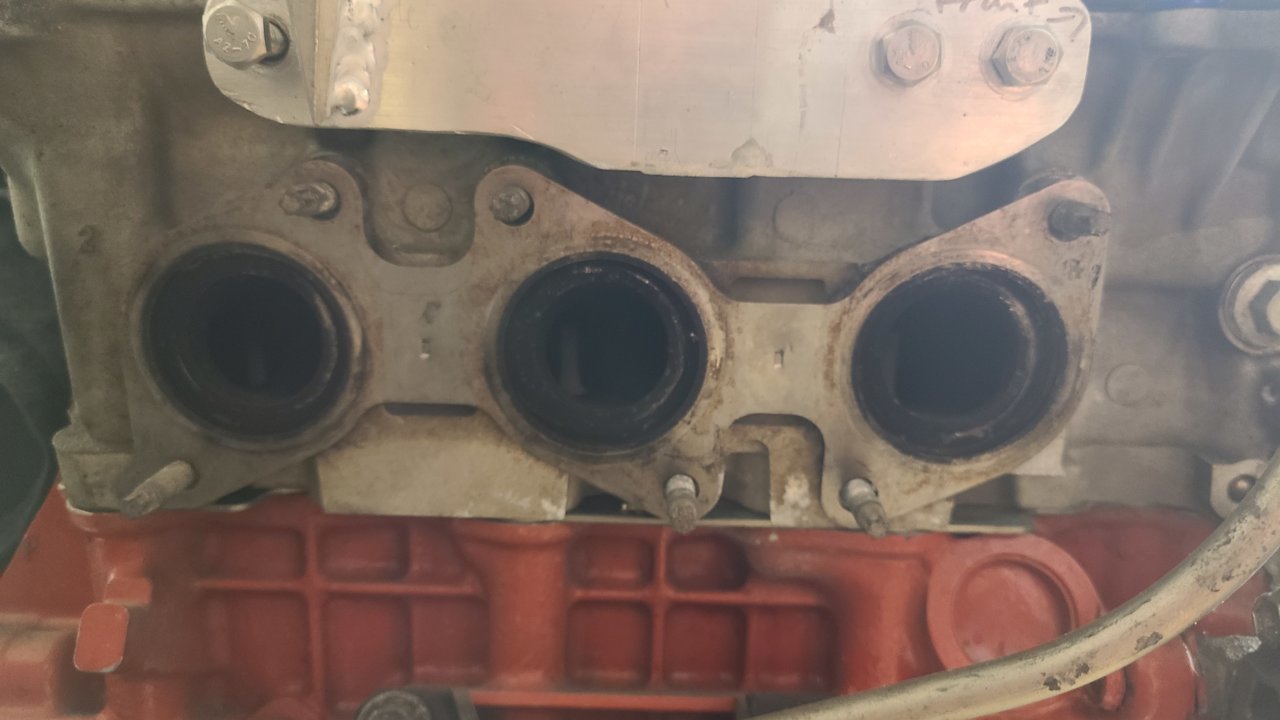

    64B72B38-EA6B-469A-996E-4090B0EEB8C7.jpg DC6790EE-C320-40A5-9097-B5DD392742C3.jpg @Torspd super dumb question. Can you fit 2015 heads/exhaust gaskets with 2009 URD equal length headers?

    I'd use the pre 2012 gaskets to seal off the secondary air injection port.

    Is that the 2009 model Spec-U header in the picture?
    If so, use that gasket in the photo above it. The 2005-11 gaskets only follow the area of the studs. So the SAIS ports would not be covered, and you would have exhaust leaks between the head to header flange.

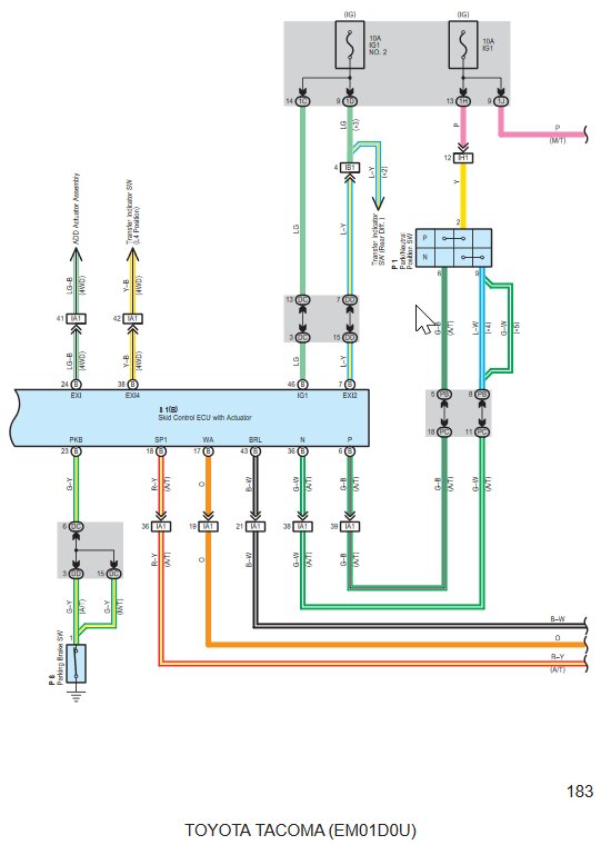

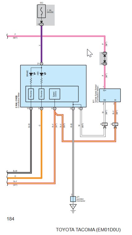

    @Jimmyh
    You're super resourceful at finding wiring diagrams. Curious if you have at your disposal the wiring diagram for the 2006 ABS module?
  7. Feb 2, 2021 at 3:22 PM
    #8467
    Jimmyh
    Jimmyh Well-Known Member
    May 16, 2012
    #78991
    14,268
    SC
    2012 Prerunner SR5
    I'll see what I can find.
    With or without TRAC, VSC, Auto LSD, DAC and HAC ?
    This is without:

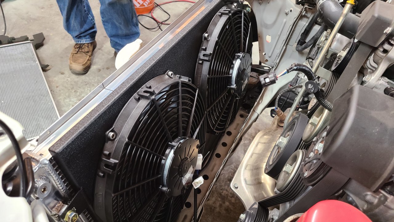

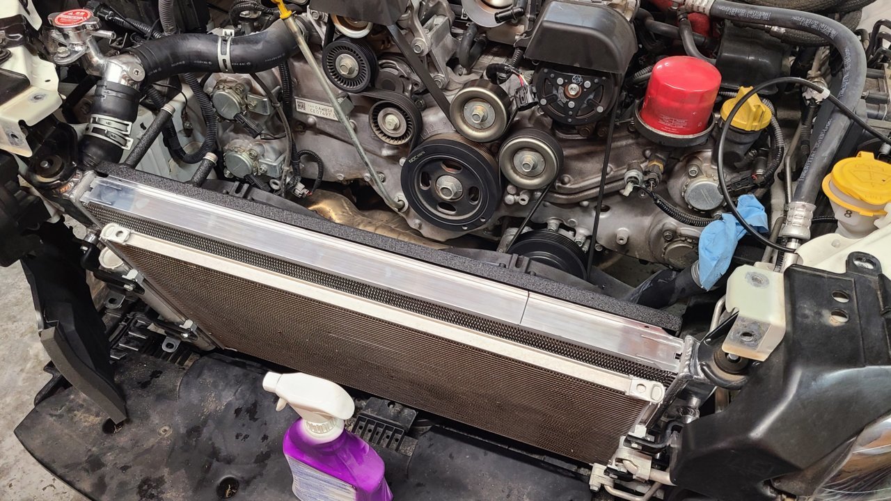

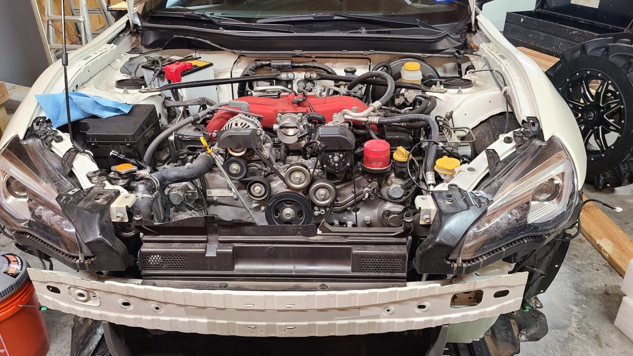

    Last weekend, after work, I aided my friend with a Koyorad radiator upgrade for his 2019 BRZ. First step needed to gauge the physical dimensions of the bay, in preparation for the upcoming turbo installation. :woot:
    20210130_170208.jpg 20210130_164958.jpg 20210130_174330.jpg 20210130_170122.jpg 20210130_182102.jpg 20210130_182112.jpg 20210130_182834.jpg 20210130_170144.jpg
