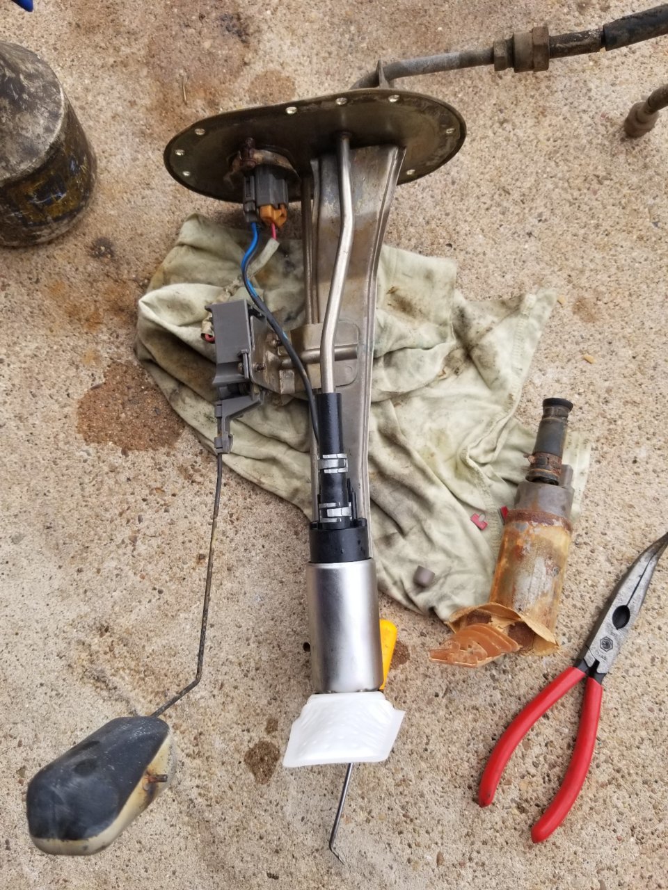

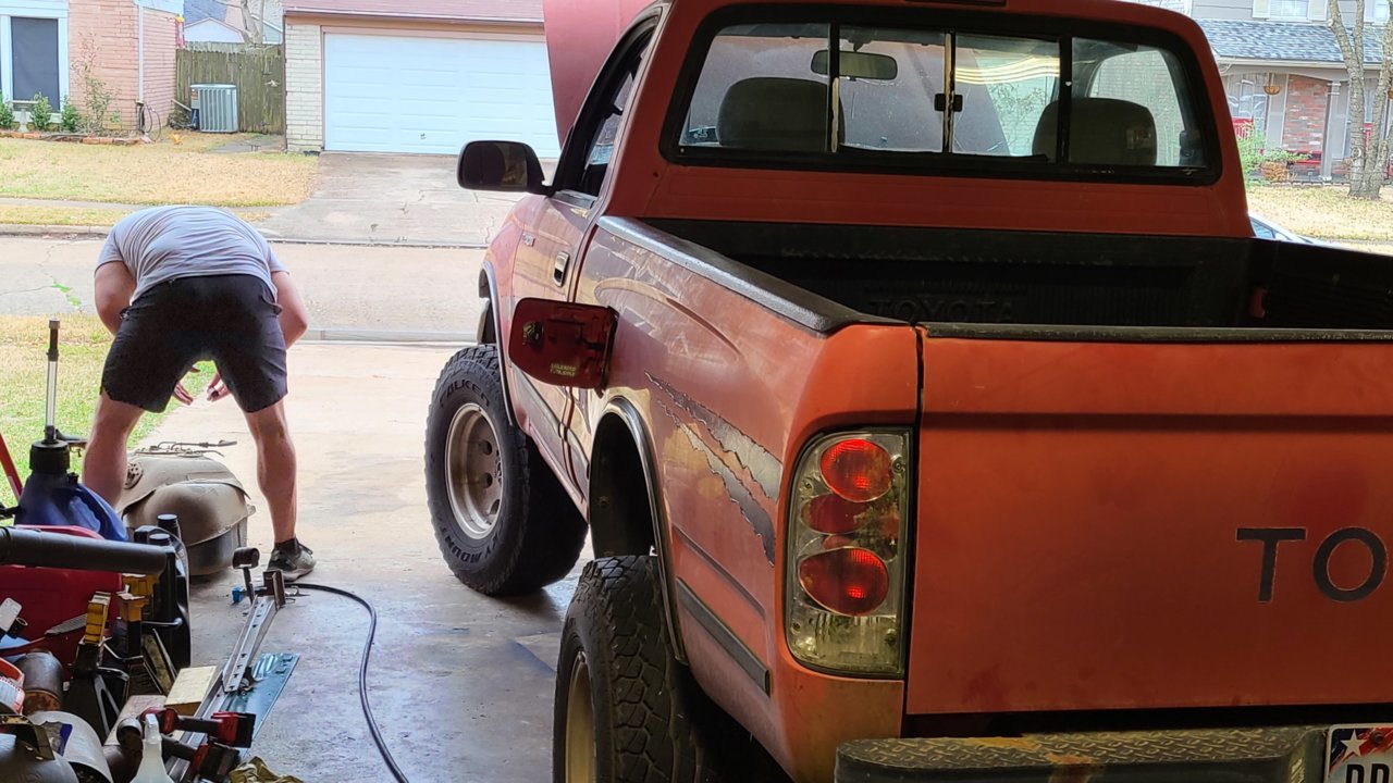

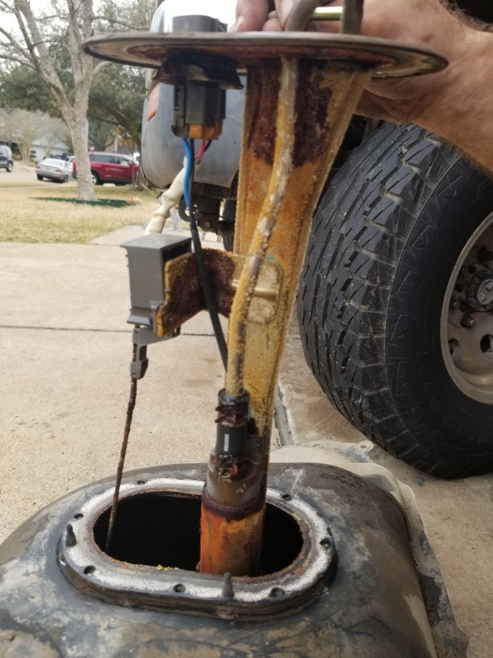

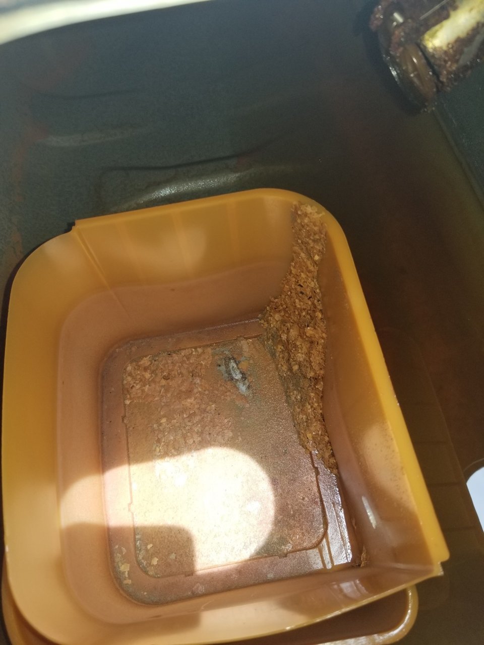

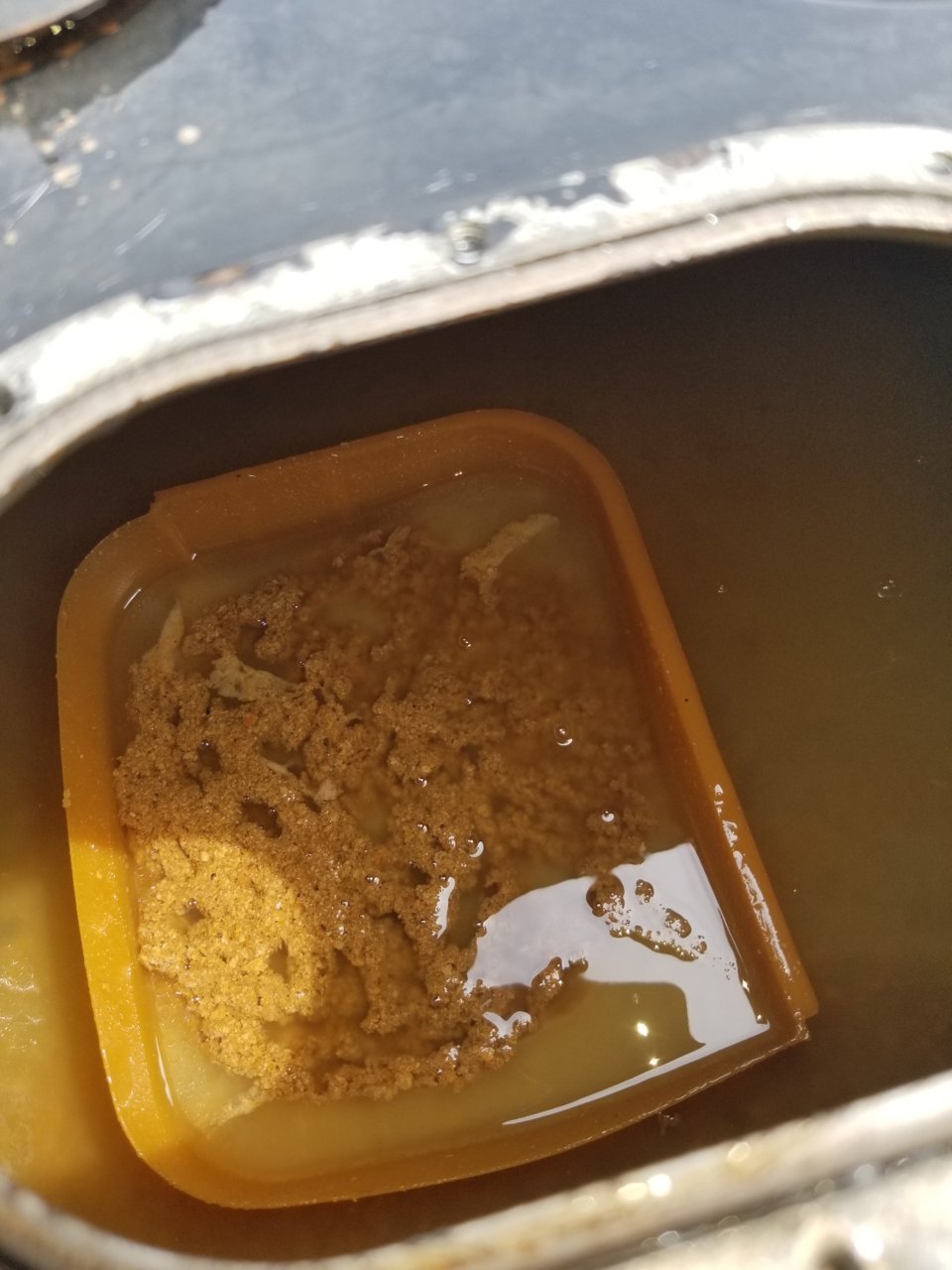

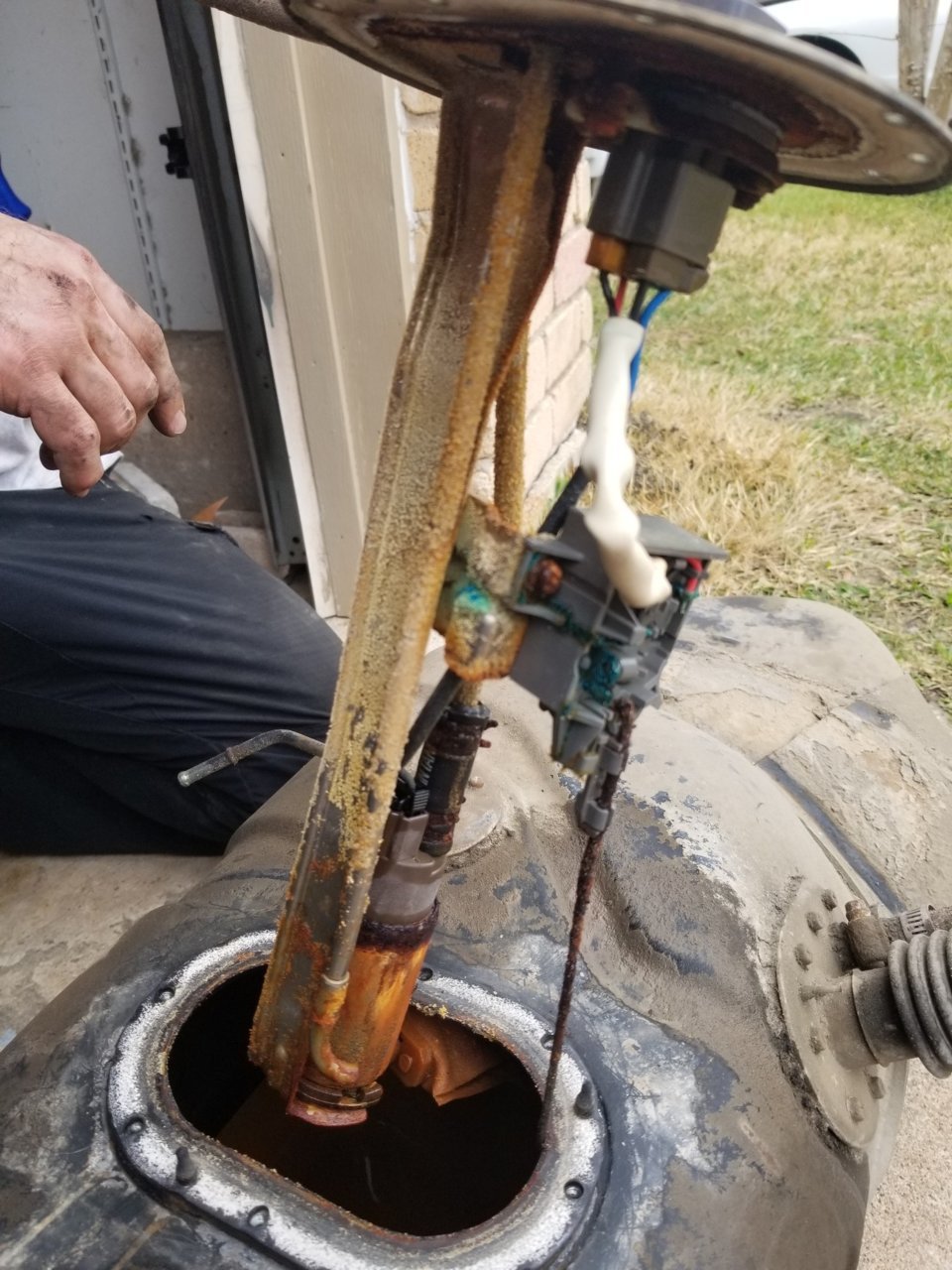

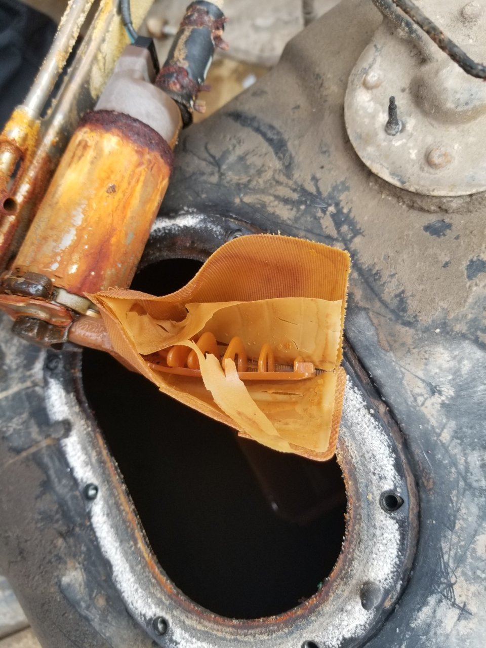

    Here is the latest from the Red Booger. AKA The Bloody Tampon...
    This time, it was a fascinating dive into its prior life. We had two main goals to accomplish. The fuel filter and fuel pump. My mechanical nature and ear, wants to fix any and everything that doesn't sound right.
    I had replaced two idler pulleys that were shot, last time it was over. The unlubricated metal marbles in a metal drum sound persisted. Off the belts came to test every accessory. The water pump was the culprit, and I don't even know how is isn't leaking. The fan tilted downward probably close to 10° once the belt was off. Wow! That belt keeps it "aligned".....No pump so onto the main tasks.
    First was the pump. What a surprise that followed.
    Reciprocating saw blade had been taken to the filler neck. Guess the prior mechanics didn't have the strength nor skill to get it off without hacking it up...
    The cap which holds down the filler neck to the tank, was finger tight.....fail. How well do you think that gasket worked at doing its job?
    Drained it then filled the tank up with water to wash whatever all was in it, out.
    These '95 pumps aren't marine rated....
    As you can expect, it had a "hard start" issue.
    Then all cleaned up as best as capable.
    After the fuel pump, we didn't get any pictures of the fuel filter. Nothing exciting going on there, minus the sand draining out of it.

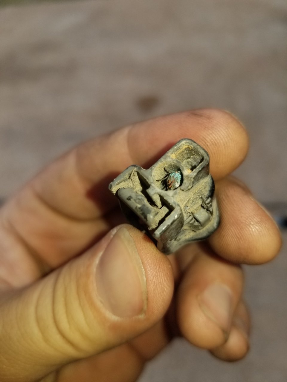

    While it there, behind the fuel filter I found a dangling wire though. From a plug on the side of the 3RZ block. Maybe that was related to the CEL his truck had. Sure enough, it was the knock sensor wire.
    Soldered and crimped it back together.
    On our test drives, he literally stated that was the first time it had seen 60 MPH since his purchase 17 years ago. Wow! He was nearly staggered at how quickly it accelerated. Full Timing map FTW!

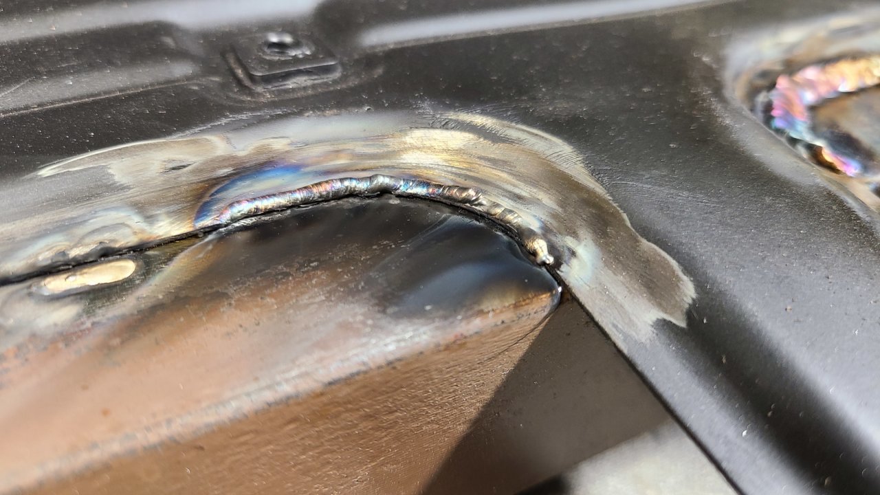

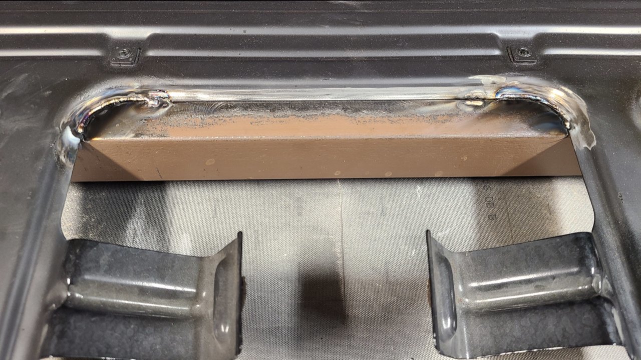

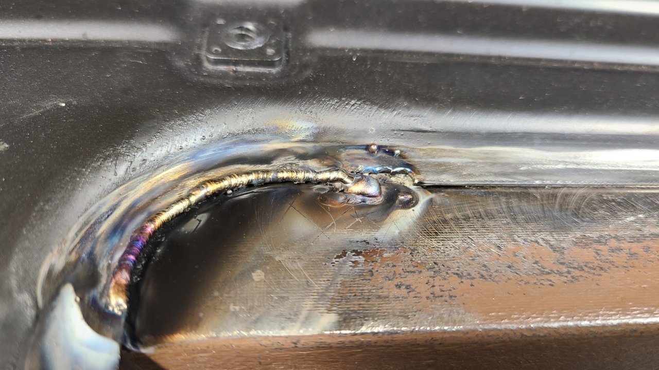

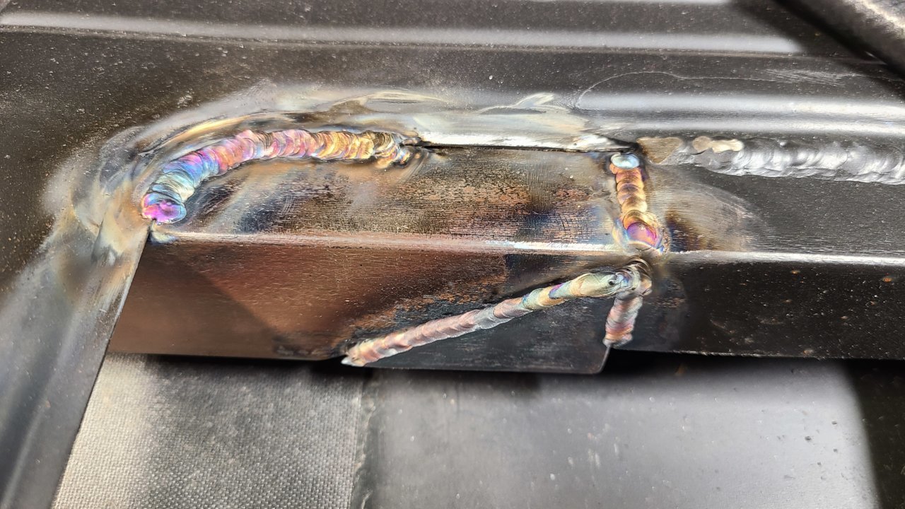

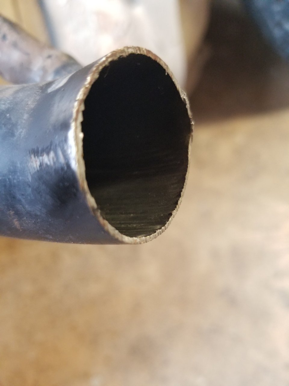

    @not_nick , I figured it out tonight. Using extremely low current at roughly 11 amp and building up a bead with some .043" filler rod is the key. Then stitch the bed to the angle iron.
    20210303_210345.jpg 20210303_210350.jpg 20210303_210403.jpg 20210303_211047.jpg 20210303_210614.jpg

    Huh, i wouldn't have thought of doing that. You sure are creative :hattip:

    Thanks mate. It was quite the tedious process.

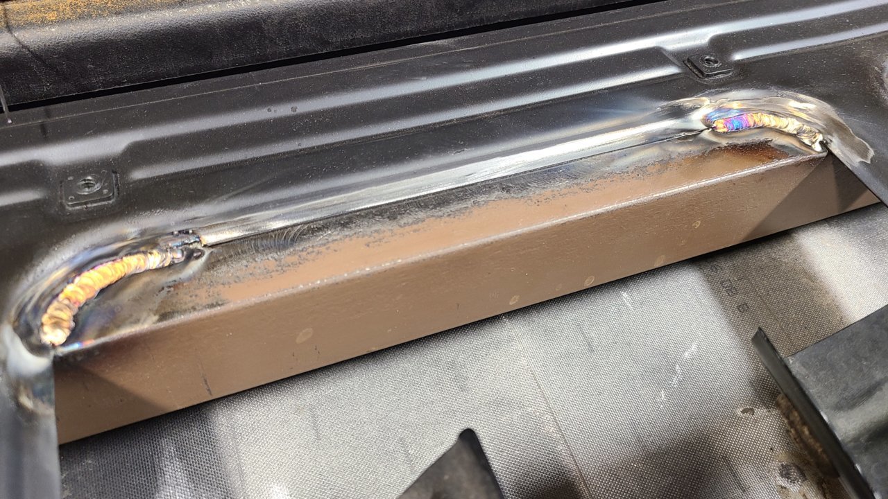

    @not_nick , finished up for the time being on the tailgate last night. Started out trying my hand a few more times with the normal filler rod. Tedious, and excruciatingly slow paced.
    Was ready to rage quite. Had so many things going on recently, that I had forgotten than I had the silicon bronze filler.
    Man, what a breeze that was to lay onto the thin body panel, then meld with the angle iron. It does act a little like aluminum.
    For any future body connections, it will be the silicon bronze.
    No pictures to add. It was all Go-time.
