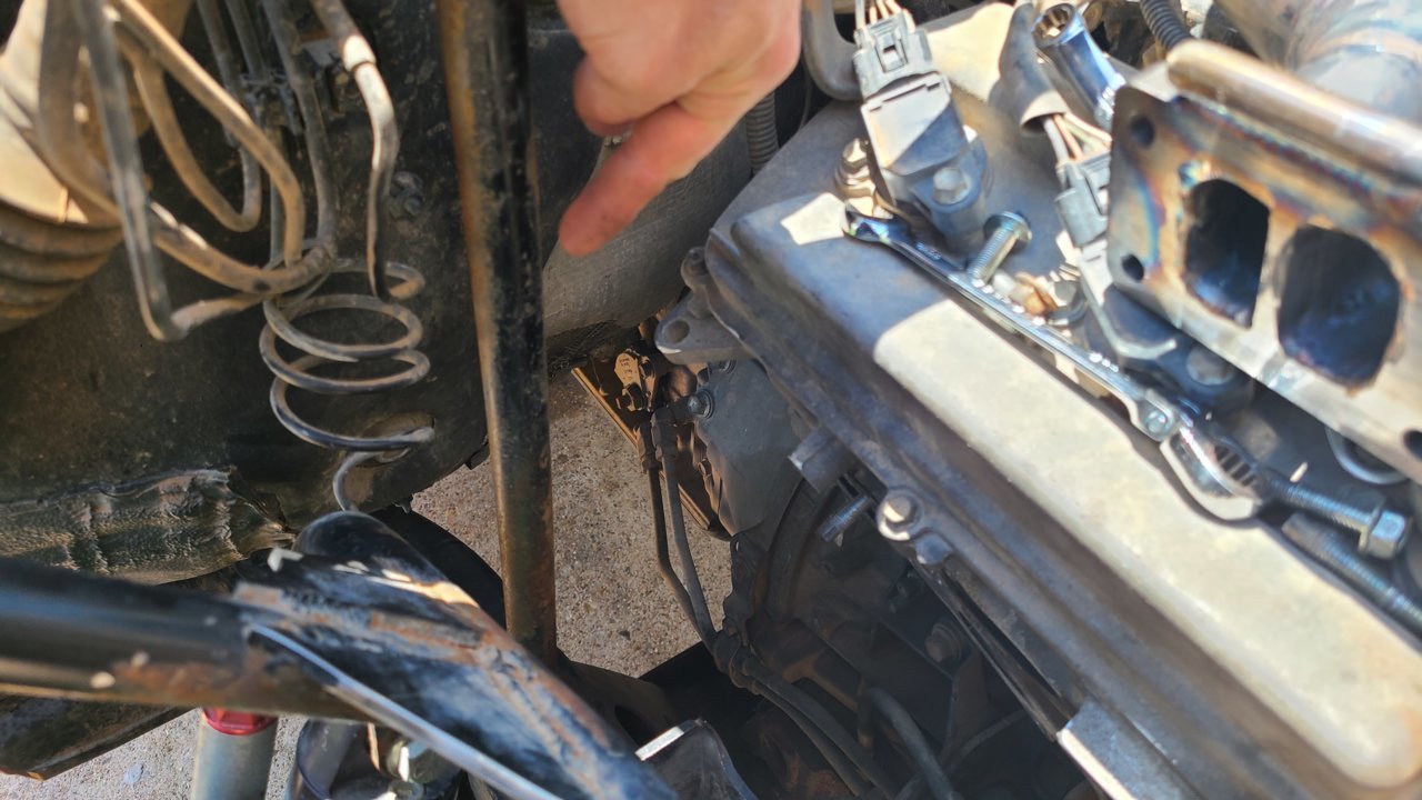

    For those that haven't been following in the Turbo B.S. thread, this has been the current project that I have been working on. More of the photos will be over there.

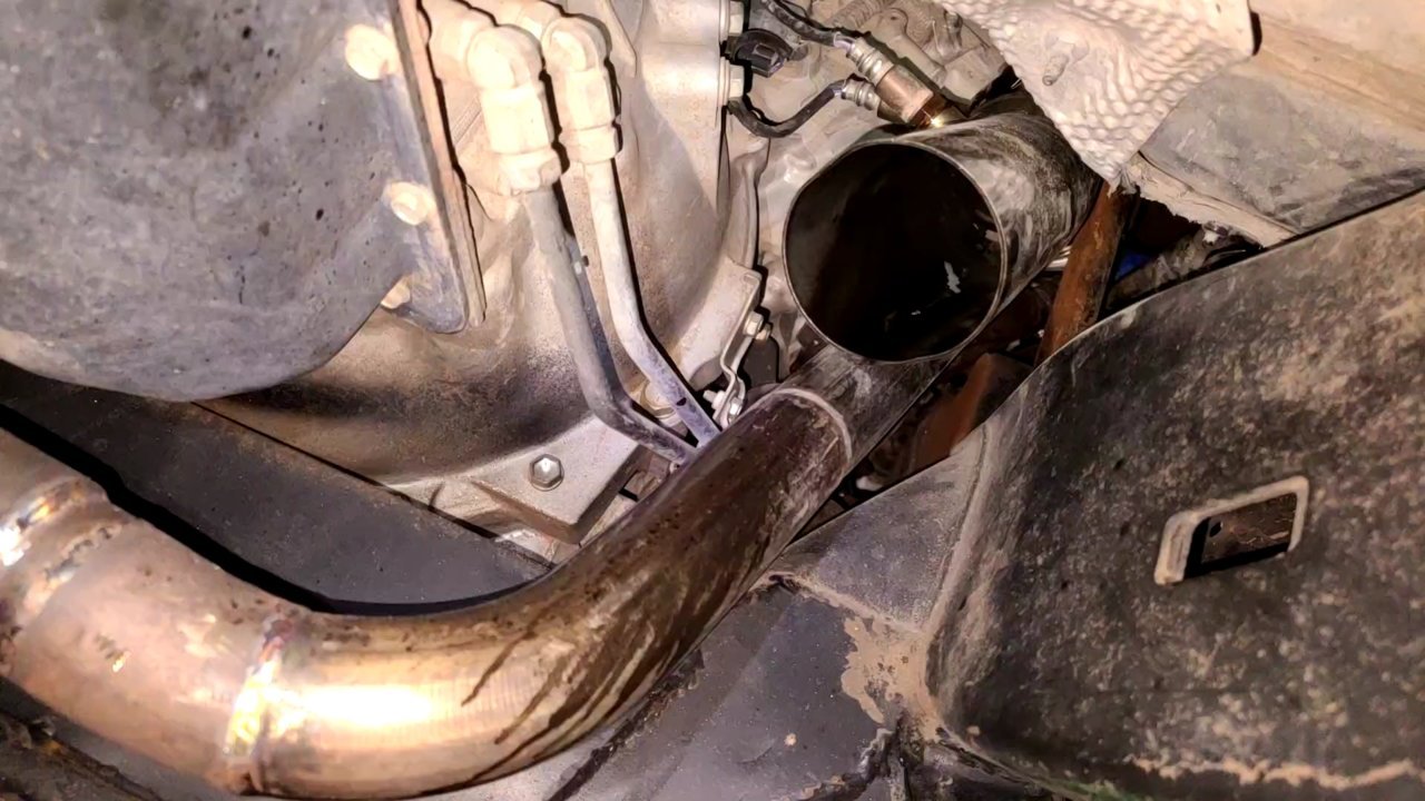

    Had some spare hoses and fittings. I was determined to get a start-up video today. Through the lines on, and made sure that happened.
    For the turbo feed solution, this is the easiest. If not running an oil cooler adapter.
    Need to weld the AFR bungs into the downpipe. Mount the intercooler, and route the charge tubing. As far as drivable though, it can. No leaks, and sounds exquisitely race truck!

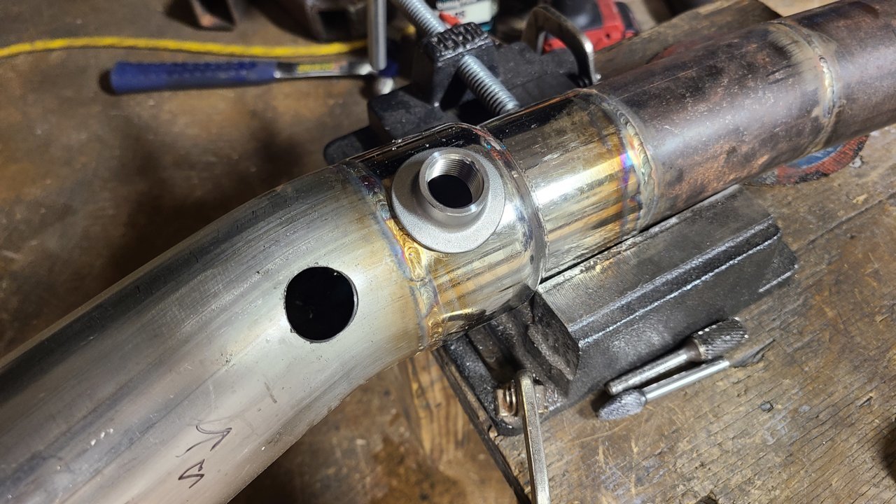

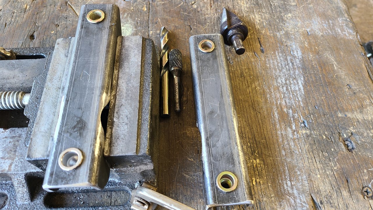

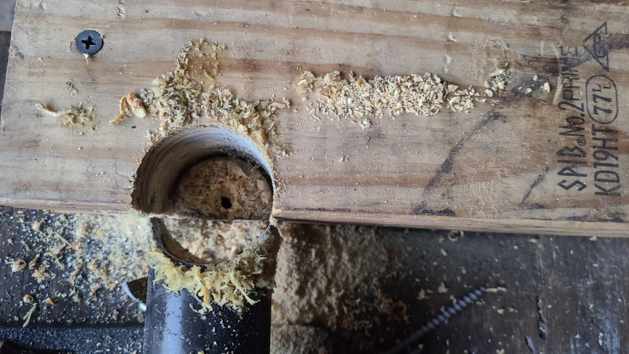

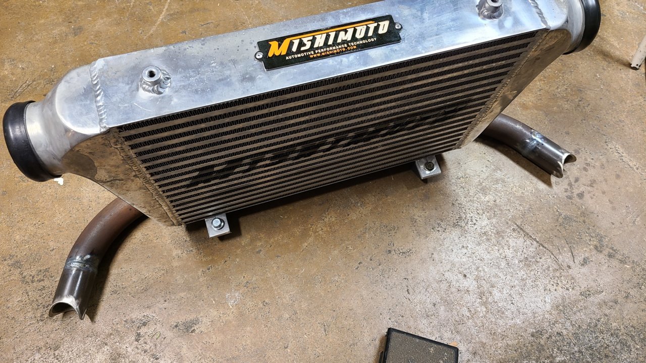

    Drew this up in PAD. Rough idea for how to mount the intercooler.

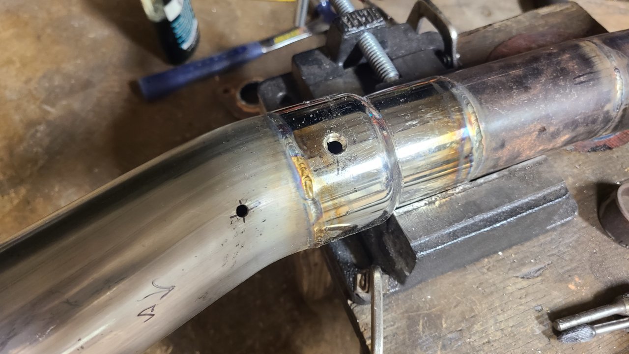

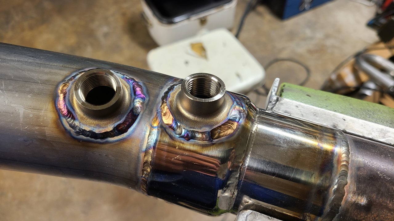

    Time to get a new step bit. The last necessary step, has a knick in it. Stainlessbros sensor bungs.

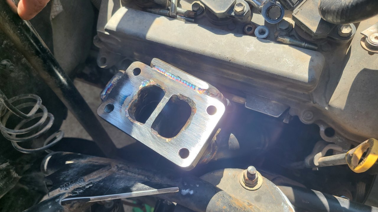

    Basically repeating what I had posted in the Turbo B.S. thread.

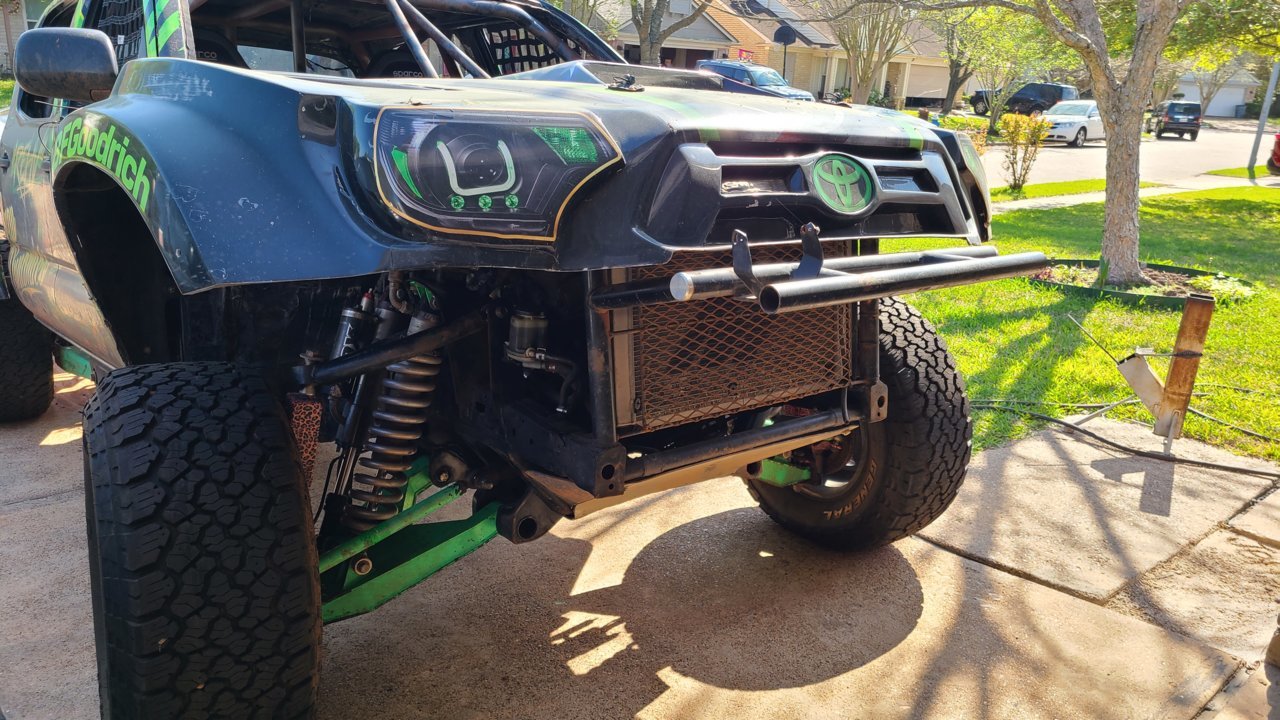

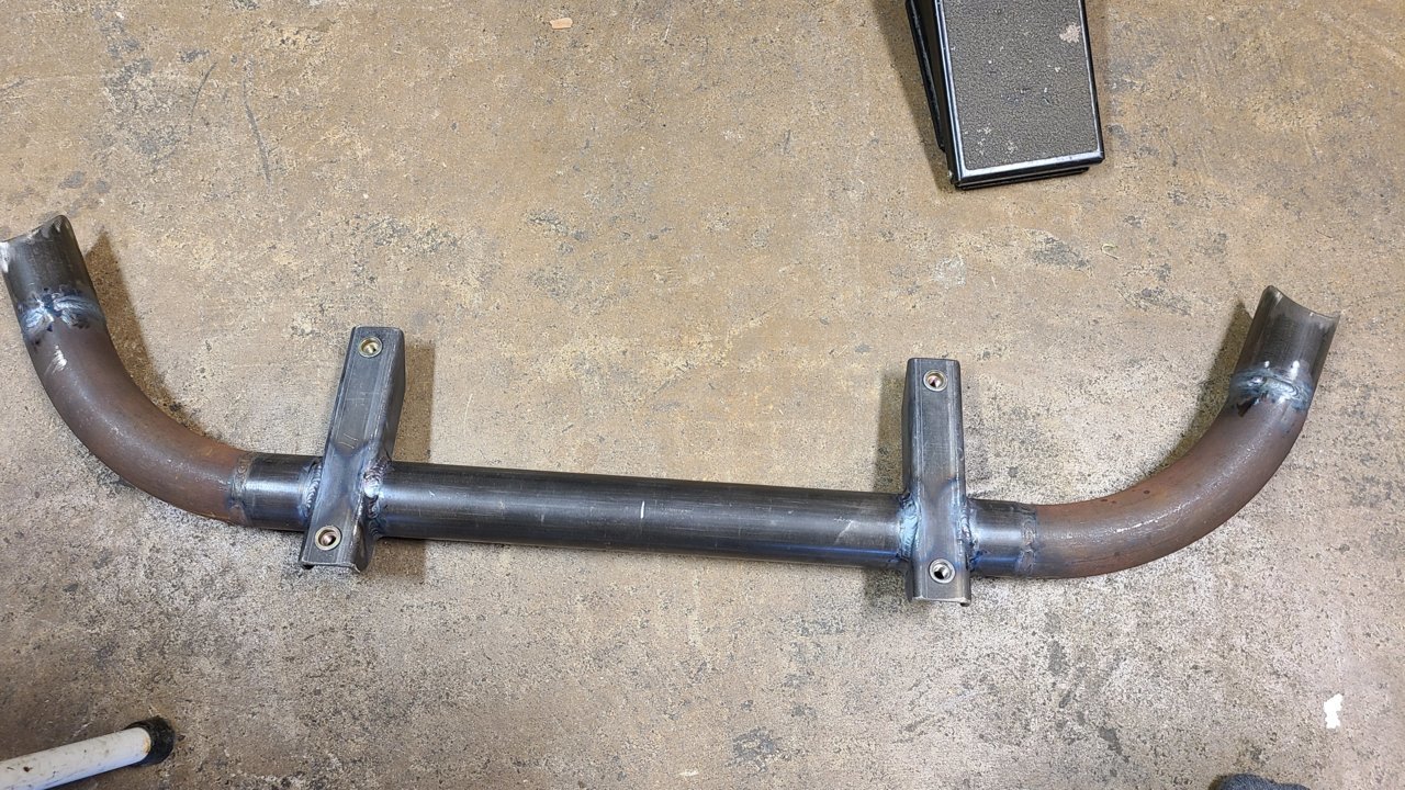

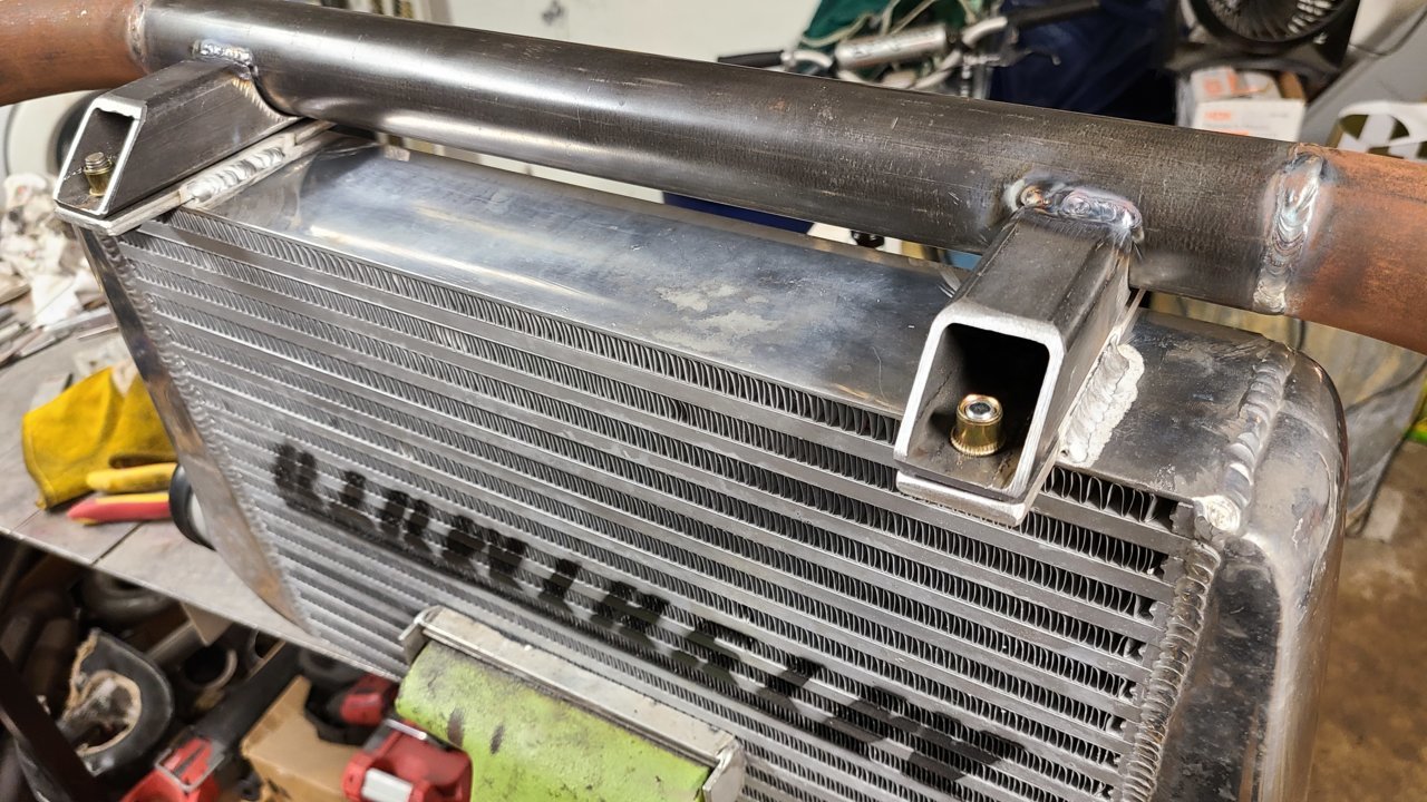

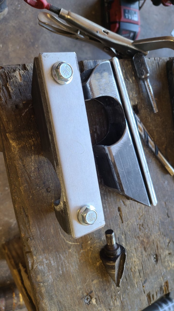

    I have only made this much progress on front intercooler support. Quite similar to the PAD design up above. One day I'll get a real tube notcher. :laugh:

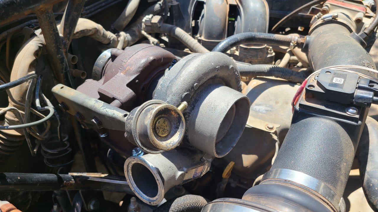

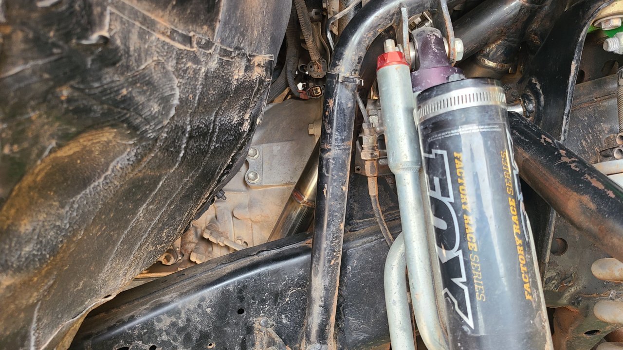

    I swapped the sensors over. Both into the down pipe. The last few starts were without the sensors plugged in. Wanted it to run in closed loop. I also let it idle up to temp. I had seen some oils in the downpipe, when welding on the bungs. Was not sure it if was from my cutting fluid, so needed to get a good amount of time idling.
    Came across this unfortunately.
    More than evident that the used turbo has a bad seal. New one is on order though.
    Been a busy week, and have not had quality time to work on it. This weekend, weather permitting, I will though. :woot: I am excited to get this intercooler support all welded together and intercooler mounted.

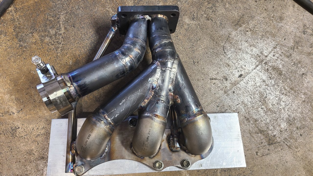

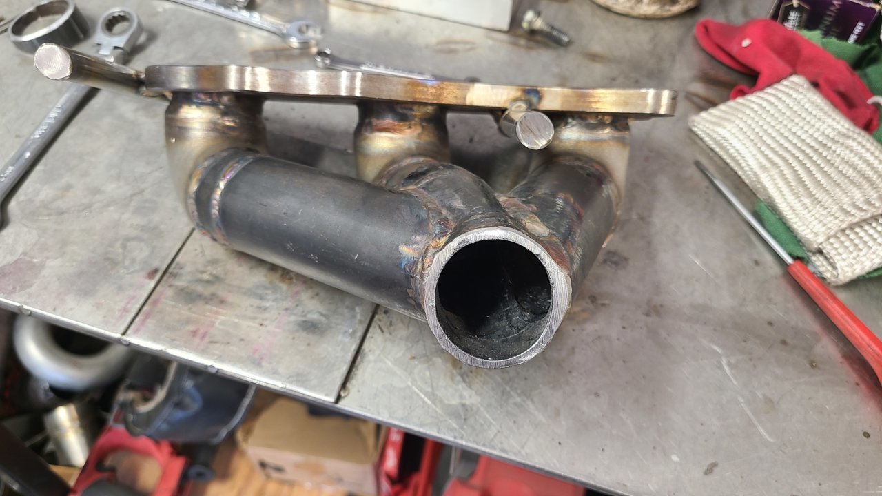

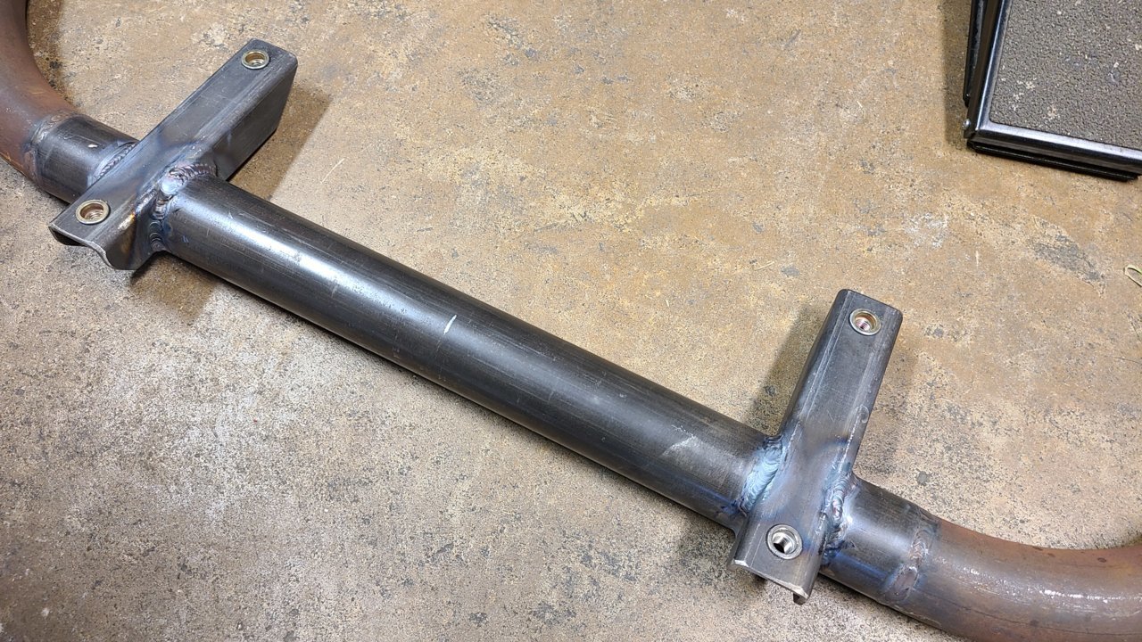

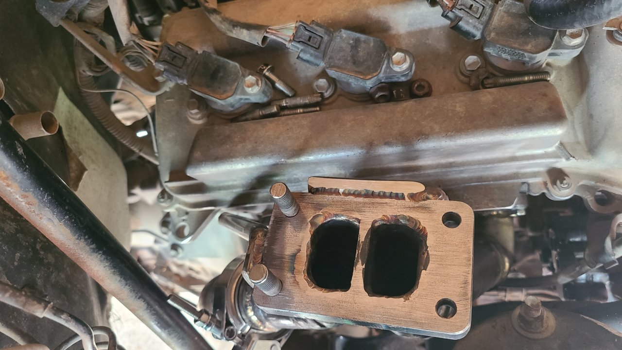

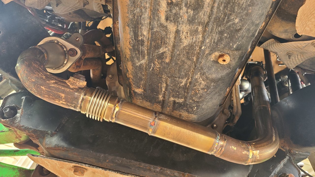

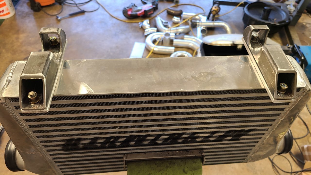

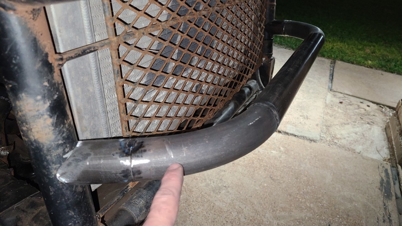

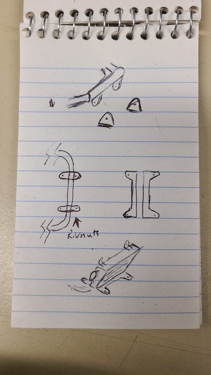

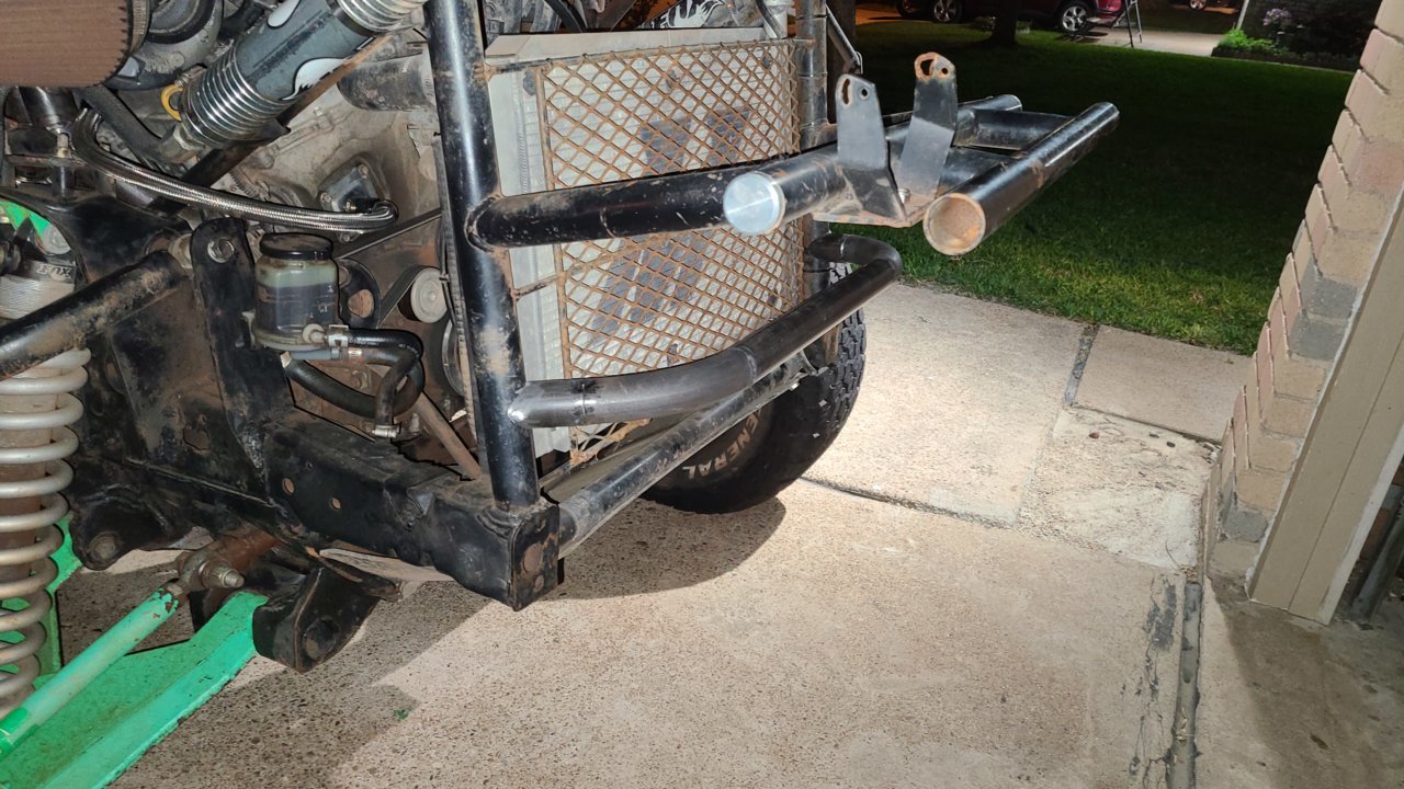

    Made a little more progress this weekend, with the short time that I had available. Can't wait to get this fused onto the cage, tonight.
    20210424_140532.jpg 20210424_160452.jpg 20210424_164556.jpg 20210424_170226.jpg 20210424_180716.jpg 20210425_194132.jpg 20210425_194138.jpg 20210425_195518.jpg 20210425_195535.jpg

    getting closer mate

    That I am. Need to make the top supports, then intake routing time. :woot:
