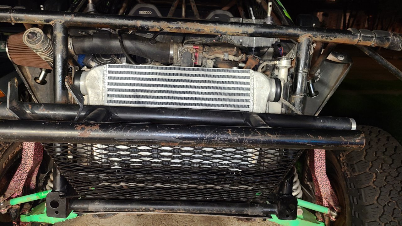

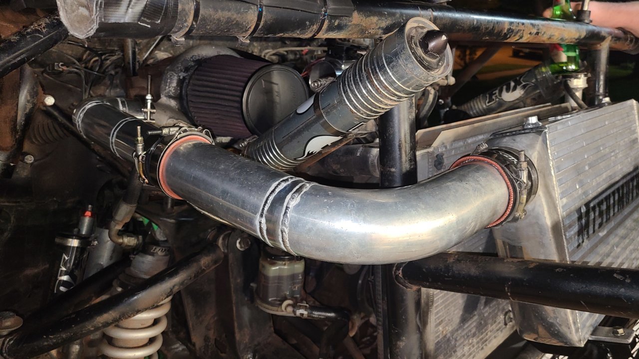

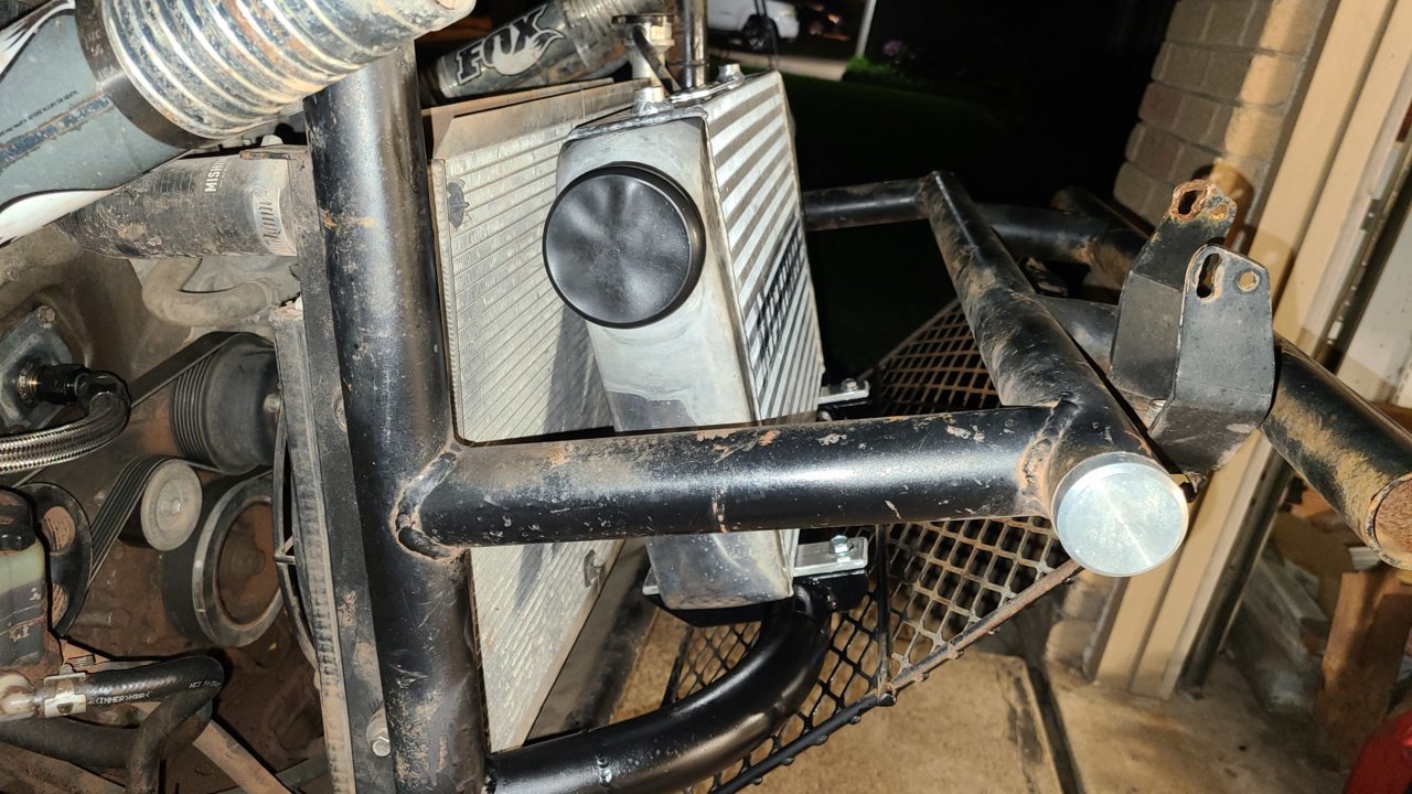

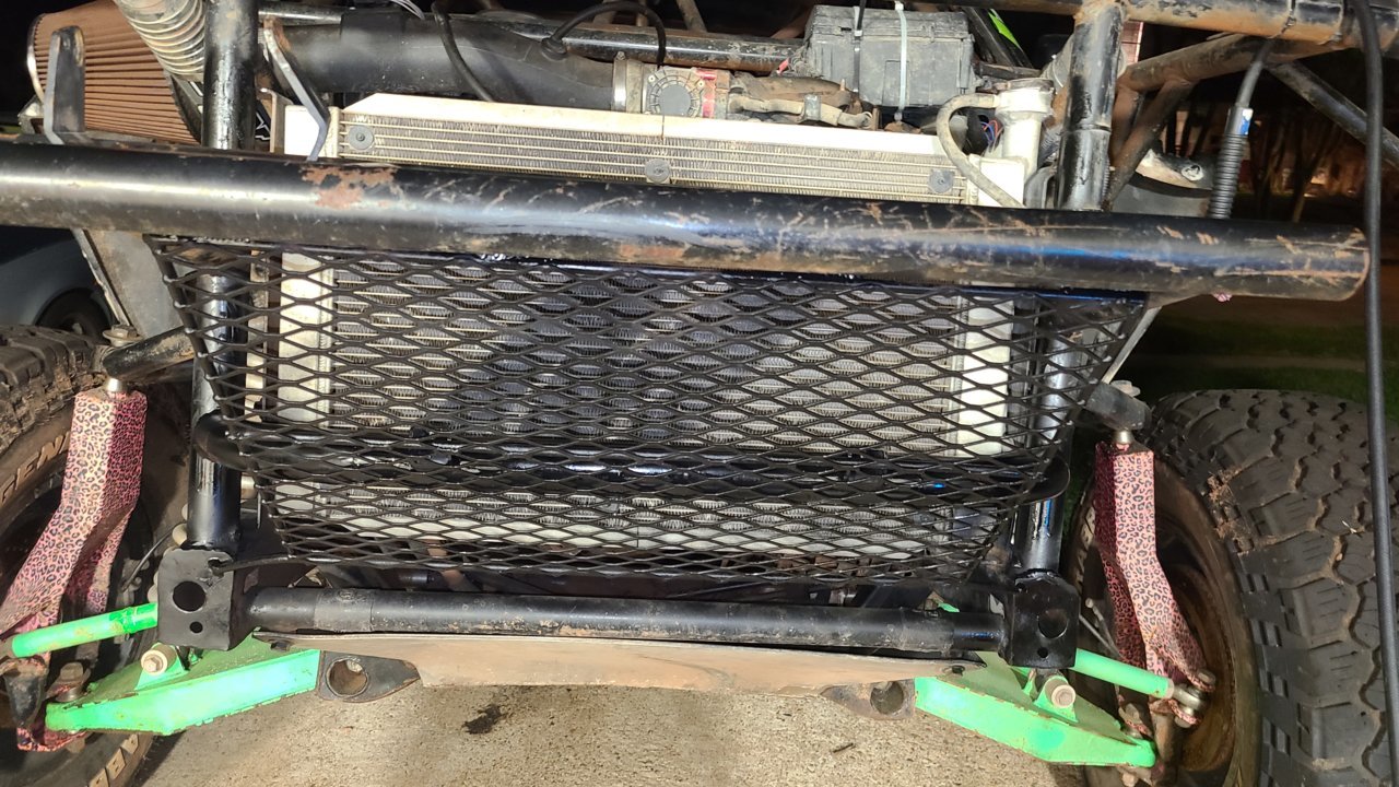

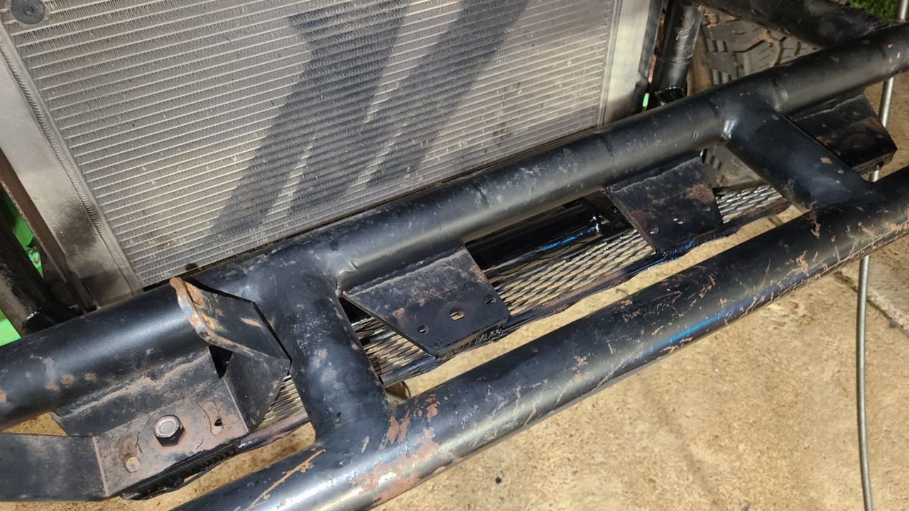

    Had just a short amount of time to get some work done. Turned out extremely well, and even added a Top Coat.
    Removed the rock guard from in front of the radiator to now protect both the intercooler and radiator. After having mounted the intercooler lower support.

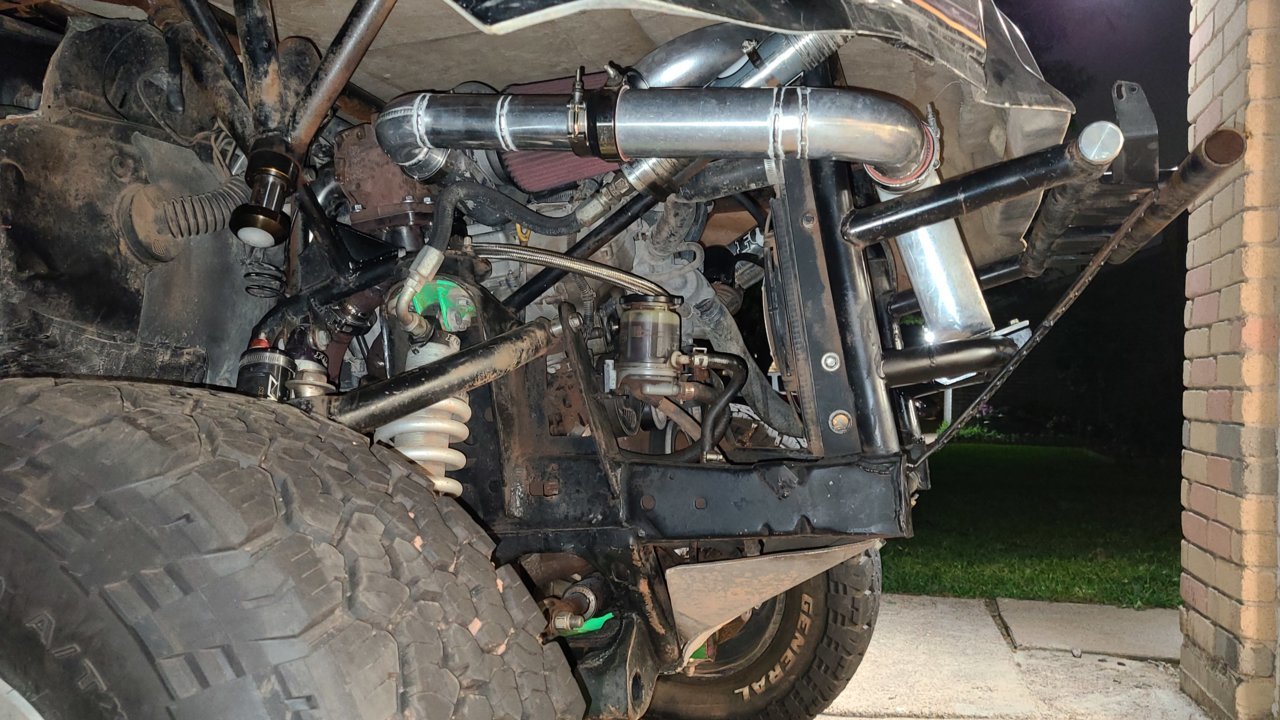

    Intercooler is intentionally routed rear-ward, to clear the hood, and have the top most portion not be blocked by the front of the hood.

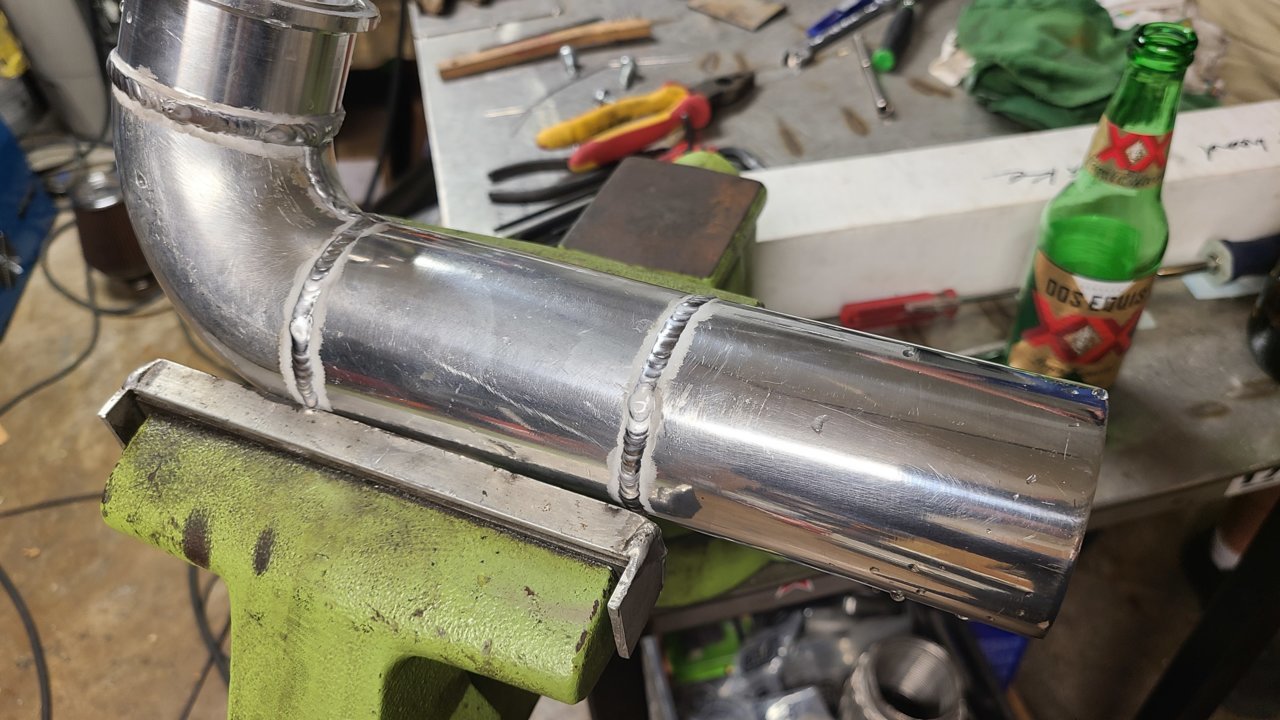

    Already planned out the intake charge tubing routing. Hoping it goes quickly tomorrow. As well as make the top intercooler supports.

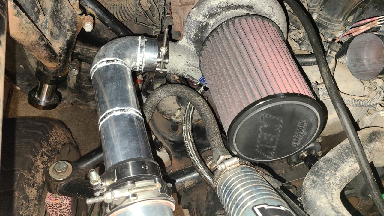

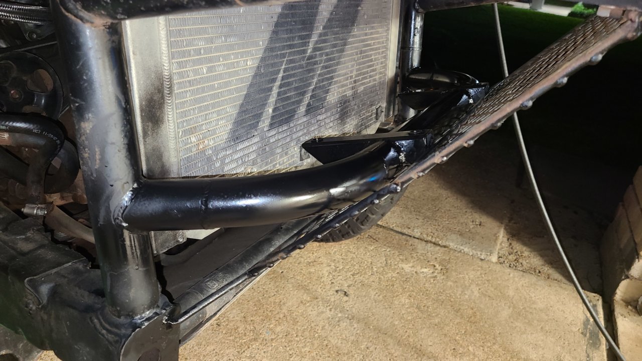

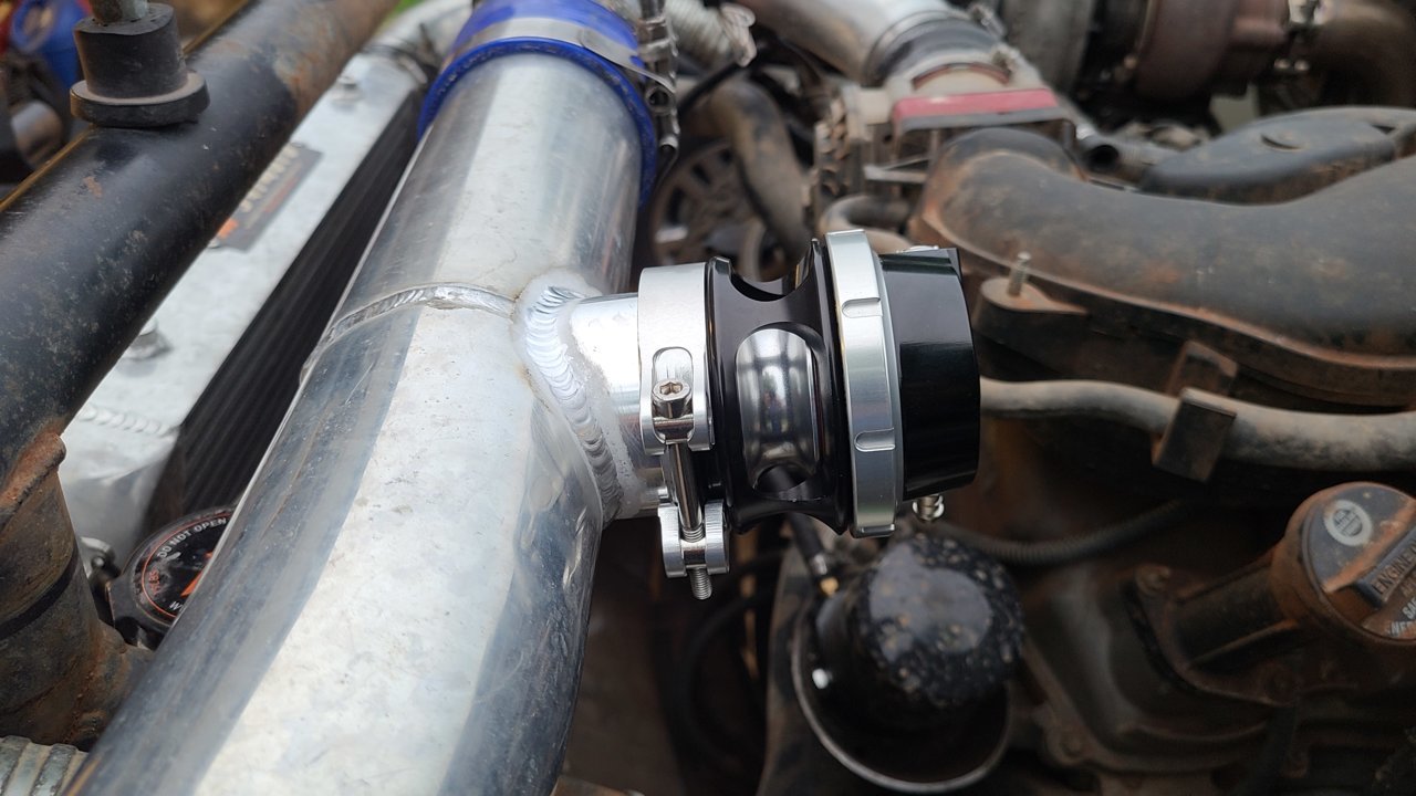

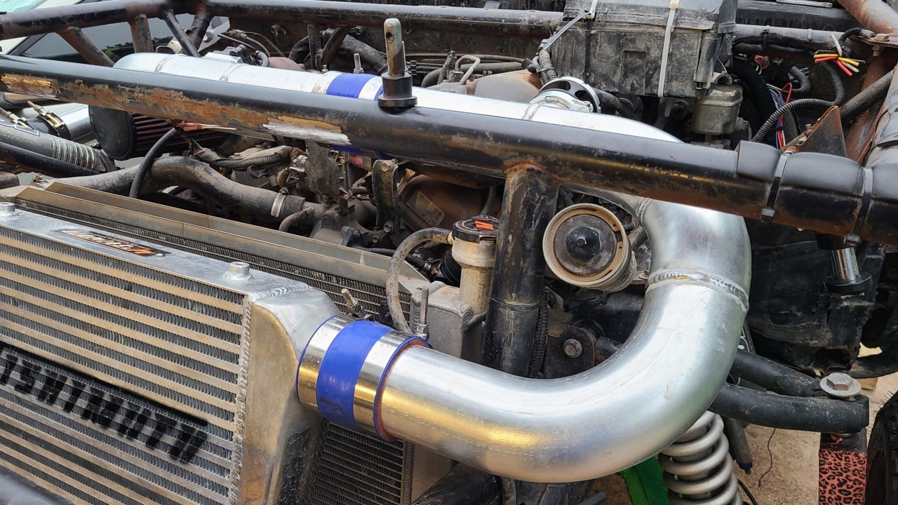

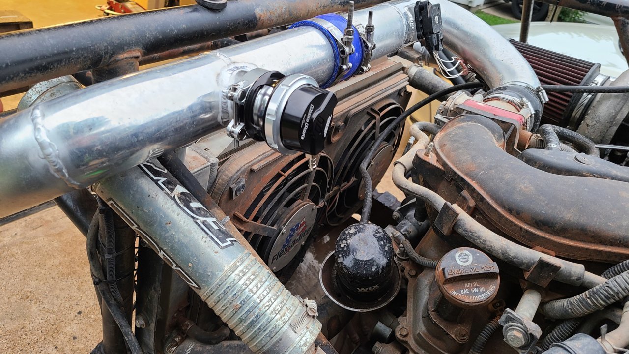

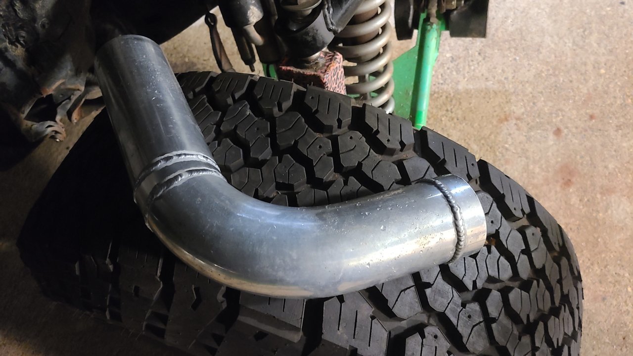

    The latest updates have been posted in the Turbo BS thread. As related to the PreRunner build.. Some changes and upgrades are under way currently. Swapped to external wastegate, on a Boostlab turbo. Turbosmart wastegate and BOV.
    Upper intercooler supports finished, to go with the last updates here.
    Cross-member repaired and some reinforcement added.
    Wastegate fused into the turbine housing.
    20210518_165148.jpg 20210518_165205.jpg 20210518_170735.jpg 20210518_170725.jpg 20210518_204209.jpg 20210518_205550.jpg
