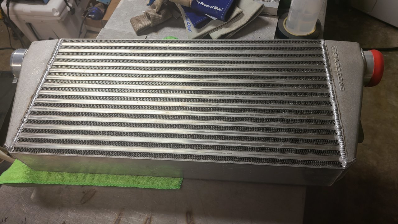

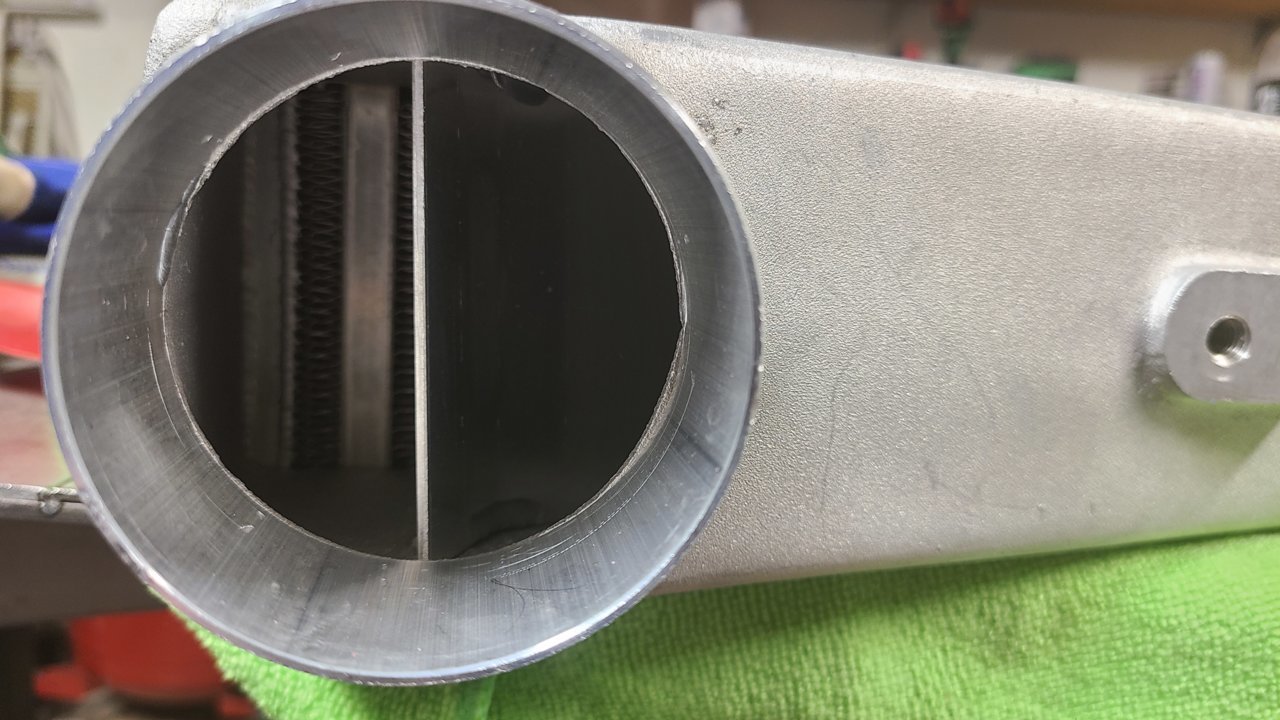

    In my latest Tacoma mod adventures. I finally got around to welding the Treadstone Performance end tanks onto my Garrett intercooler core. I was very pleased at how clean the casting of those end tanks was.
    The bottoms of the tanks were a little longer than the core, so I had to trim them and plate.
    These end tanks came with diverters welded in. A major upgrade over my current intercooler. Plus a far superior core.
    Only took something like 5 or six years to get around to this. I was hesitant until I felt confident enough in my welding skill.

    Now to test fit some time next week, and fabricated the mounting points.

    Looks good, which width core is that one?

    You know, been so long since I had to spec it out, that I have forgotten. I think it is 3.5". I'll get a measurement this afternoon.

    Thanks, I was wondering about the larger dimension. 27.5”?
    I think I may have to be flexible with the procharger cooler with all my other modifications and considering options ahead of time.
    Plus, you can’t go wrong with those garret cores.

    I'll get all three measurements for you

    3.5×12x24. :thumbsup:
